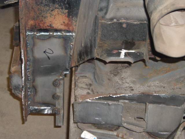

    Hi All,
    For those of you keeping up with the Merc progress, I have an updated sneak peek for you that hasn't made it to the website yet. After some digi cam woes & the flu, progress has been delayed, but I got back out in the garage today, and finished off what I needed to as far as rebuilding the inner rockers. I moved them inboard to clear the frame about 1/2 inch on each side, (there was a mere 1/4 inch clearance on both frame rails between the inner rockers and the frame) below is the result of the modifications:

    MercMan1951
    another pic...plenty of room now!

    MercMan1951
    I decided to weld the body of the Merc at the stock Lincoln chassis/floor height. I think it will come out at just the right stance for the stock suspension...bags are in the future anyways...in this shot you can see the relation of the Merc rocker/floor to the Lincoln floorpan.
