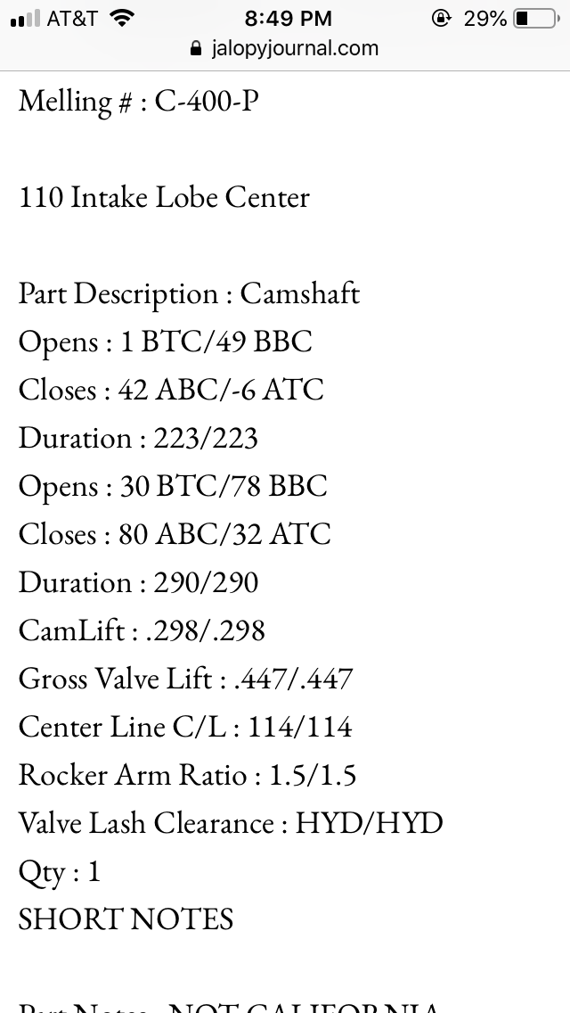

    Also what is the difference between a Melling C 400 P and the earlier L79 cams.

  3. Run the numbers on the 305 heads, they are around 76 to 82 cc, not exactly performance heads. Just looked up the 882 castings, 76 cc combustion chamber with a 1.94/1.50 valve set. You need to plug and chug what pistons, stroke, etc into a basic formula to have it puke out a compression ratio.

    L 79 cams are not all ground the same

    I don't believe the 350 heads with 2:02 will clear the edge of the cylinder walls.It is hard to figure out what is in your motor when you don't know,Fel pro heads gaskets are .039,oem are steel shim are the piston rebuilder which are down in the deck.L79 from chevy is different from crane or comp. Cams have changed alot since those were made.Roller cam would make a big difference.

    My buddy has the same cam in a 383 and it runs past 6500.What kind of fuel pressure,once again it is hard to figure out when you don't know whats in the motor
