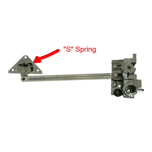

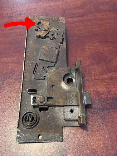

    Glad you got in ! Now I’ve got a question for you ...... the spring in my 3 window broke. So got a new spring and now sometimes when I close the door it locks itself. Got to be damn careful that I don’t have the suicide latch unhooked on the passenger side or I’m hooped ! Can’t figure out what is happening ?. Have had it apart and all seems ok .

    You might have a problem with excessive wear in part of the latch itself, Dave Doolin has rebuilt several latches for me, does the pivot where the inside door handle attaches to the inside of the door still have the small "S" spring?
    I'm not saying that is the problem but it was on my old coupe. HRP

    Thanks I’ll check that , something I hadn’t thought of ‼️

    Just saw your pic but a 3 window latch is completely different , thanks for your efforts !

    I just grabbed a image from the internet not knowing you had a 3 window, but the 3 window does indeed have a "S" spring, this spring keeps the door handle in the correct position. HRP

    I have missed that , that could be the problem .... I’ll let you know
