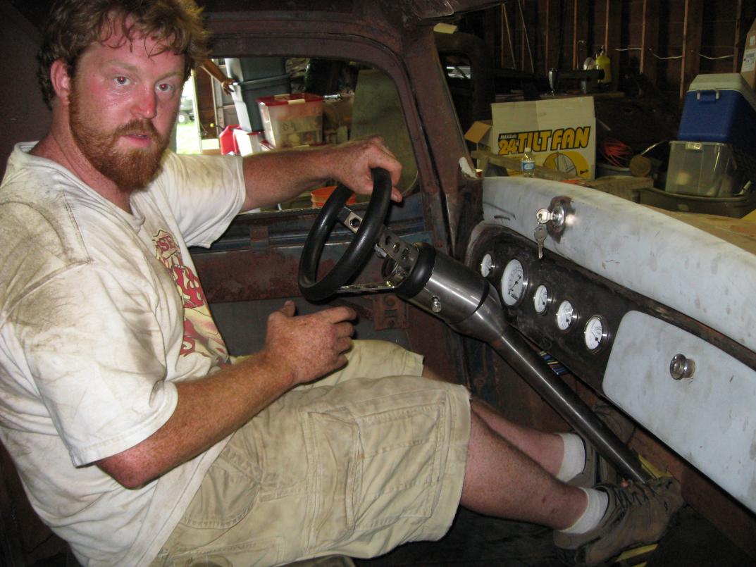

    well, boys i thought i'd stick a few pics up here to whet you whistles. i really wanted to have this truck done for the hamb drags this year but i just didn't have time. although i don't think i'm doing bad for a firsttimer working by himself 90% of the time. big thanks to 53sled on helping with the channeling. neither of us had ever done it before but we figured it couldn't be that hard plus we'd both read how to do it. the same goes for the frame, suspension and everything else except that was on my own. it looks just like what i wanted all i need to do is finish it.
    let's see what we'vegot here...
    1. the finished roller
    2. a side view notice the blower and radiator in the bed to better facilitate the real drag car feel with no cooling system(or at least one that's kinds hidden)
    3. smoothed and revamped original dash i love the tiny deepdish steering wheel

  5. I'm stunned at how good that truck looks! Words escape me! LOL!
    Seriously, I like that rig! What rear axle and suspension are you using? Ford/4-link?
    Are you putting a bed on it, or leaving it as-is? Nice work!

    ten bolt from a 72 chevelle with 4.88 gears and a spool
    the rear suspension is a pete and jakes ladderbar kit with a posies 32 ford rear spring
    i think ill eventually build a bed for it but i'd really rather just have it on the road
    asap
