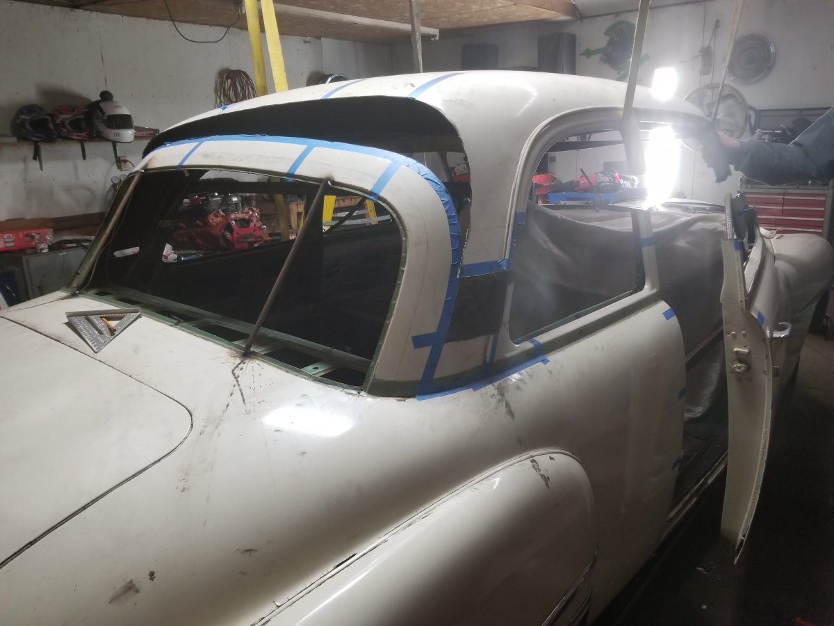

    The thing I'll be watching is how the trim under the rear window lays after the chop... it stands straight up before-hand. With the rear of the top leaned forward, the trim may have to be modified to fit flat against the new angle. Time will tell...

    You are correct about that Jacksmith. My window on the Dodge is more upright then most chops and most likely I will need to make that belt trim if I want to use it. Which also means making the rest of the belt trim as well lol. The joys of building a custom. Change one thing. Change it all

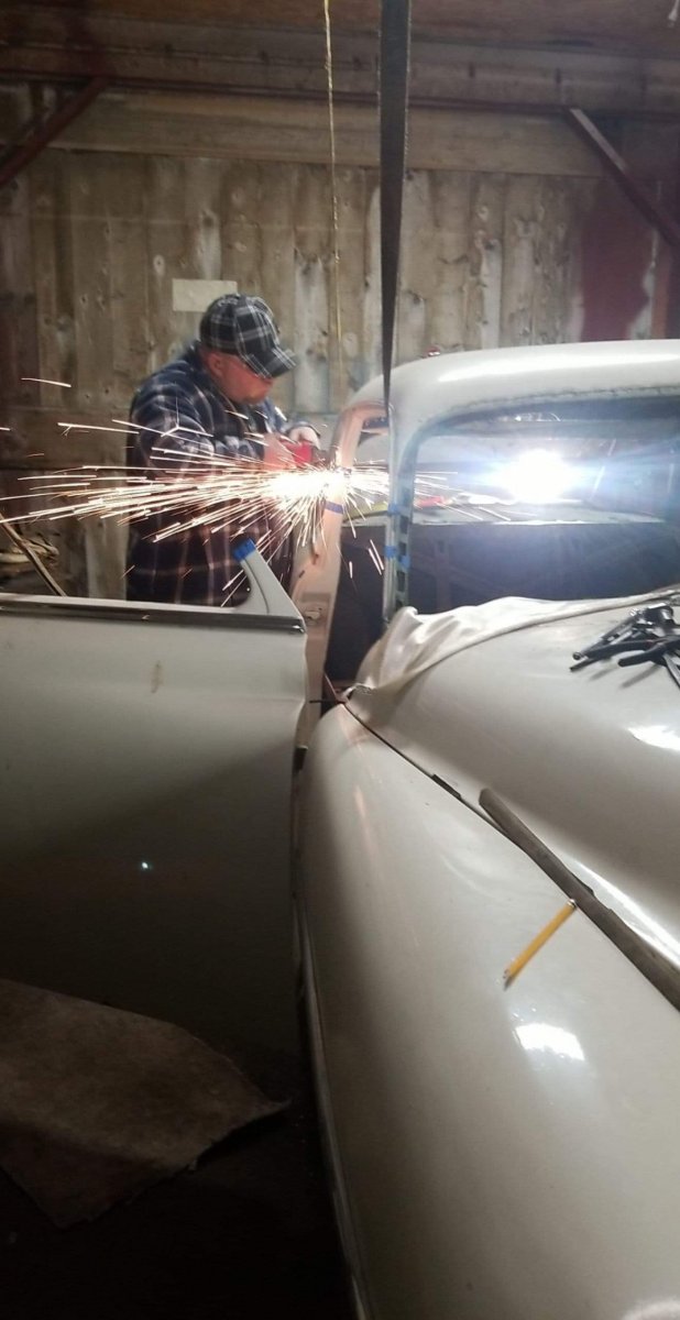

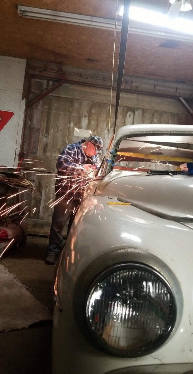

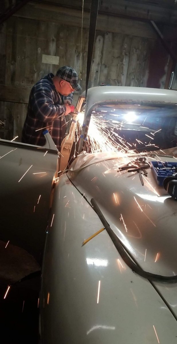

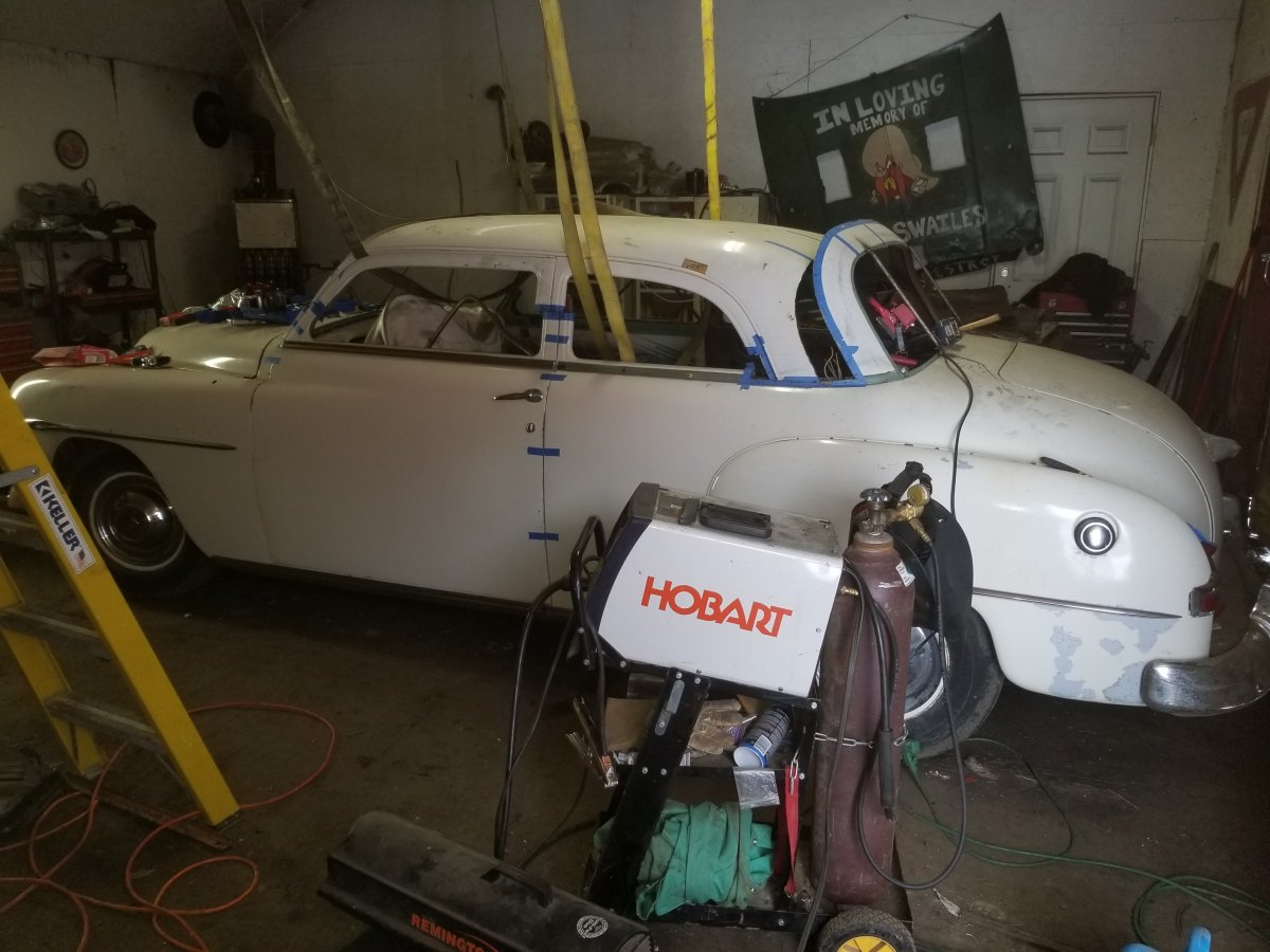

    Some progress pics. I'm done for the night though and will be taking the 3 inches out in the morning.

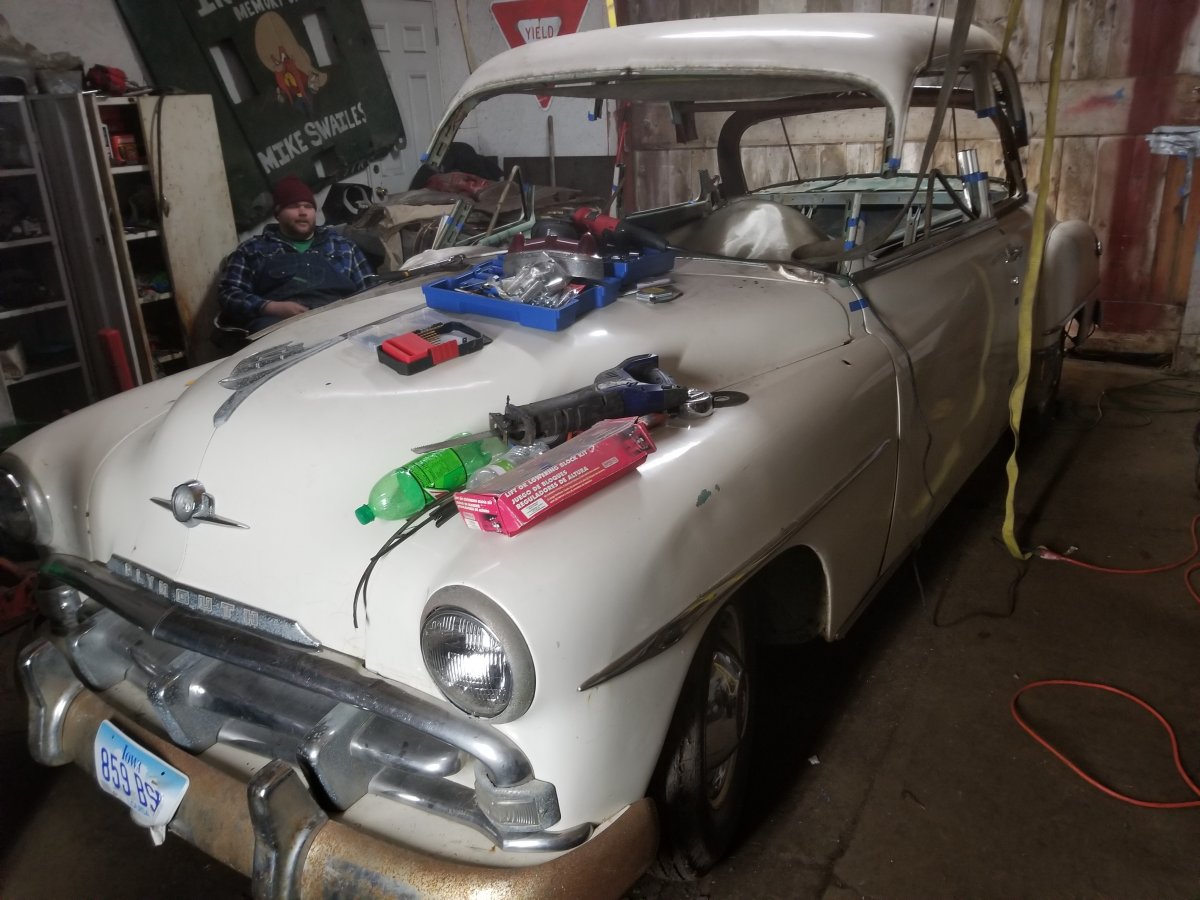

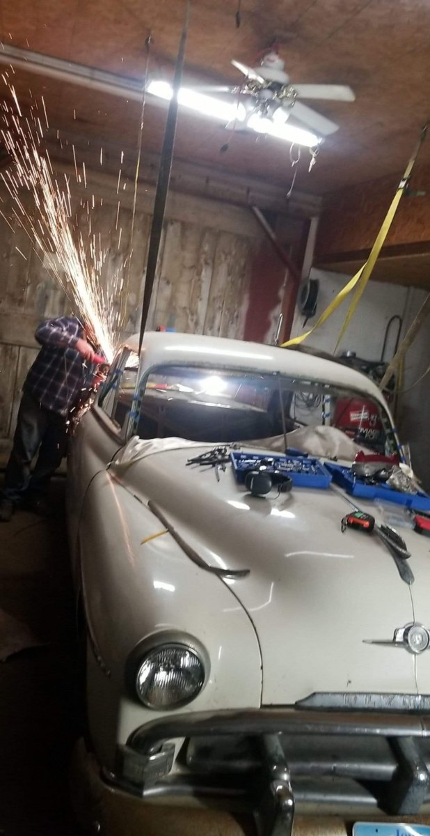

    Me in action silently wanting to shit my pants as I am over my head lol

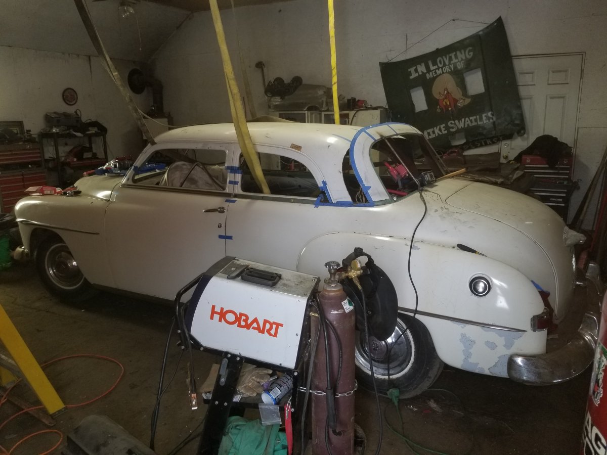

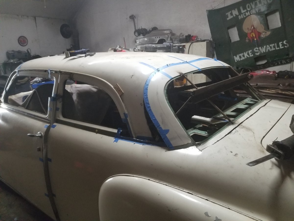

    Some teaser pics with the roof back down. Also one with the visor back on.

  8. KandN Kustoms
    Joined: Dec 15, 2008
    Posts: 475
    KandN Kustoms
    Yep, I'd be silently having a panic attack too!
    No worries though, I'm sure you'll work through it.
    Just do it the same way you eat an elephant, one bite at a time.
    Good luck!
    Sent from my SM-G960U using The H.A.M.B. mobile app
    Mopar Tony and Stogy like this.
  9. straykatkustoms
    Joined: Oct 30, 2001
    Posts: 26,819
    straykatkustoms
    Very kool! It looks like ya guys cut just enough off. Very Classy, ya got my attention.

  10. Jacksmith
    Joined: Sep 24, 2009
    Posts: 1,819
    Jacksmith
    from Aridzona
    Ahhh... the infamous "point of no return"...

    Thank you sir being my first chop I am still trying to work things out. Do you think that it is enough off or should it go more? I kind of like it as is, to me it is enough to improve the looks without going out of proportion.
    Oh yes, I hacked it up so now I have to fix it LOL

    I wouldn't take any more off the top. Profile look purrfect.

    Thank you sir I was thinking the same thing. Now I'll start squaring it up and welding it back on.

    That 3" looks right to these old eyes!

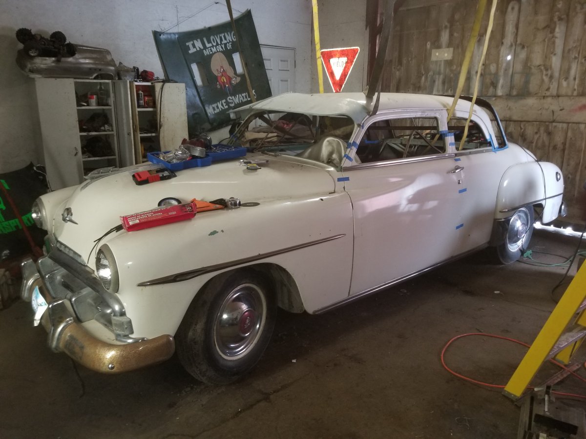

    Made some progress today on the Plymouth. Not perfect and a ways to go but I think it is looking good.

  22. Brand Apart
    Joined: Jan 22, 2011
    Posts: 813
    Brand Apart
    from Roswell GA
    Looking good is right!
