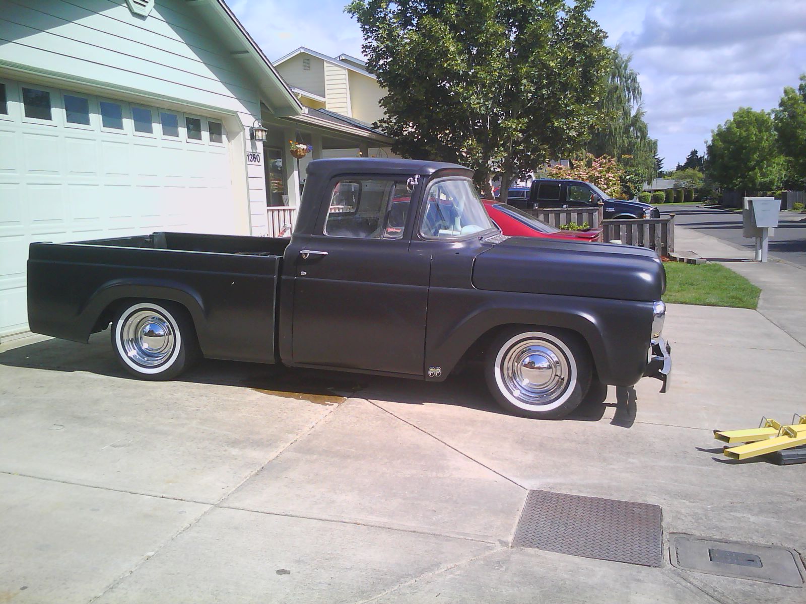

    how did you get yours so low? I just got a 58 and am working on getting the right stance for it. any picks and tips would be great! truck looks sick by the way and props on all the work. keep it up :)
  2. 53olds
    Joined: Sep 7, 2008
    Posts: 2,889
    53olds
    Its got a volare clip up front and a flipped rear axle and cnotch.
    Check out my first build thread on the first post of this thread.

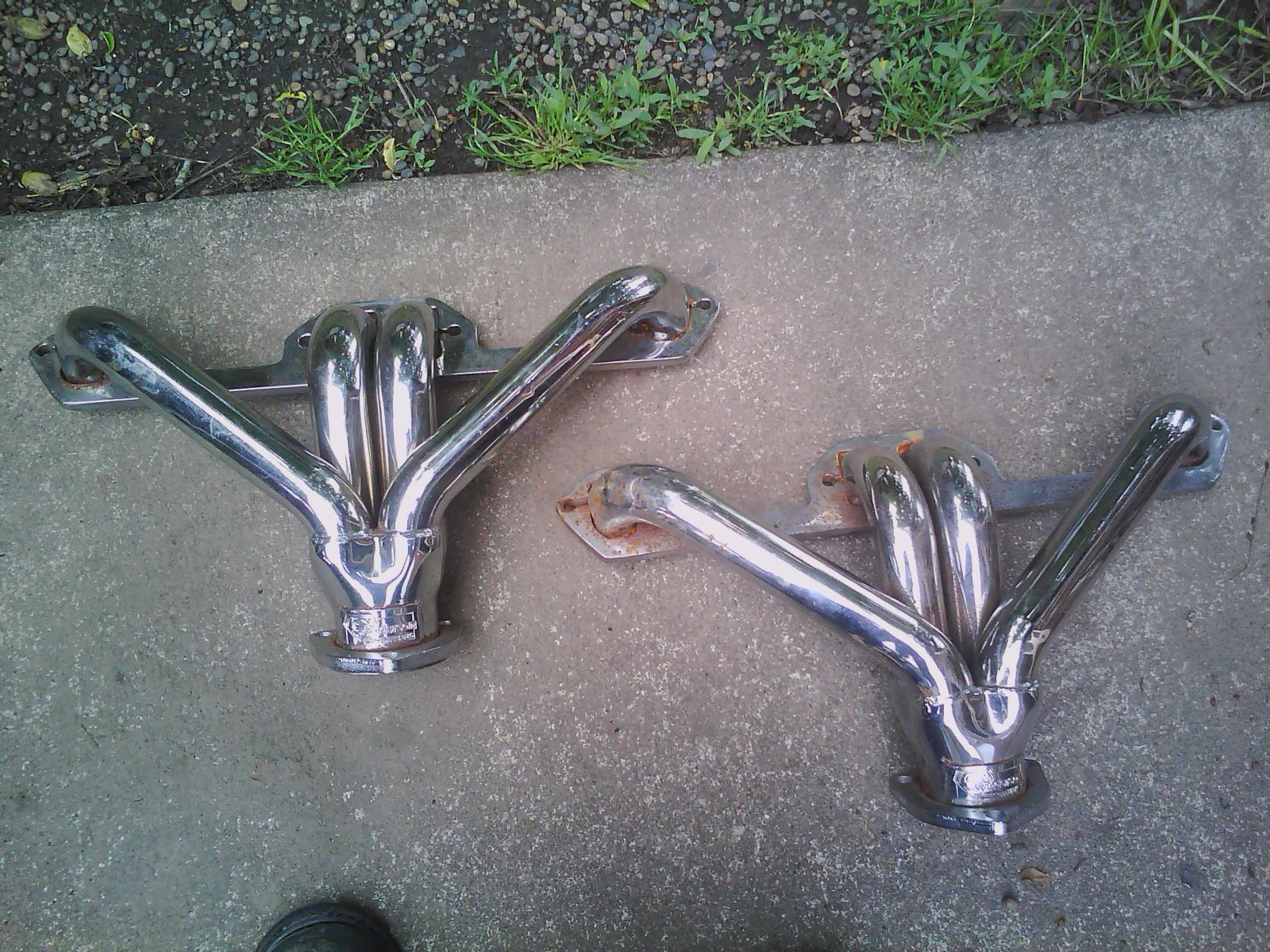

    Got these shorty sanderson headers today, need a little cleaning. The long tubes or cast iron stockers wouldn't cut it!
  13. OahuEli
    Joined: Dec 27, 2008
    Posts: 5,243
    OahuEli
    from Hawaii
    Good score! Those small block Mopars sound good with headers.

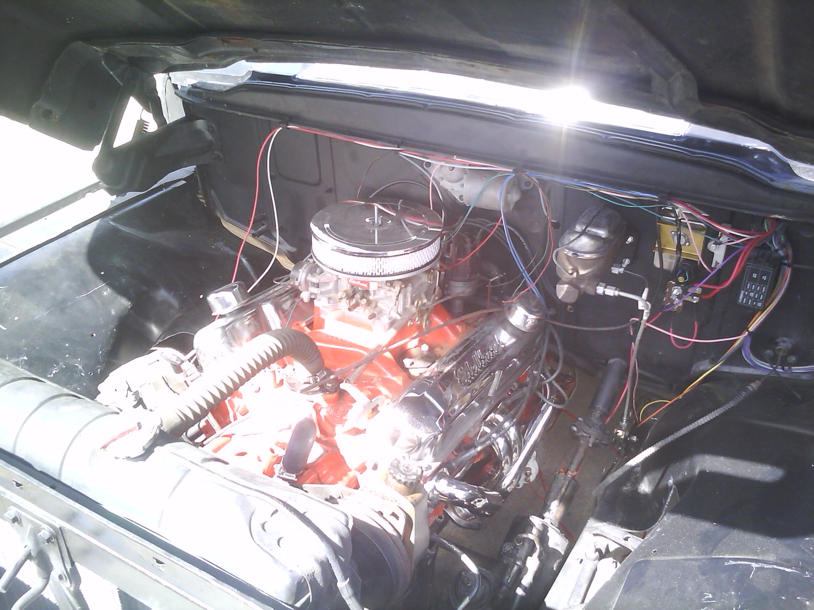

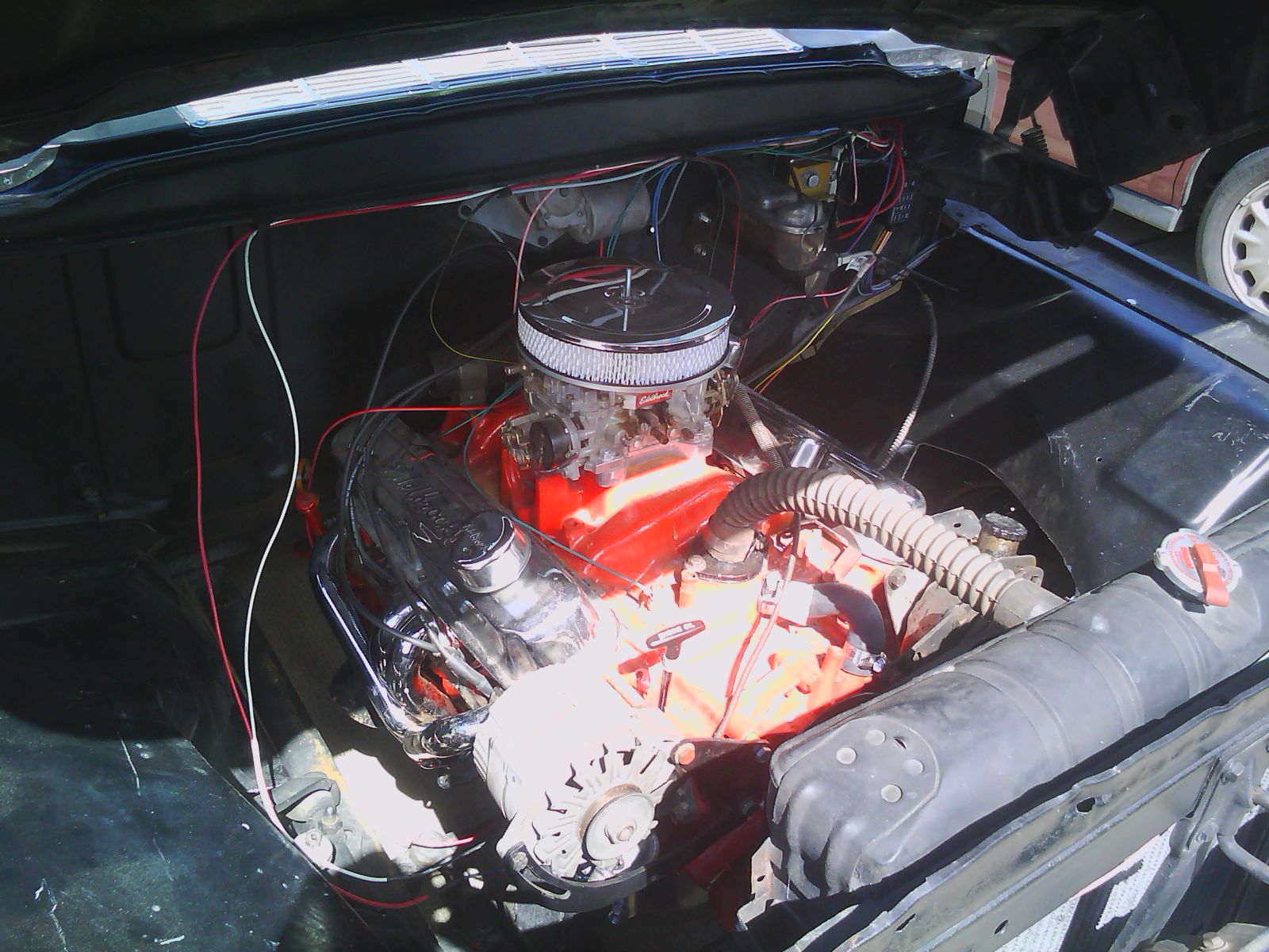

    So yesterday Keeth and I went to Brooks and I bought $127 worth of parts, everything I needed. We got my exhaust made and installed, all my fuel lines and other hoses, got antifreeze in radiator, ATF in but I have a small leak around the shifter gasket, then I got $8 worth of gas and poured that in. I also got a battery for free. We had some wiring problems and it turned out to be my voltage gauge, it wasn't letting current through, so we by-p***ed it and it turned over. My timing was way off and it backfired and blew the carb off! I have an adapter on it with a cheap bolt kit, which the hex head bolts weren't long enough, it only had one thread in the intake. So we fixed the timing and started it and it had a big cough but it was 11 at night so we didn't try and keep it going. So today I gotta get another carb gasket and some longer hex head bolts.
  18. 53olds
    Joined: Sep 7, 2008
    Posts: 2,889
    53olds
    Had a few minor issues today but we got the truck fired up and drove it around the block about ten times. it sounds bad *** straight piped and we believe it has a mild RV cam in it. My girlfriend got some good videos which she is uploading but I'm gonna try and get them on youtube tomorrow.
