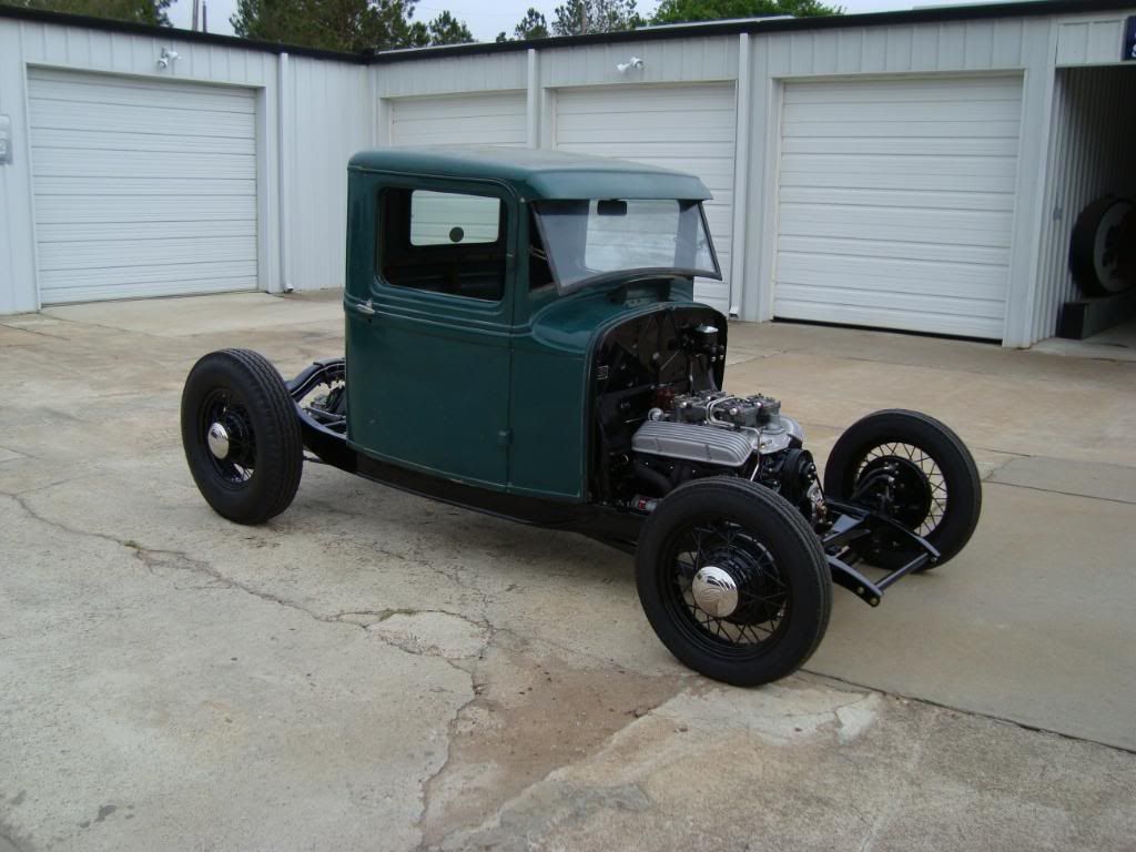

    well the progress on the truck has been fairly good.other than some small details,the chassis is done.yesterday we put the body on and got it all buttoned up.next on the list is the wiring and some paint work on the gas tank,column and bed.see ya'll at the round up.

    Beautiful chassis. What alternator and bracket are you using? I am having trouble getting an alternator to fit down low without it bumping into the vega box on my '32 rpu.

    great stance looks to be a jap car alt

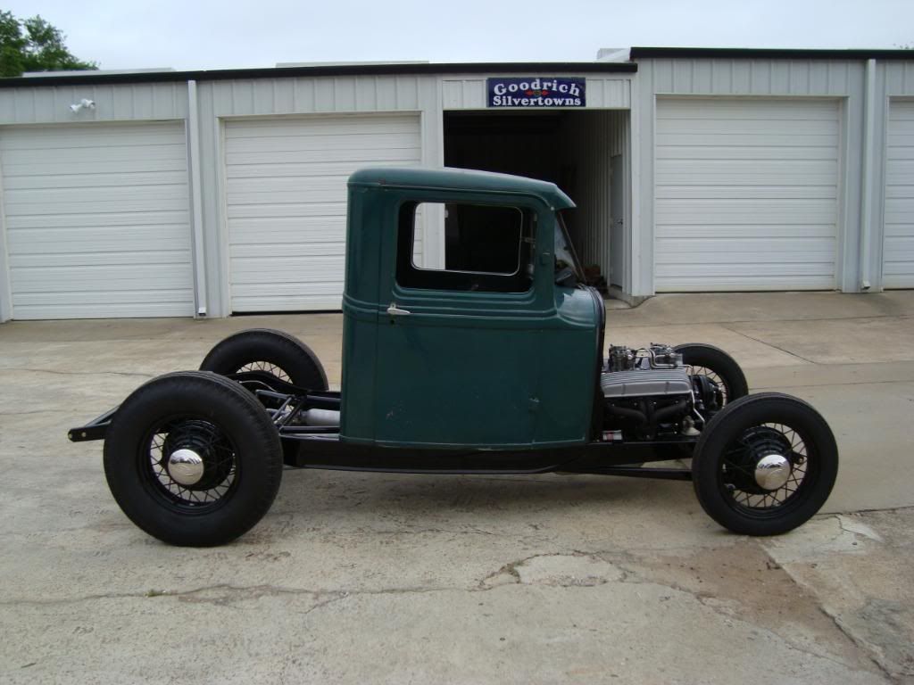

    Just curious, why does the exhaust system not run all the way to the back of the frame?

    no gas tank on the back of the frame,and the bed is another foot after that,so i didn't want the exhaust to be out in the air with nothing around it.

    the alt. is one from an 84-86 honda civic,and the bracket is one i make.they even fit in a 32 frame that is pinched 5/8" per side at the crossmember.
