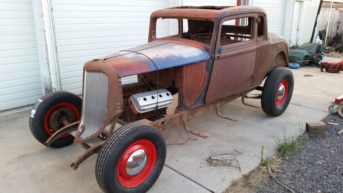

    I have been wanting a 33-34 Dodge or Plymouth since I was 9 years old. I am real close to 62 now so last year I decided if I was gonna get one built I had better hurry up. It had to be fenderless and old school 1959/1960 era influenced. My original thought was a 340 small block since I have several and the run like crazy. Was thinking 727 automatic. That conflicted with the old hot rod thinking. The guy I bought the 33 Plymouth body said " What you need is one of my old Hemis for that!" OK, new direction. Well, that fell through entirely. Now I got the Hemi bug and decided to find one myself. Bought a 1953 Chrysler 331 extended bell Hemi. Not the best choice but price was right and they look like a 392 except for the ext. bell.
    I bought a couple of adapters from HAMBers and fleabay. 1 is a ext bell to LaSalle. The other is to Flathead Ford. Then Flathead to an all syncro Ford 3 spd. I had decided it had to be a stick shift. Ended up buying 3 LaSalle trannies at the Portland Swap meet.
    I bought chrome valve covers, headers, 426 ****** boot type plug wires, gaskets, etc online.
    Found and bought a 1954 only 4bbl intake and carb, and before I could pick that one up, bought a second 1954 4bbl intake.
    Picked up a 1934 Dodge sedan frame south of Las Vegas. Cut the front of the frame off with the independent front suspension. Spliced on front frame rails from a 1937 Dodge pickup. Fish plated them, and boxed the frame from the x member to the 2" drop Model A type front crossmember. Got a reverse eye front spring. Bought hairpin weld on brackets from Speedway and welded them to a 1938 Dodge car tube axle. I had bought a pair of hairpins at the Spokane swap meet a few years ago. I was making my 2nd or 3rd p*** through the meet and noticed these. The fellow said I needed those! I didn't have a need at the time but asked how much? He said, "We want to buy 2 ice cream cones so 6 bucks!" With that story and the ridiculous price I had to buy them. Now I have a need.
    Ok, so now I am mounting a steering box bracket and u joints etc and not alot of room around the header so I take it off. Then I felt rather sick. There is a 3" freeze crack that I completely missed seeing earlier! I checked out the other side and it is 6-8 inches cracked. I am 99% sure the rodder that sold me the engine didn't see them either. Just not that kinda guy.
    So, on to CL I go looking for another engine or block. Found a 51 331 150 miles away. Made arrangements to meet him Sunday between 11-12. I start calling him about 45 mins out. Instantly goes to voice mail over and over. Sent him texts, got to his house, engines were sitting there with all ports full of water and the second engine without heads had these nasty corroded things that used to be pistons. He wanted $1100.00 for them. I waited quite a while, then left to do other things. At 5pm I get a text saying he unexpectedly had to leave and if I wanted to go back I could load them myself with his picker and take them for free. I was nearly home by then and decided even free was too much for another 300+ mile trip.
    I did pick up a 68 Charger rear end yesterday and moved the spring pads and got that mounted. Just the right width with the 1940 Plymouth 16" wheels. I tried an A body rear end but it was a little too narrow. Would of been fine with big reversed wheels though.
    So, I am still in search of a replacement Hemi. Anyone not to far away have any?
    I will post some earlier pics, a couple of which I have posted previously.
    This body had been hit in the right rear so I put in a replacement quarter.

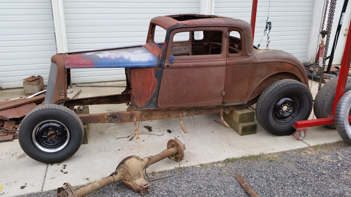

    Ok, these pics are a little out of order but you get the idea. See the crumpled rear? Had it sitting on a 25 DB frame for mock up before I got the 34 frame. Trying out different tire/wheels sizes. Here are a few different wheels, and my 4 year old Grand Son. He thinks all my cars are his! He knows which are which and notices every new one I drag home! And no, there is no problem with his legs or feet! My friend asked me that. He was just standing that way for some reason. I didn't ask him to pose, he just jumped in the picture. Not the 1st time either. Does that at car shows and cruise ins too!

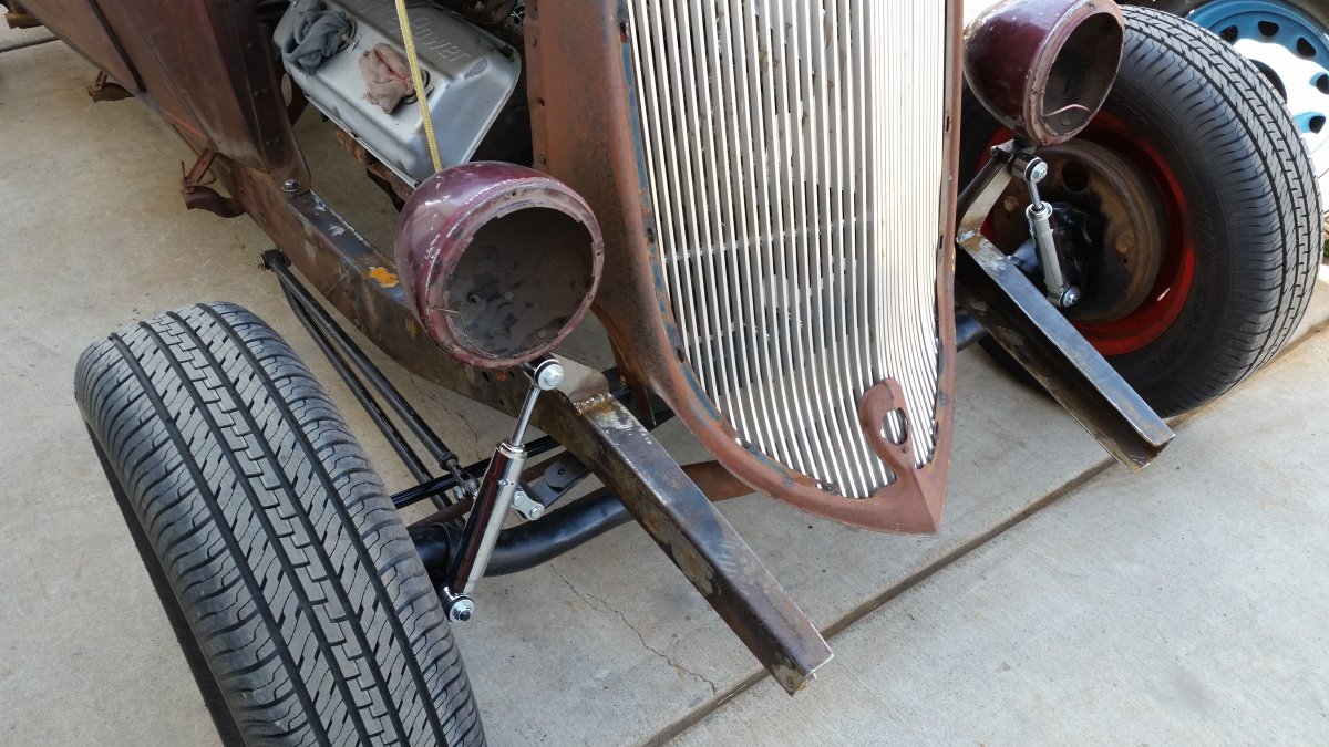

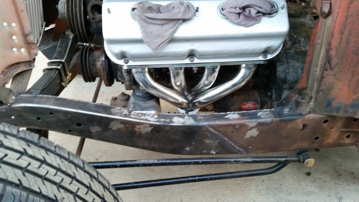

    Here are some with the new frame under it and the motor mounts installed
    Frame horns will be trimmed when I decide if I want a V spreader bar or what. Tacked some headlight mounts on top of the shock mounts. Going to run these old painted buckets.

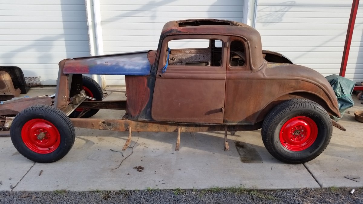

    BTW, I plan on this '33 being Satin Black. I liked the black wheels with the rust colored body but I think I will prefer the red wheels with black body. Don't know if it will ever really be straight enough for shiny paint but that is just fine with me. Satin Black covers a lot of sins and wild times!
