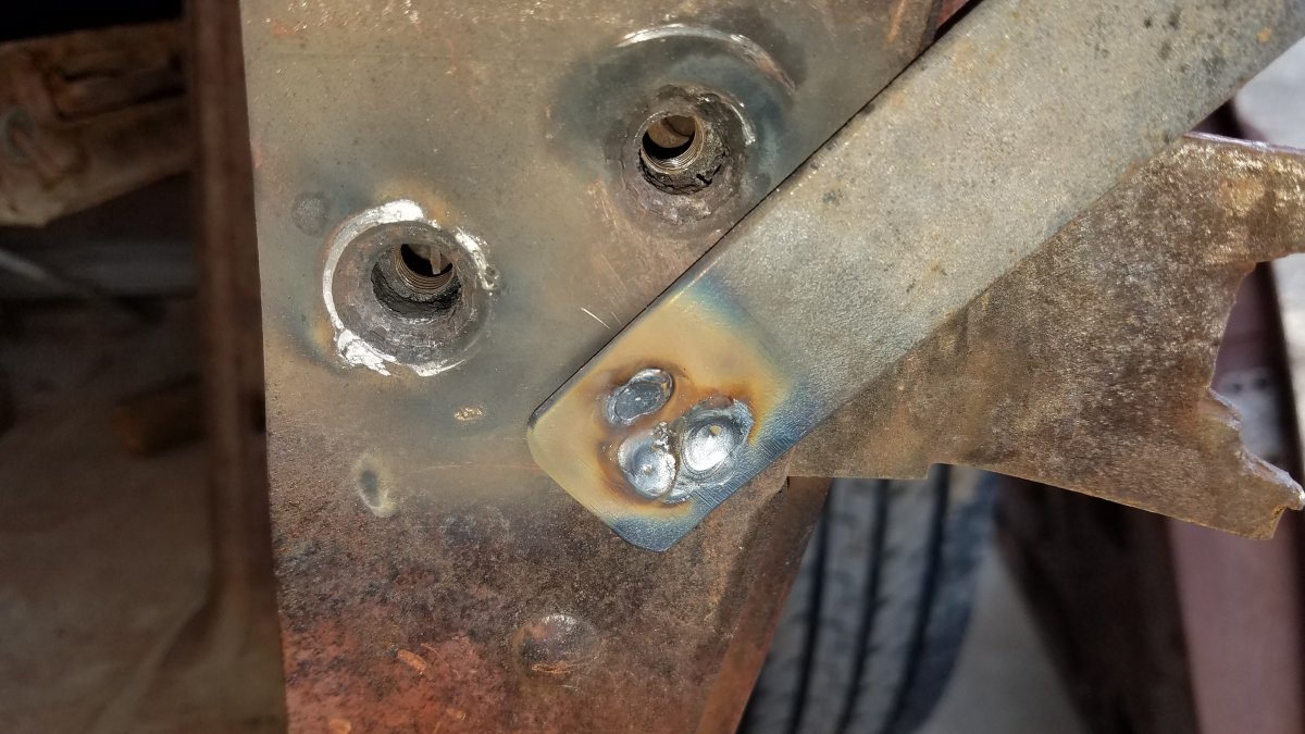

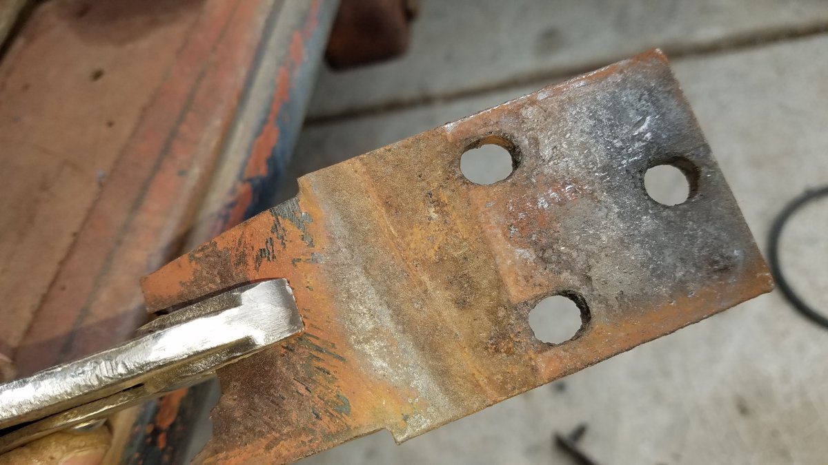

    Did some more work on the '33 today. Was finally able to get the drivers side broken lower door hinge removed. Ended up welding a flat bar with a hole drilled in the end to the straight slot counter sunk screws as I was unable to get them out any other way. This actually worked well, but of course I now need new screws!
    20190325_144731.jpg 20190325_144943.jpg 20190325_145047.jpg 20190325_145148.jpg 20190325_145159.jpg 20190325_172808.jpg
    Also got the correct engine mounted portion of the motor mounts installed on this engine. They fit as they should.

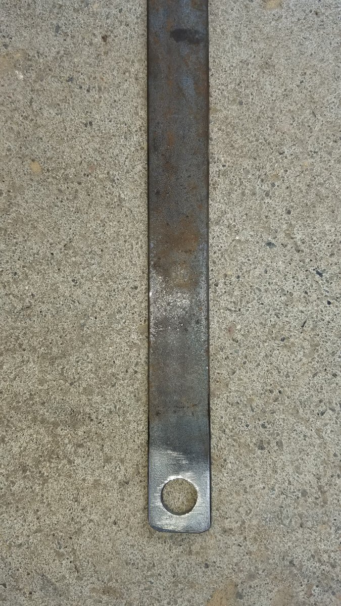

    Clutch is going to be manual! I welded some bar stock onto the original short clutch arm off the pedal shaft, pointing down instead of up. That puts it in line with the clutch fork. I think it will work fine.

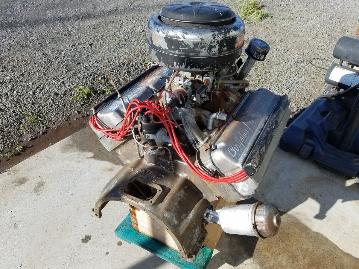

    Here are some engine pics mostly cleaned up and the pilot bushing installed. Tempted to paint the Hemi back silver but will probably stick with the red theme with black body.
    Dave 20190521_180637.jpg 20190521_180658.jpg 20190521_180708.jpg 20190521_180717.jpg
