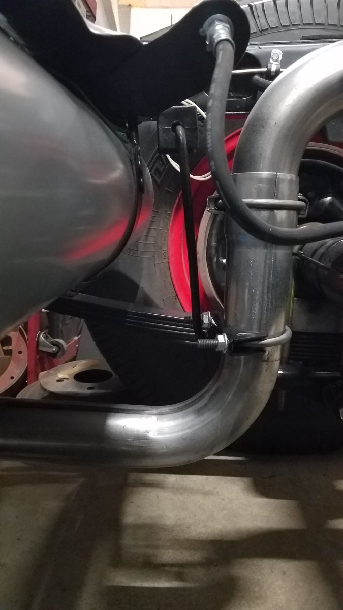

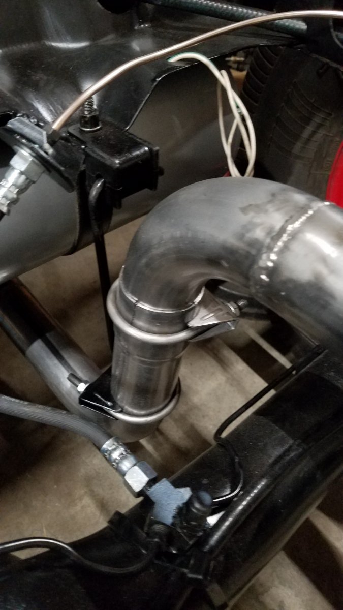

    Wife took a couple pics of the exhaust mounts and the tail pipes so I thought I would include them.
    Dave

    Is it just the angle of the camera or is that rubber brake line feeding the rear brakes right next to the exhaust pipe?

    I wondered how long it would take for that question! I noticed it in the pic when I posted it. It actually clears it by several inches, but thanks for the heads up on what might have been!

    @Fat47 does this show it better?

    Yes. It was the camera angle. Great work.

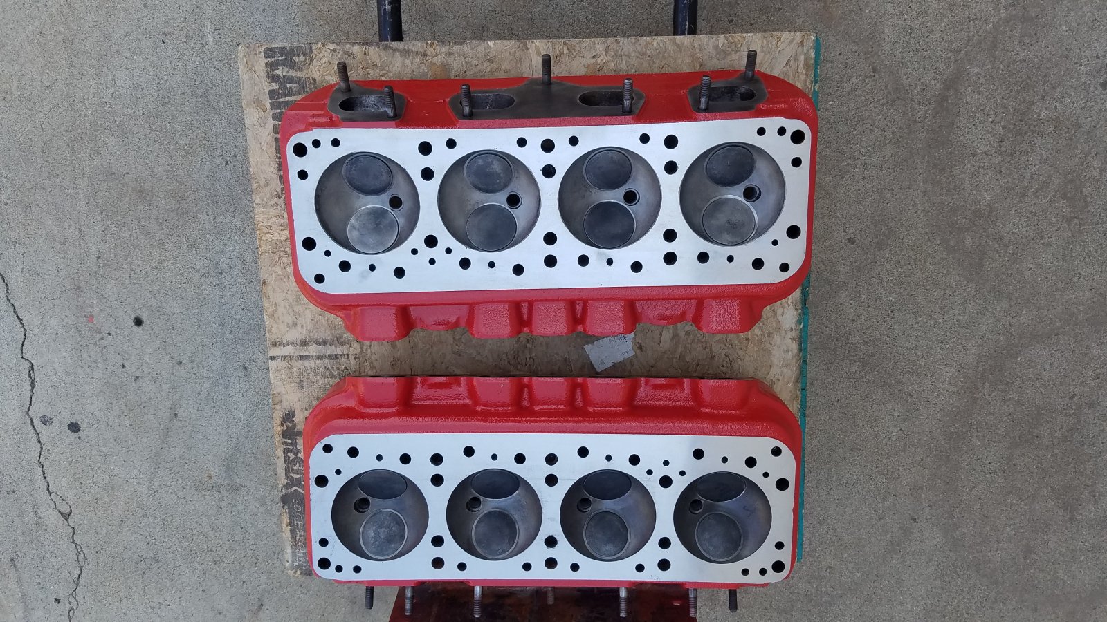

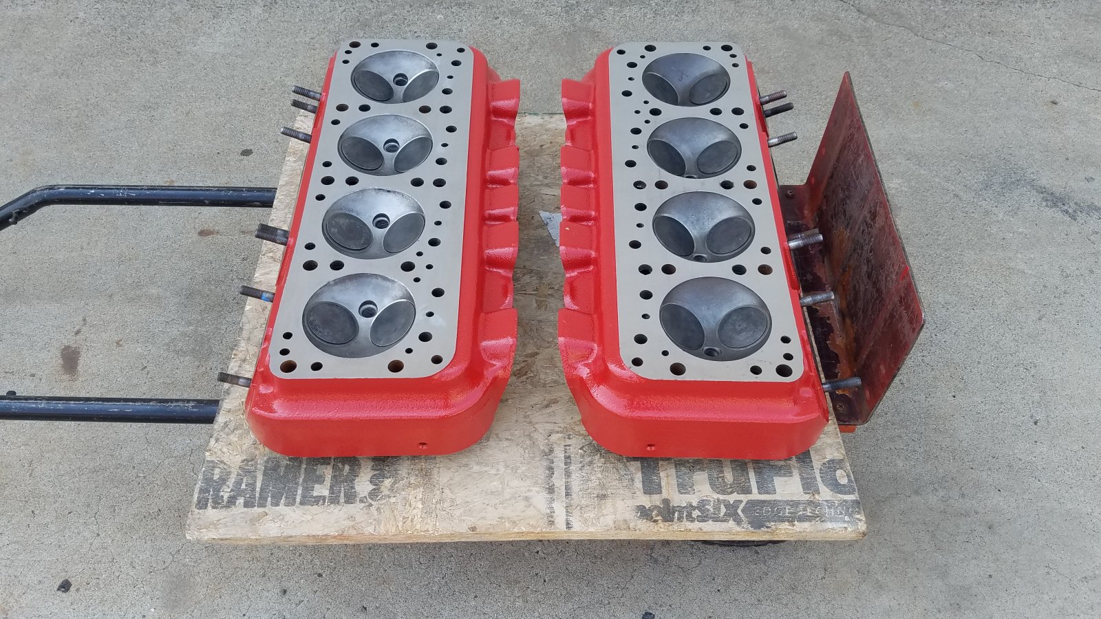

    Progress! Heads are together and painted. With pics no less! I will have them on the engine today and maybe fire it up.
    Dave
