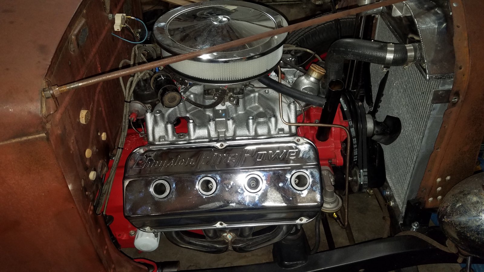

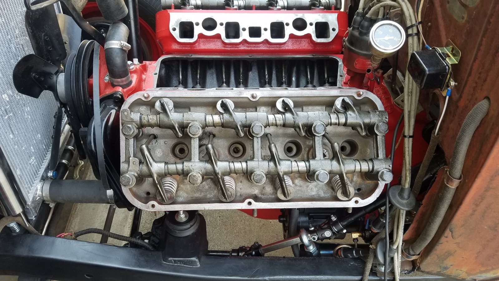

  2. dwollam
    Joined: Oct 22, 2012
    Posts: 2,809
    dwollam

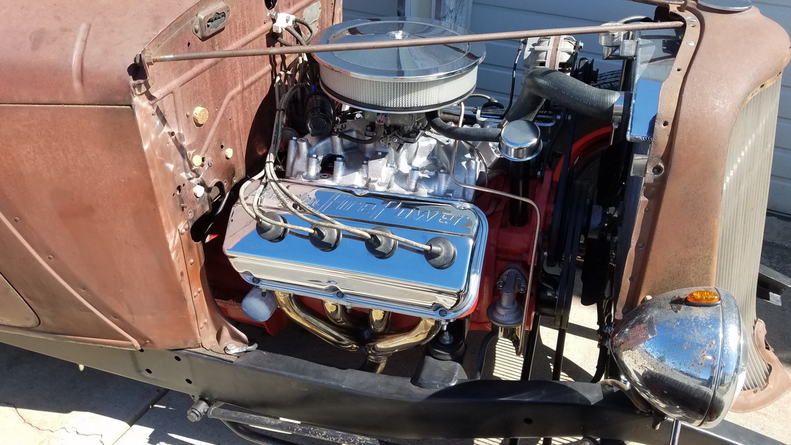

    No Doug, it is just me and my wife. She helped me lift and install heads and intake. Back WAS better but now..... We will have to wait and see.
    Got the heads and intake installed and the right side header. A few lines hooked up. My back is hurting and it is 92 degrees in the shade. Sorry to say I have quit for the day.
    Here's pics.
    Dave

    Well, it runs again! My back is dead for the day so I had to quit. Still a few things to do engine wise like retorque head bolts, spark plug tubes, etc. but at least it runs. Still got things to do elsewhere on it but closing in.
    Dave

    Engine is back together and running. Exhaust has been reconfigured to accommodate switching to the headers. Still doing little things like fixing the failed new turn signal switch, doing some spot welding here and there, cleaning up wiring, etc. Yep, it looks like it will make it!

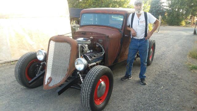

  18. dwollam
    Posts: 2,809
    dwollam
    My friend Rodney snapped this pic yesterday. Then today he dropped by with a 3.55 8 3/4" pumpkin to replace the too tall 2.76's that are currently in the '33. Thanks Rodney!
    Jeez I'm old!
    Dave

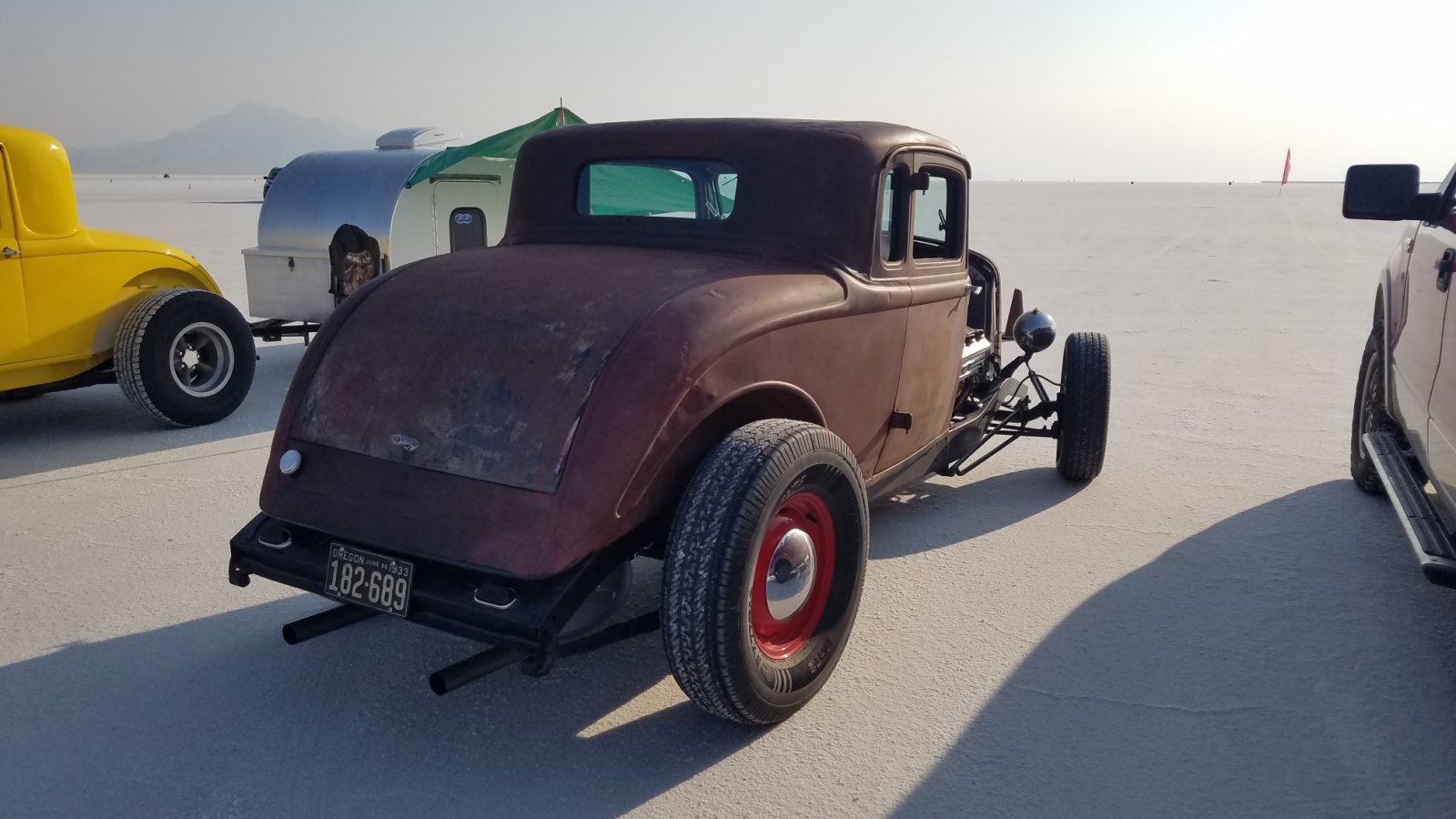

  22. dwollam
    Posts: 2,809
    dwollam
    Well, we made it to Bonneville with the '33 Plymouth. No I didn't drive it 640 miles. I'm old and broken and I need a good place to stay so we towed with the motorhome. Ran into Wendover but not many here yet on Wednesday. Here is a pic at the Nugget tonight.
    We are camped up the hill just a bit from the bend in the road.
    Dave

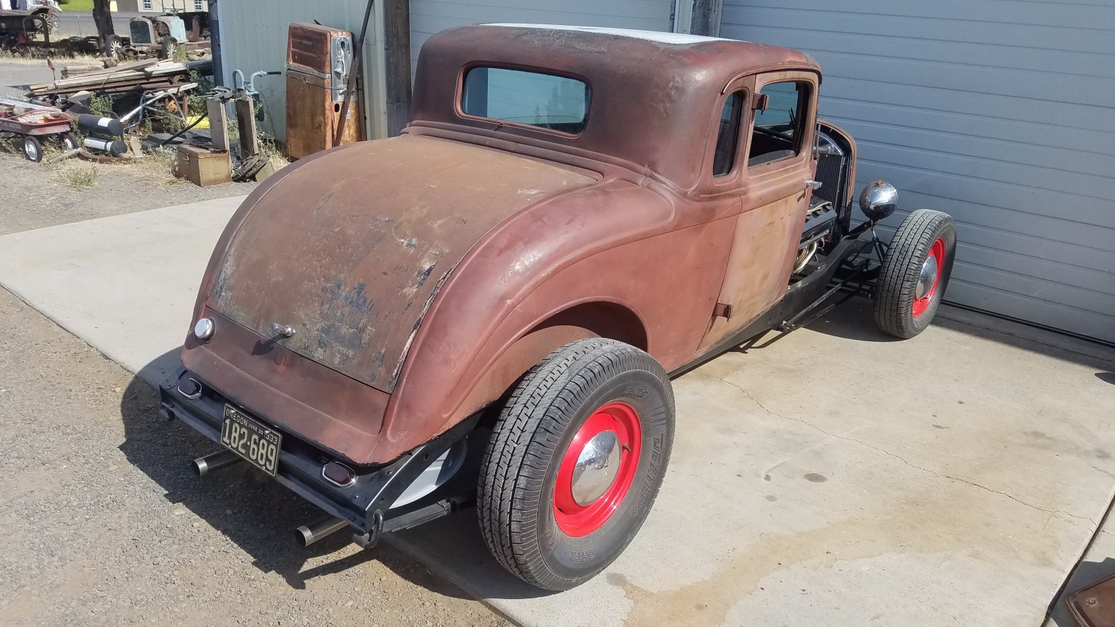

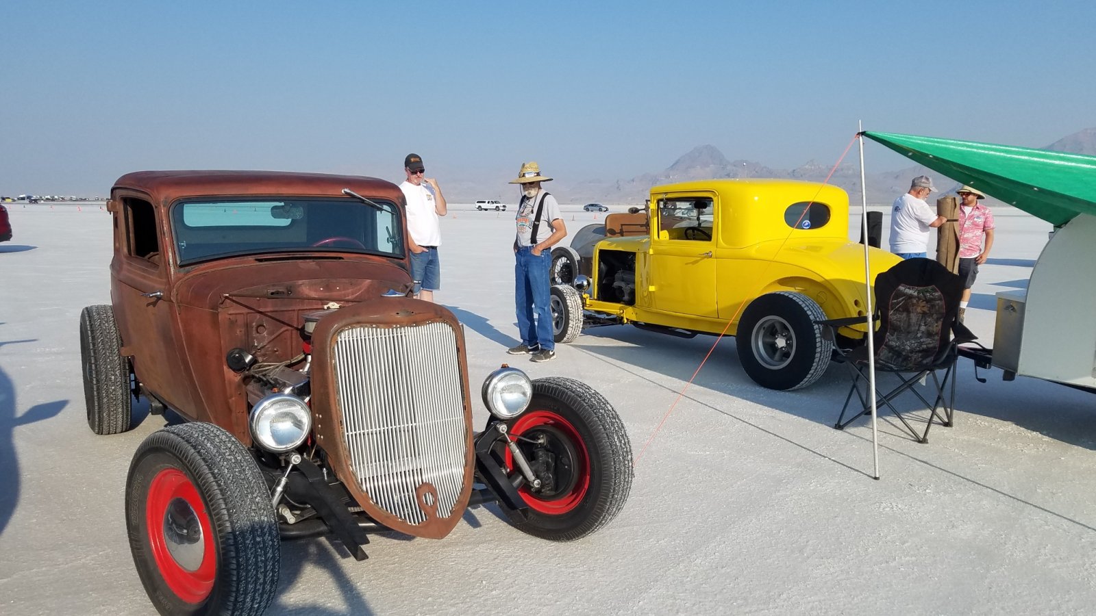

  26. dwollam
    Posts: 2,809
    dwollam
    Beautiful day on the salt. 33 is doing great. Met some very nice HAMB ers. Here's the 33 and Scott's 31.
    Dave
