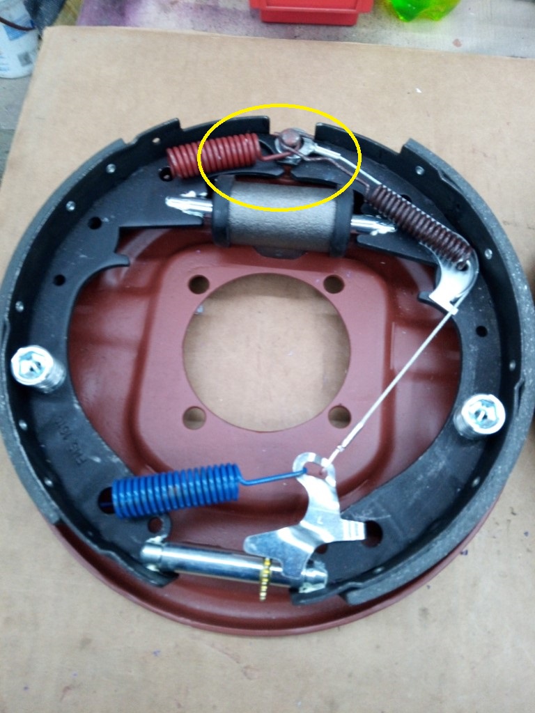

    FYI This info pertains to F-1 & F-100 brakes as this dummy didn't read the OP's question correctly.
    H2540 & H2541 self-adjuster repair kits and a H7144 hardware kit.
    The shoe retainer should be trimmed to clear the forward spring. The retainer in the picture is a factory retainer; but easy to notch the original to clear.

    Things to get or consider:
    Correct kit for the diameter of the brakes.
    This Rock Auto link shows part numbers for 11x2 kits if it works right. These for a 64 F100. 1964 FORD F-100 4.8L 292cid V8 Drum Brake Self Adjuster Repair Kit | RockAuto
    The shoes have to have the extra and correct holes for the self adjusters.
    The 228 shoes fit both 53 and 64. I'm not sure that manufactures even sell shoes that aren't designed for self adusters now as the main difference is the size of the hole that the piece the cable rides around is held in with the return spring. I think that they made that hole a little larger when they came out with self adjusters but it shouldn't be an issue.
    The one thing with Ford self adjusters is that the hook on the aduster arm where it hooks into the shoe isn't all that strong if you man handle it when installing the adjuster and spring.

    Good idea to make an extra adjuster hole in the left backing plate. If the plates are off; you can line them up back to back and use a transfer punch to locate the slot.

    Fantastic information! I also believe you need to notch the grease cup/catch because of the cable if you are running them
