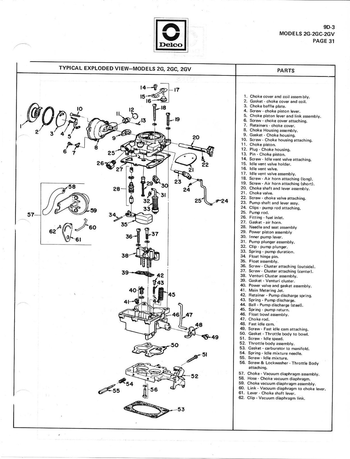

    pprather
    Rebuilding the two barrel will take about an hour to remove and disassemble. A couple hours, overnight to clean. A couple hours next day to "rebuild" and reassemble.
    This is not a big project.

  8. I'd take a stab at rebuilding the 2 barrel first. Usually dirt and varnish in them. Not hard to do, check out Youtube. You mentioned that you didn't know the actual condition or mileage on the engine. Have you checked for timing chain slop? Rotate the balancer back and forth, and see how much it rotates before you get the rotor turning. Distributor runs off of the cam, so you'll see delay if there's a lot of stretch in the chain. Feel bad to add this to your list, but thought I should mention it.

    I know I could overhaul a 2GC in a fraction of the time it would take me to swap an intake and carb to a different setup. I speak from experience.
    I started around age 14. They always ran better after I worked on them, too.

    As far as rebuilding is concerned, the Rochester two barrel is one of the easiest carburetors ever made to rebuild.

    Please forgive my bluntness but you were already thoroughly encouraged to clean that carburetor in a previous thread, stop overthinking all this stuff and just hose it out really well with a couple cans of carb cleaner and blow out the holes with compressed air. Put the basic rebuild parts in it. Then you know you at least have a good clean carburetor and you can go from there. We can theoreticize all day about every single possibilty of worn parts. If I remember right you posted a picture of the inside of that 2bbl and it was brown. Do the basic de-gunking of what you have and then decide if you want to spend money on upgrades. I understand getting overwhelmed with intricate details but this stuff really isn't rocket science, crack the thing open and if you get stuck we'll help you. Somewhere online there's an exploded diagram of that carb that shows how all the pieces go together.

    Take an hour to clean it and be done. If you're still not happy with it then you already have practice cleaning the used Edelbrock before installing it.

    I used to sit at my kitchen table and****emble them on a place mat. Cleaning them is the key element to having them run right. In 1975, I bought a new one at a parts store for $36, it was worth it.
