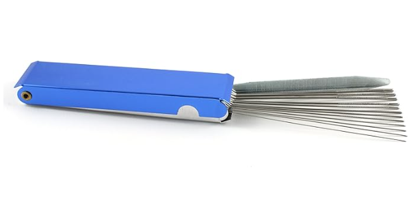

    When you purchase a cheap "amazon" carb you will still need to adjust the mixture, idle, choke ,and possibly the float level. [so learn these skills on a $30 rebuild kit]
    The worst that can happen is you waste $30 on a kit. And you end up buying a $100 "amazon" carb later.
    Also Invest in a cheap Welding Torch "Tip Cleaner"

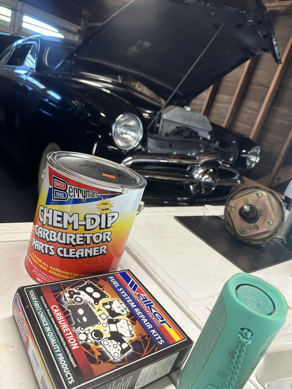

    Purchased the Walker rebuild kit and Chem Dip from Oreilly. I don't think I'll be pulling the carb and doing anything until 3rd week December. The chopped shoebox underfloor brake booster replacement has higher priority.
    Hopefully the bushings/float, idle mixture screws, etc. are in OK shape otherwise this will leak (pun intended) into January when I have time to inspect all those pieces and get replacements if I need to order from some online source.

    I haven't seen a dip-kit around in eons. Some had the little basket for the tiny parts. At times I would drop the bigger pieces off to a parts store, they would soak them in whatever and I'd pick them up the next day. Everything was always clean as could be.

    Thanks! Yea its an additional $73 I just spent on the Chem Dip and Walker rebuild kit that could go towards the 4 barrel upgrade however, I'm going to rebuild for the experience, an additional data point for changes I've made to the truck since I got it in late 2016, and my thought is I hopefully won't make it run worse. There was a time I would gripe about spending an extra $73 but I've reached the point time feels like its moving by too fast and is what I'm more limited by.
