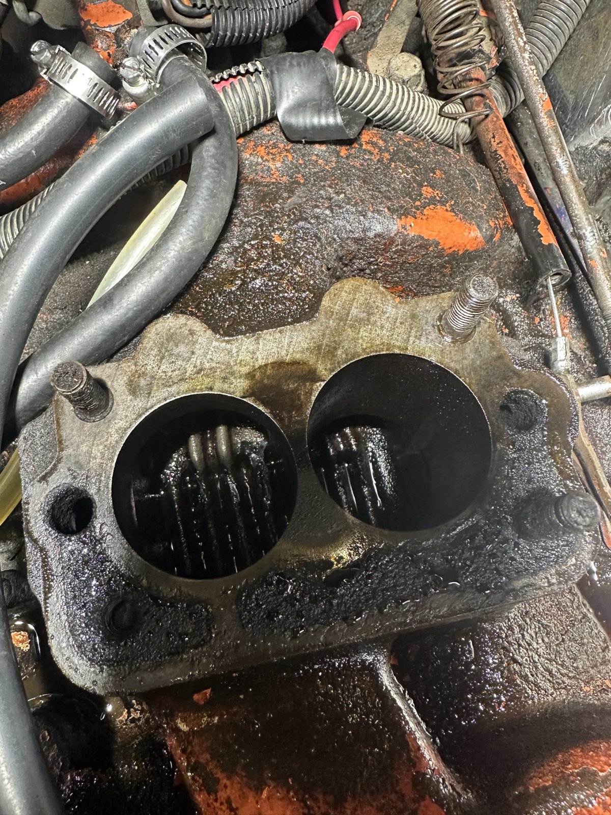

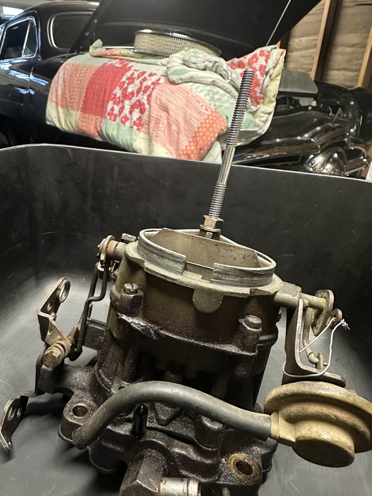

    Thanks that's really great info. The cost isn't the issue, timing (pun intended) for me gives me small increments of availability to do any work to the truck or the 50 shoebox ford. I'll have to clean the carb put it back on and roll the dice for some time until I have time to look into the timing chain. At which point I ***ume I should just change the cam as well? I may (just maybe) have a little bit of time in late August/September 2024. Post Holidays I'm in a real career grind/transition from Jan up to mid August and will drive the truck 10 miles maybe 5 or 6 times and probably not have time to do any work to it.

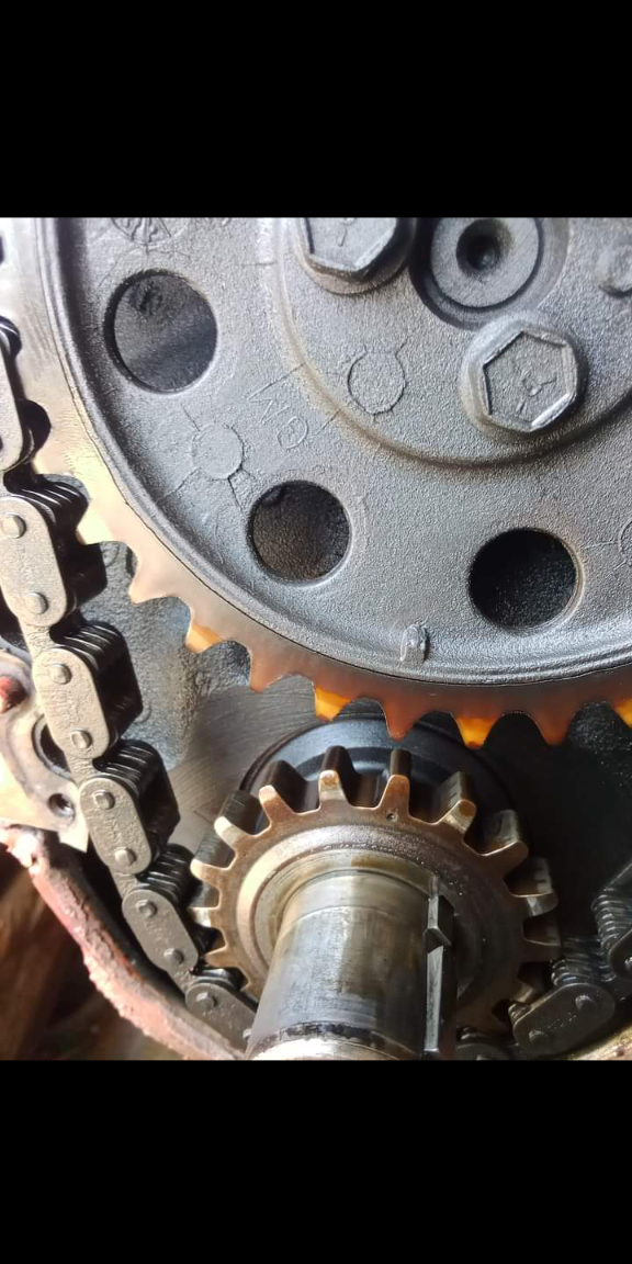

  6. Could be a damaged keyway. Or a bent timing tab. Also in the 70s and 80s gm wasn't exactly known for high production standards. Every hear of the g body shuffle people like the street outlaw goofballs blame on the four link suspension on g bodies despite being the same basic setup as 64-77 a bodies(that don't shuffle)? Most of it is because of the sloppy welds on the frames lol. I've messed with g bodies since around 2000 and came across frames with multiple sections where the weld completely missed the seam in lengths of 6" lol
  7. This is the infamous nylon cam gear btw. Notice despite the gears being in good shape the chain it still sloppy Screenshot_20231222-202429.png

  9. An explanation of why gm (and I believe other manufacturers too) did the goofy nylon cam gears. In the late 60s the whole emissions thing was gaining momentum. They were also going after "noise pollution" on top of whiny people that didn't like to hear their engine at all. The nylon gear was an attempt to dampen normal top end noise. Gm used them in many engines from like 1968-the early 80s. They're why any time I buy a used engine I always replace the timing set first regardless on any engine (aside from series 2 and 3 gm 3800s) lol
    Driver50x likes this.

    Makes sense! There's always the possibility the previous owner changed the timing set before putting this engine in the truck.. since it required some work to convert from inline 6 to sbc 350, perhaps that person had some insight on this issue and took care of it... then again if you saw all the things I came across you might think that person probably didn't have that insight.... given it has 8 degree slack my guess is that is more reminiscent of an original engine with wear? I have no clue on the history of the truck, when that engine was put in, etc.. I just know the engine code shows 1975 when I looked up the numbers. It had some distributor with electrical connectors cut off making me think maybe the previous owner dumped the motor in as is and didn't give a ****.. I changed the distributor out for another HEI unit I had on my other SBC 350 (before I upgraded to streetfire HEI distributor).
    I also read GM used nylon because back then they didn't expect the cars to have a very long life especially given how the bodies rusted much quicker than the timing gear would have worn out.

  12. You'd also be surprised how many old guys that would insist on replacing the old nylon cam gear with a brand new nylon cam gear because "gm did it for a reason" and " engineers know what they're doing" lol.

    do you think I could buy a decent timing chain set at NAPA? I’m working on my shoebox today and maybe carb some tomorrow. I plan to throw the carb back on when rebuilt and see how it runs but just maybe I’ll have an extra day free later next week and may be my chance to knock out the timing set especially if it’s something I can buy local. I rather look first before buying a new set although I suppose the 8 deg slack indicates I should do this even if it didn’t have the original nylon teeth gear.

    thanks some of the choke parts were missing so I wired it shut for the time being and being in San Diego some told me choke isn’t needed here. The vac line for the choke was plugged. I was pulling 18 in Hg after replacing every single vacuum line with new.
    I already changed plugs and wires.
    If compression shows ok I think right now it’s likely a carb rebuild that will get it running great and then timing set replacement to avoid risk of catastrophic failure.

    If you have 8° slack in the timing chain and sprockets, then the camshaft's timing events are also retarded by 8°. Just a new chain and sprocket set will advance cam timing back to where it belongs. The timing of the intake valve closing event specifically makes a noticeable change in whether your engine performs better at lower or higher RPMs.
    Advancing the cam timing 6° or 8° can make a big improvement in idle and lower RPM driving. What you initially felt was a carb problem at idle and lower speeds may have been at least partially a result of the retarded cam timing.

  25. I would have thought by now all the nylon geared small blocks would be dead...
    I replaced my first one when I was 14 years old and 1993 in my auto shop cl*** and it had a ton of play and had a crack then and it was only probably a 15 or 17 year old engine (at that time it seemed like an old car engine but the reality was it was just a used car).
    I would definitely recommend replacing the GM fiber gear set with at least a cheap rock auto "engine tech" set because the fiber gear really is a ticking time bomb.
