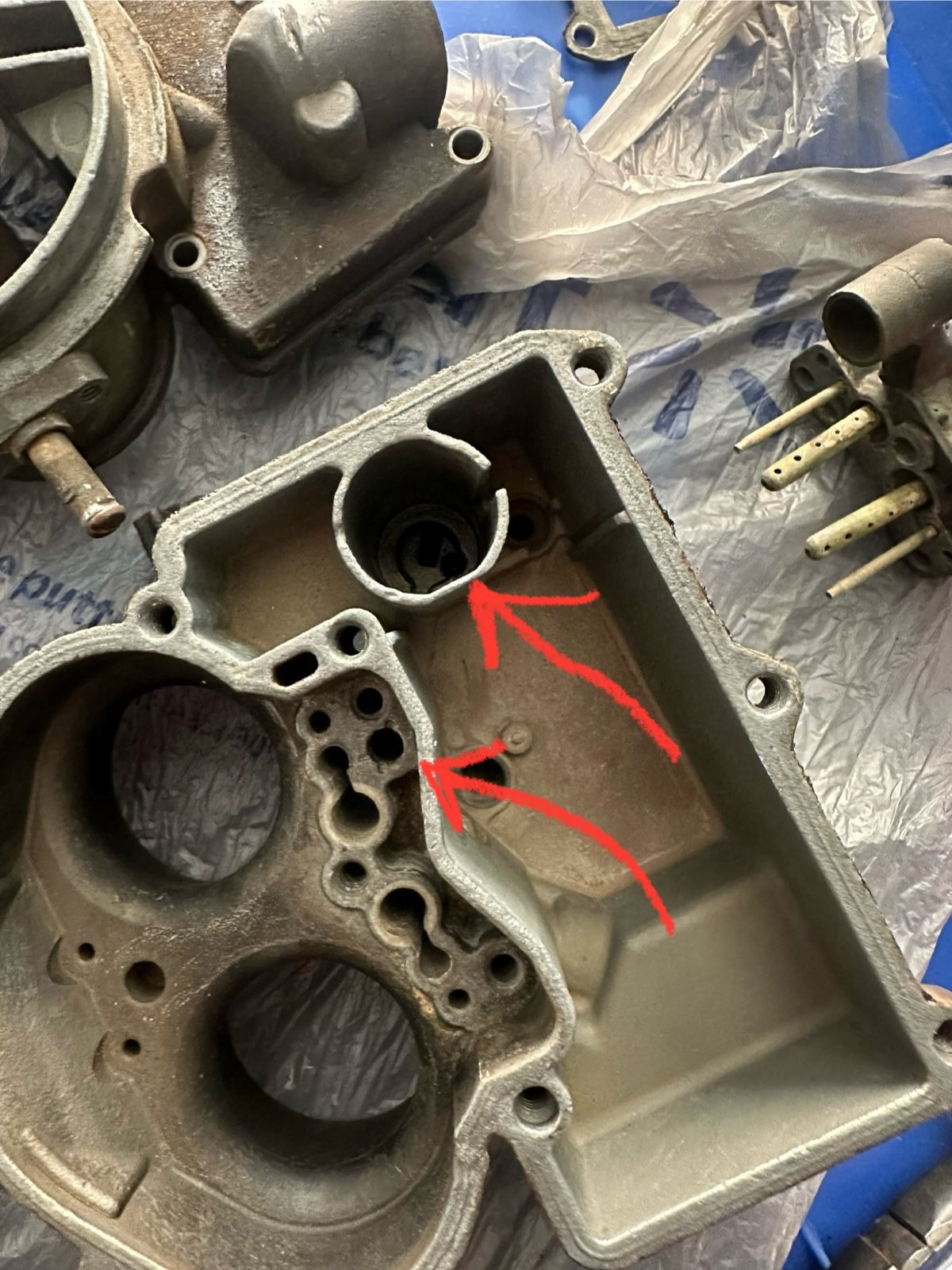

  28. SDrocker
    Joined: Apr 9, 2014
    Posts: 593
    SDrocker
    Here's a progress update on the rochester carb. Looks like someone has rebuilt this in the past.
    1. the check ball below the venturi cluster and one below accelerator pump were swapped.. smaller one should go under accelerator pump but was the other way around and was kind of stuck and had to tap hard to get it out. See photo with red arrows.
    2. Nitrile float weighs 9.5 grams and I didn't see flakes in the float bowl.
    3. Idle mixture screws have some ridges from someone tightening them hard (wasn't me).
    4. It looks like the metal sleeve or bushings that go below the venturi cluster are not there or the previous person who rebuilt this left them out.. not sure if they are critical. hmmm. (see photo with green arrows).
    5. Accelerator pump seemed to be working fine but not sure if I should replace it with whatever the Walker rebuild kit comes with hmmm?
    I'm not sure if I should order anything before rebuilding it, for instance new idle mixture screws, float? I wouldn't mind having this thing back together very soon though.
    In the mean time I'm going to start cleaning this up and hope my siamese cat doesn't go on my counter and start playing with all the little pieces like they are toys.
    TA DAD likes this.
  29. pprather
    Joined: Jan 10, 2007
    Posts: 9,013
    pprather
    It would be nice to have new idle mixture screws, but I don't know if they are available.
    Good catch on red arrow balls.
    I'd just go with what you have on the green arrows. Probably the only choice.
    I'd use the new accelerator pump.
    Hope this helps.
    i.rant and SDrocker like this.
  30. SDrocker
    Joined: Apr 9, 2014
    Posts: 593
    SDrocker
    Thanks! What about the nitrile float? It measure 9.5 grams and I found online the spec is 9 grams... I sort of want to not rebuild this for a bit of time and wonder if the ethanol content in the fuel will make an issue or not too much.
    I can always buy new idle mixture screws and install them later but at least get what I have now rebuilt, fire up the truck to see how it idles/runs and take for a short drive before I tear down for timing chain set.
