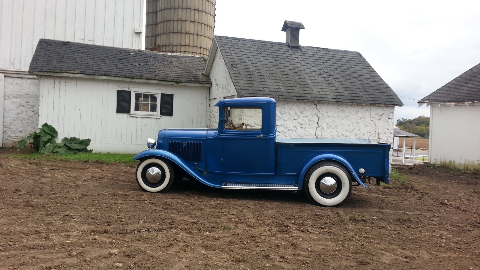

    These running boards were upholstered in the early 80's, that picture was a two or three years ago, they have aged but don't look bad:) The car was a daily Iowa driver for about five years back in the 80's, then parked (a long ugly story) until I put it back on the road over ten years ago. They are affixed to a piece of one inch lumber that was painted, the covers are just tacked over the wood. IMG_0877.JPG
