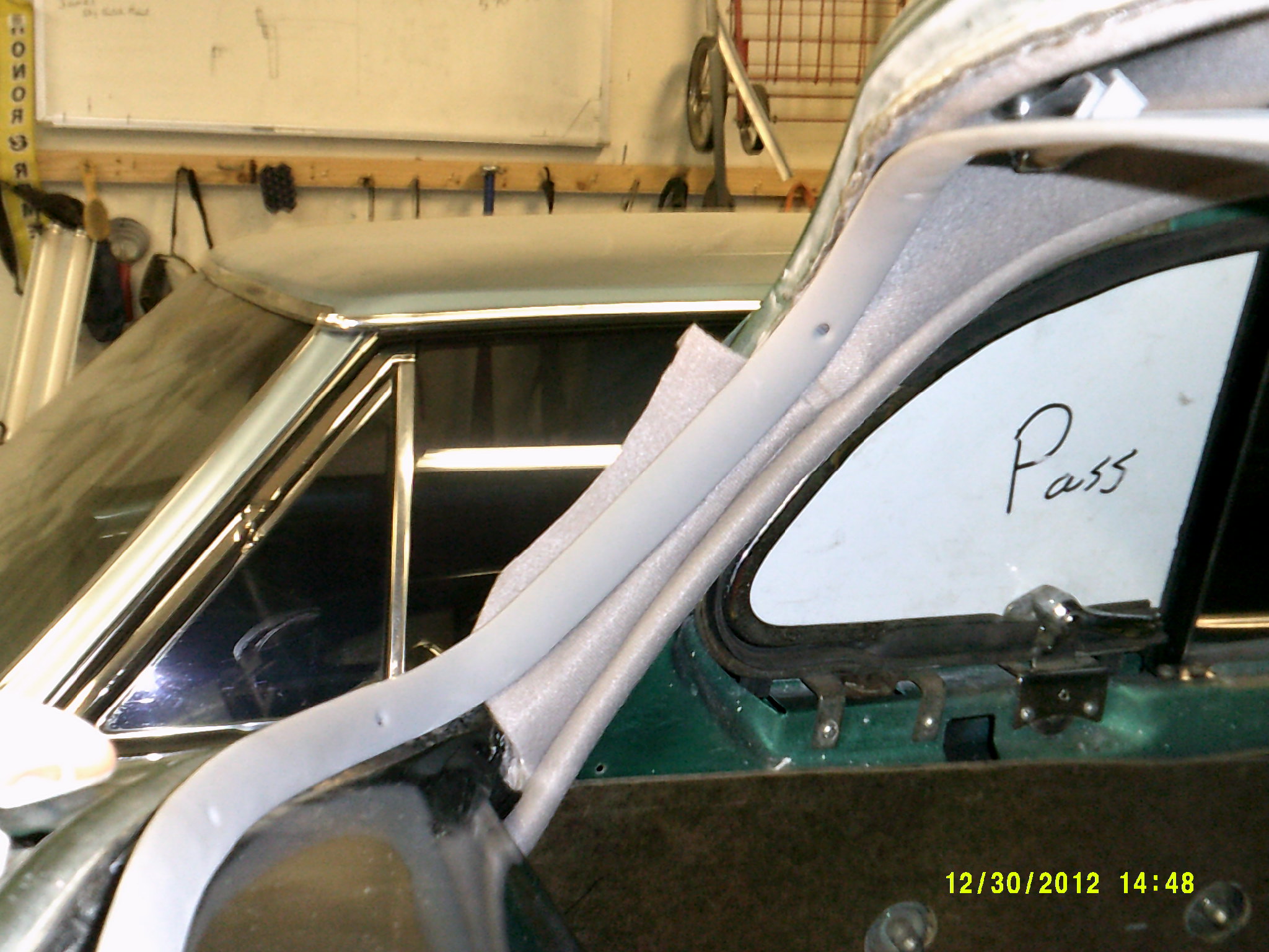

    I did a test fitting of the windshield garnish molding. It's already getting tight on the A pillar, I might not have room for a piece of cardboard. Probably because of the added thickness of the foam. I dug around and my Mom had a curved needle. I think I'll try to sew the A pillar cover piece on by hand with the wind lace installed.
    Thanks for the kind words guys.
    EDIT: never mind, I underestimated how difficult it is to jamb the needle through all that material. 2 broken needles and 1 thumb bandaid later I'll try the cardboard LOL

    The cardboard it going to work, it's 2 layers of cereal box stuff glued together:D

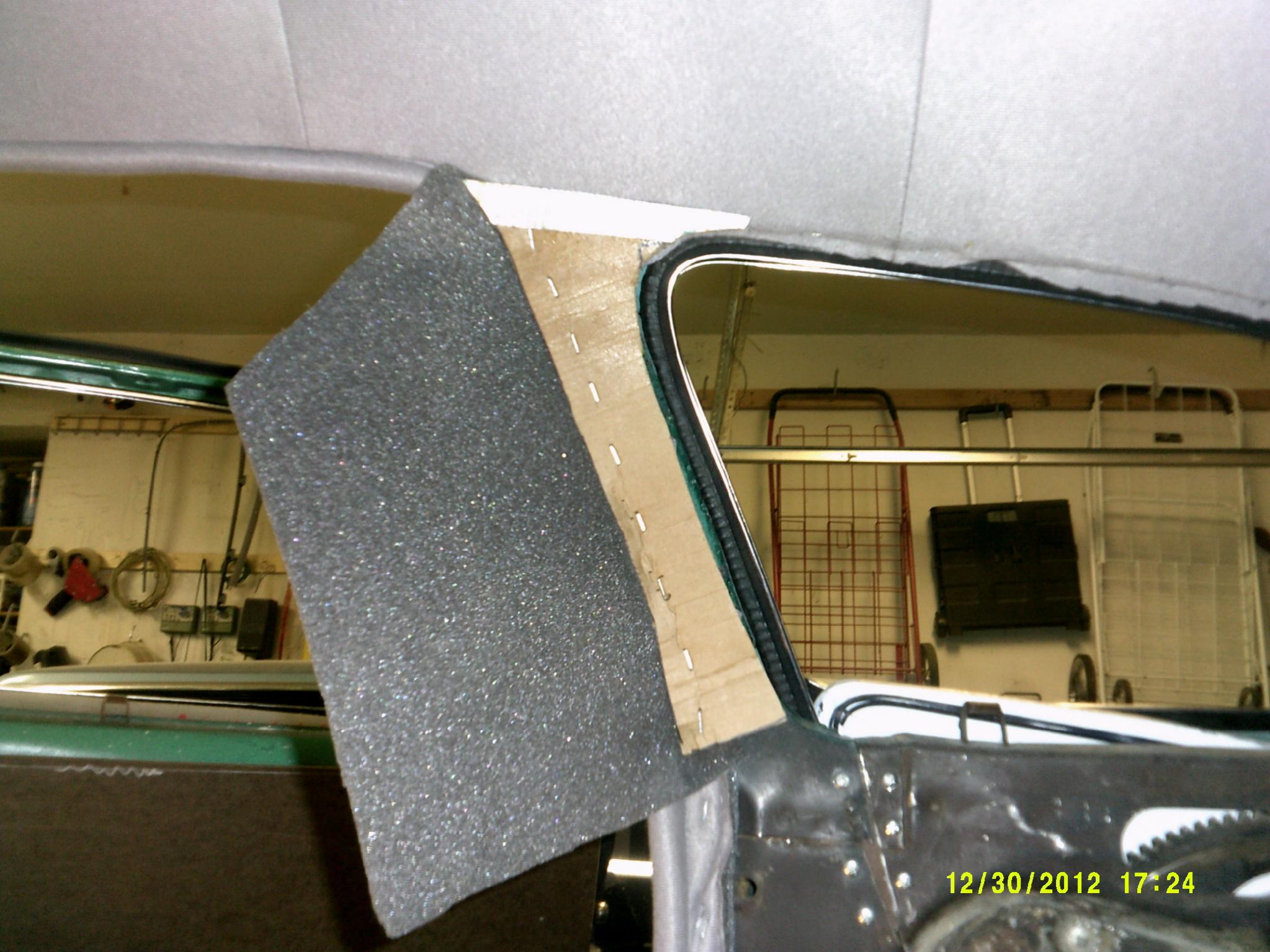

    I got the B pillars finished up. For everyone else, I did a during and after shot. The material is glued to the back of the cardboard on the door side, then just glue on the metal holding the material down on the 1/4 window side. I did reinforce the top of the cardboard with 2 layers, cause the material just tucks under along the top. It wasn't very tight to the garnish molding, so I tucked a few extra s****s under the cardboard to push it against the molding.
