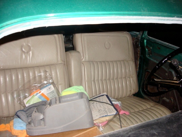

    Here is the Front P***engers seat, and my plan.
    Green pleated inserts running back and up, light grey for the outside.
    And here is a pic of the door panel, and my plan.
    Green pleated running vertically on the bottom.
    Light grey on the top.
    The marker line running through the arm rest will be my split line. I've got some nice SST pieces for the line. It will continue straight back through the 1/4 panel. The garnish moldings will be black like the dash.

    Jack, thanks for the input, I do want to make the front seats more simple.
    It is a 60 40 split bench with an arm rest. I understand what your saying about running the insert straight across, but I think it would be better with 2 separate ones because of the gap and armrest in the middle

    Oh! I understand now K13! These seats arnt like that. I measured them and the pleated area is the same size on both seats. The drivers seat is 4" wider for the armrest, which is not pleated. Here is the best pic I have of them installed
