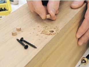

You can counter sink the screws then plug them with wood plugs sand them smooth but you will not be able to take off door panel easily.
