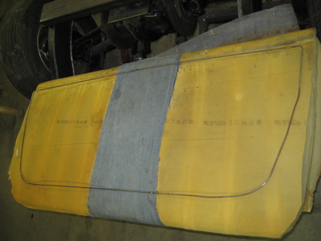

    I tried cutting the stock foam, and there is a 1/8 steel rod that goes all around the foam seat. I would love to have someone show me how in person. I guess it is time to watch a you tube video. Does anyone know where to get springs or foam for a seat? When I had my seat for my bike done they put a gel pad, can you do this with a truck seat?

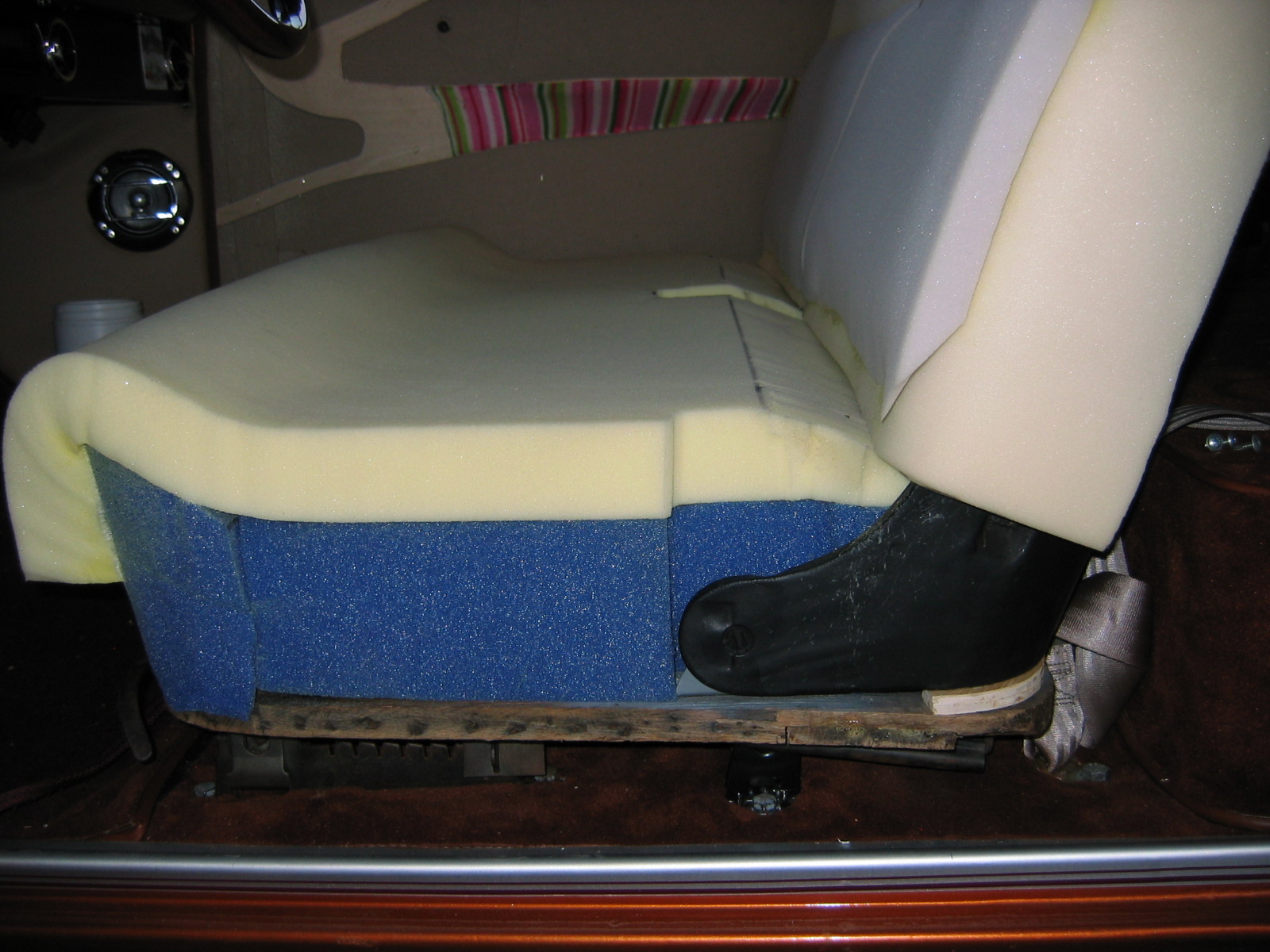

    The last upholstery guy who did the interior of my 27 used 3 layers of foam on the seat part. A firm one first, then a little softer one on top of that, and finally, a softer foam on the very top. It really made a difference, I can drive all day and not get a tired butt like I used to. Just thought I would pass that along.

    When I had the stock 39 bench seat redone, my friend that did the work just built it back up with foam - no springs. I thought he was crazy and it would ride like a rock. He said trust me, and I'm glad I did. No more bouncing around, but can ride for hours in comfort. Like Don said - firm on the bottom, softer foam on the top, and he cut it so it fit the hieght I wanted in the end. But the dude has been doing this for 40 years - I left it to a professional, but might give you some ideas on the direction you want to go.

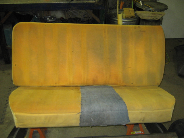

    I decided to reuse the foam from the seat. I will be taking pics along the way, and will do the best I answer questions that you have. Remember this is my first seat, so if you have any input lets here it.

    Good choice in using the original seat bun. You must remember, the OEM manufactures have spent many millions of dollars in foam design. So why do most people think they can do a better job. What is the foam gonna look like after 100,000 miles. Plus it will cost alot more too. You will notice the drivers side of seat foam will be a little softer than the passenger side. Cut a piece of carpet padding about 4 inches wide and the width of your rear. Place it towards the back of the seat bottom foam on the underside. This should make the foam feel more like the passengers side. I do this on about every used car seat I do. Try sitting in your daily driver, you will notice the difference in height beteen the drivers and passengers side seat.

    I cut the wire out of the foam, and shaped it for the seat. Then I took the carving knife and fit the foam to the seat. I will have to wait to talk to the interior guy, from here.
