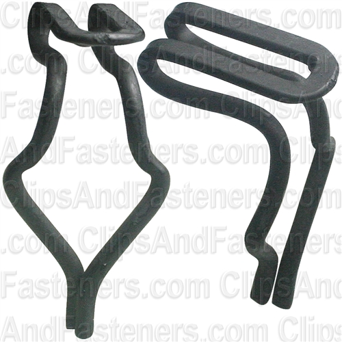

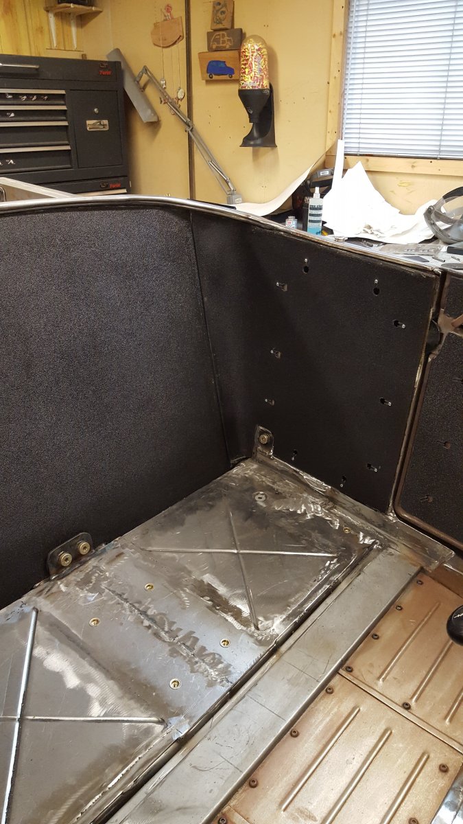

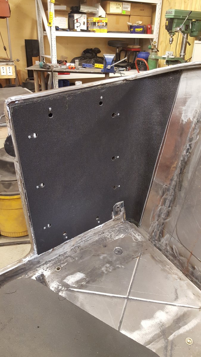

    I used similar clips which are a Ford part and put them through the appropriate size holes (17/64”) in my 1/8” ABS panels.
    With the panels snapped into place I marked the clips location and then using some 1/8” pop rivets I secured them so that they won’t move when I do the upholstery.
    It worked great.
    https://www.clipsandfasteners.com/Door-Trim-Panel-Fastener-Ford-p/a10780.htm
