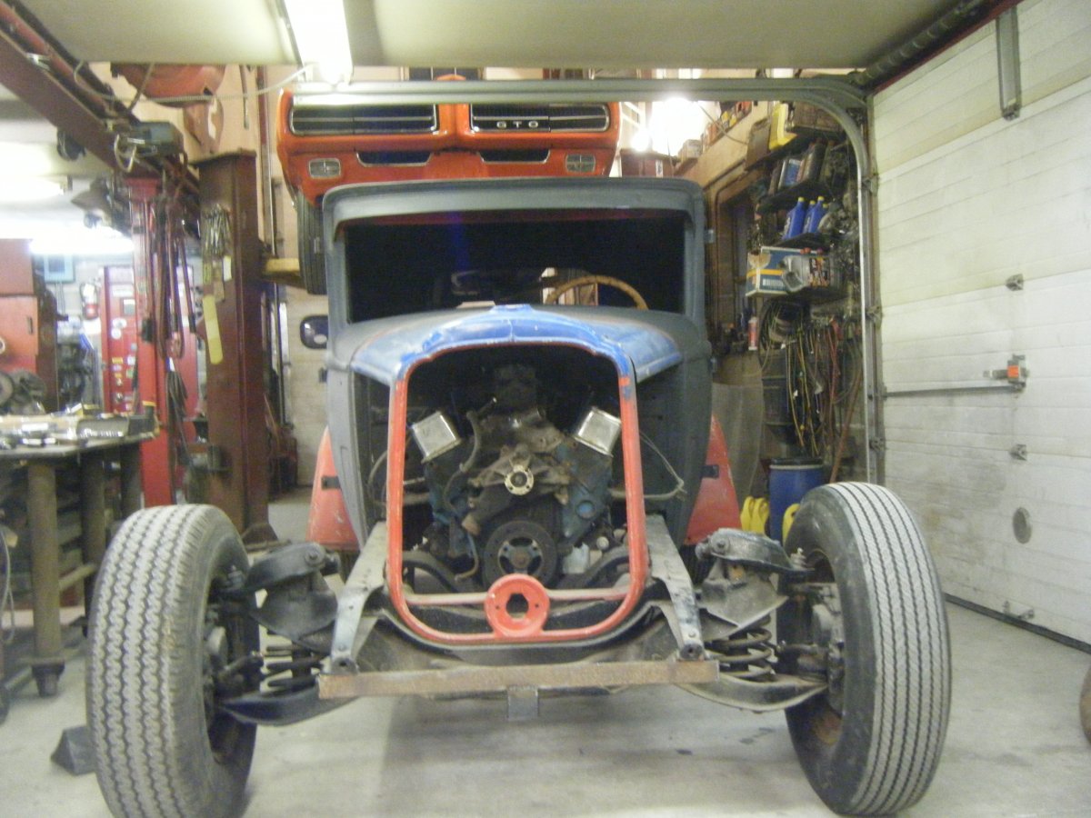

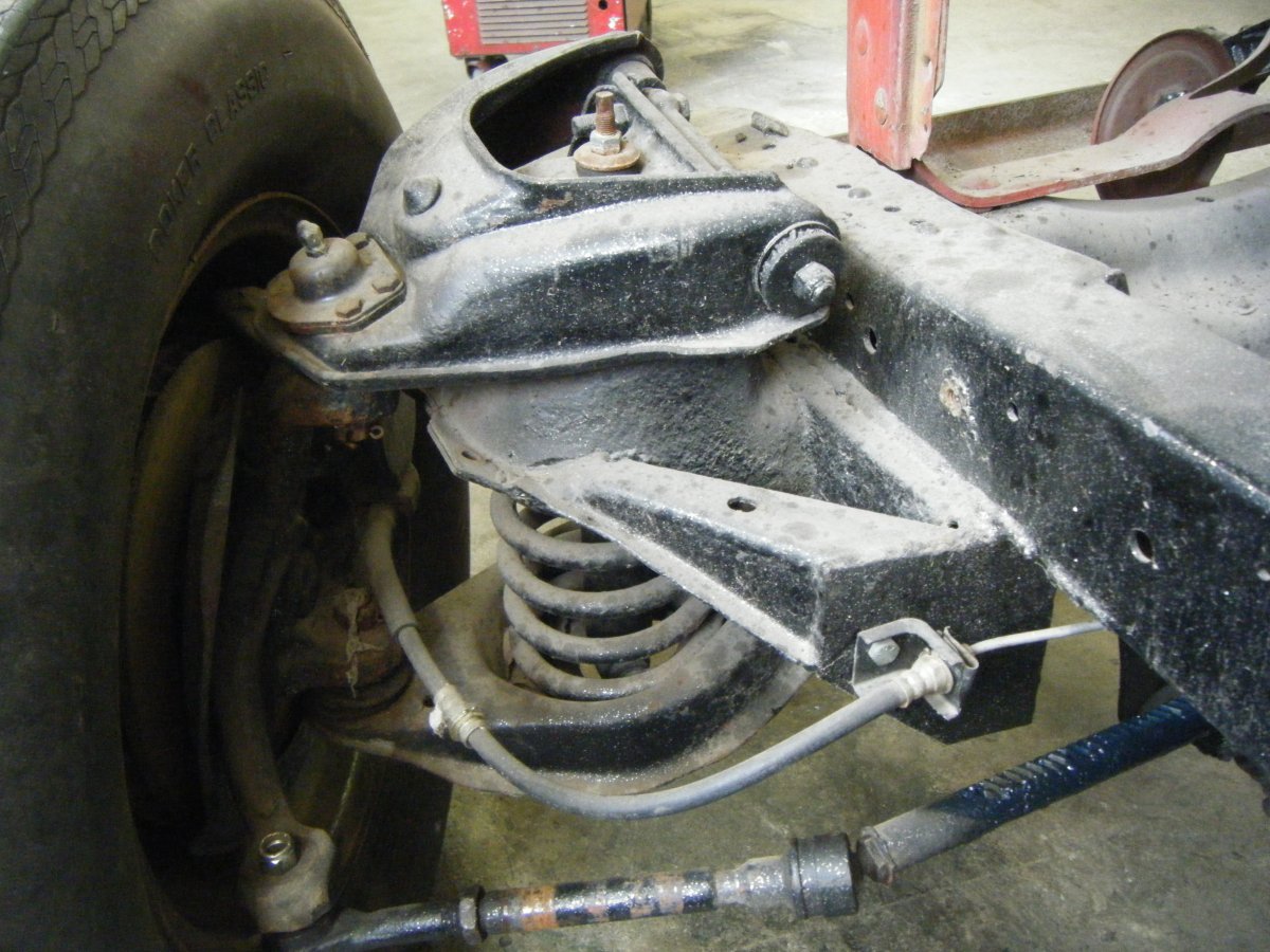

    Hi guys, at the present time I have a 1965 corvair front end with 1974 corvette spindals and discs mounted to my 1931 Model A Slant Window town sedan. The corvette spindals are rasing the upper control arm to high so my tires are slanted in at the top and this is wearing out the inside tread of the tires (this does stick to the road well and corners like it is on rails, but is hard on tires) . My question is does anyone make a upper control arm that will bolt in place of the original a arm but be longer so as to push the upper end of the spindal out to better adjust the camber and caster ?

    How about a picture or 2 of the front end.

    The geometry is all wrong. Not sure what king pin inclination (KPI) was on the Corvair spindles or distance between top and bottom but the C3 spindles are a different height and aren't doing you any favours. Most likely your Ackerman angle is out as well and doesn't help when turning corners. Older conversions swapped the steering around causing this. Does the C3 spindle taper match the ball joints, I****ume it would? This picture below could be your problem. Could I suggest scrapping that front end and starting afresh with a either a MII or beam axle and cross steering. In the end you will thank yourself as it will drive and handle better and not wear your tyres out.

    i have a 31 buick that has a corvair front end in it also and they used a later spindle to get disc brakes. as you can see they raised the upper control arm mount. DSCF5018.JPG DSCF5029.JPG

    Do you know what spindles were used for the conversion as I made my own caliper mounts for the c2 vette spindels and machined the discs down to fit the rims I have. I will see about taking a few pictures when I can get the car out of the shop as I'am redoing it now and really don't want to change the entire front if I don't have too.
