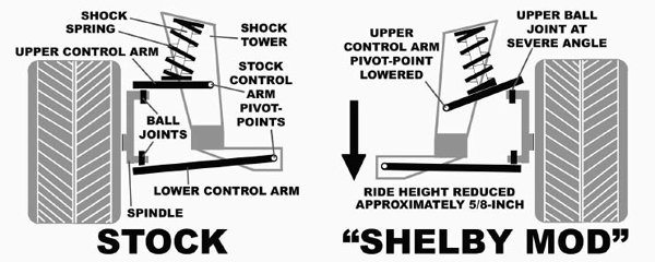

    My control arms are 1-3/4" down on my Falcon. This is the "correct" location, as determined by Klaus Arning for he Shelby full race cars. This is, of course absolutely not possible without using a set of wedges to correct the ball joint angle. The max you can safely do without them is about 1".
    It made an alarming difference in handling.

    I've answered my own question in regards to lower ball joint. The Corvair point's up as well. So if one was to look at reply #14 one will notice the height of the spindle from the lower ball joint is nearly the same between the two. Wouldn't putting back a pair of stock spindles and stock upper a-frames with a ball joint spacer (between ball joint and a-frame) bring things to near correct position ? Especially if tall springs are in said vehicle. [​IMG]
