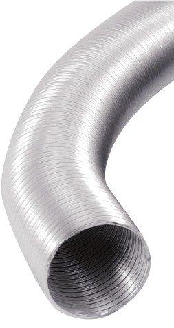

    I have a pair of Volkswagen beetle warm heater hoses, the are light weight, flexible aluminum and when using them to route how you want the hose they will hold their shape.
    Then take them with you when looking for the hose, remember some hoses may be close and you my have to trim off a odd appendage. HRP

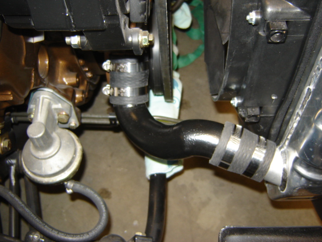

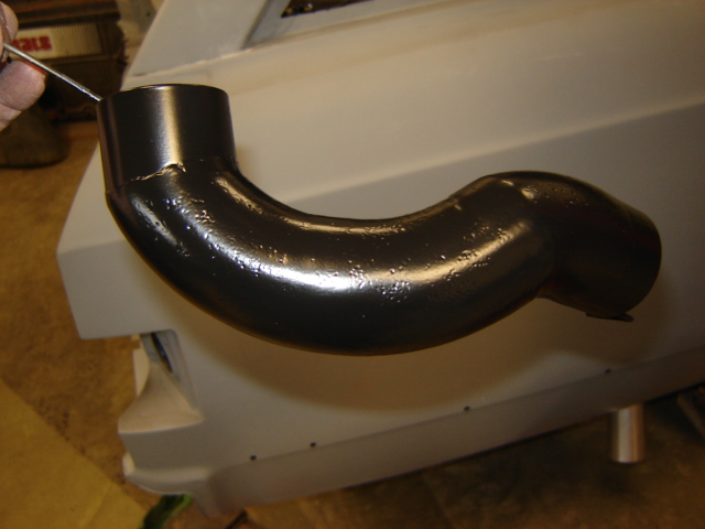

  12. Groovy
    Joined: Aug 9, 2015
    Posts: 274
    Groovy
    Already did that to my brothers Chevelle with a radiator from another vehicle which made using a regular hose impossible. Hate the way this looks and have since DSC01010.JPG DSC01018.JPG DSC01020.JPG found a hose with funky bends that should work...

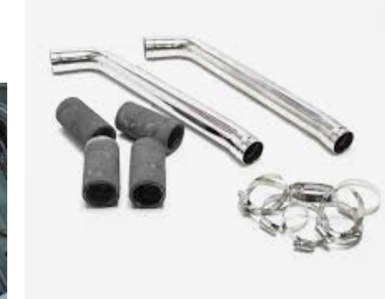

  14. Or fab out of metal and add short straight hose pieces to attach it
    like these for a flathead
    jimmy six, 283john and clem like this.

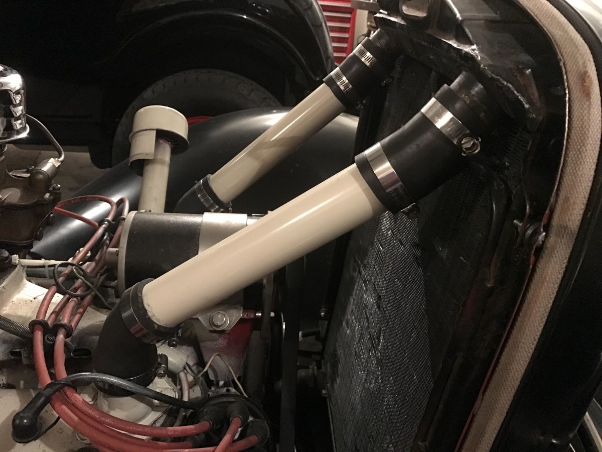

    a couple of ideas that I came up with, s/s pipe painted on the flathead.
    117CA9C8-5B4E-42F4-A05C-3892D9ACD79F.jpeg 5EF6527E-432A-45C2-9C25-947A58E20E94.jpeg
  16. This would be traditional.....
    Muttley, Blues4U and sidevalve8ba like this.

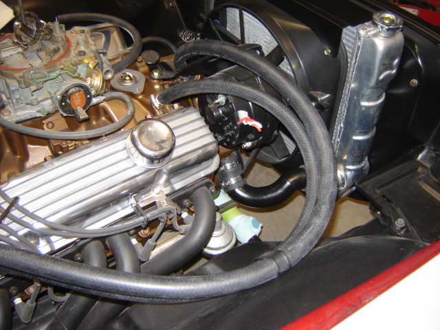

  20. wvenfield
    Joined: Nov 23, 2006
    Posts: 5,674
    wvenfield
    This is what I did. Two things, this was pre-covid and the people at the local Advance Auto store know me well. They had a pretty decent selection still and I found a hose that fit. As you note I had to trim the ends.
    Bottom Hose.

    Get a straight-up thermostat housing. They were used on Chev vans. The hose connection is offset forward slightly. Might then be easier to find a hose that works for you. 20201210_141414.jpg

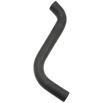

  27. Groovy
    Joined: Aug 9, 2015
    Posts: 274
    Groovy
    Thank you all for the replies.
    I've located a Dayco hose 70627 which looks like it should fit. Just haven't been able to locate one locally to examine but will have to order one from the east coast. 70627.JPG s-l225.jpg
  28. alanp561
    Joined: Oct 1, 2017
    Posts: 5,677
    alanp561
    Heck, it looks like it was made for it. What's that saying, " form follows function "?
