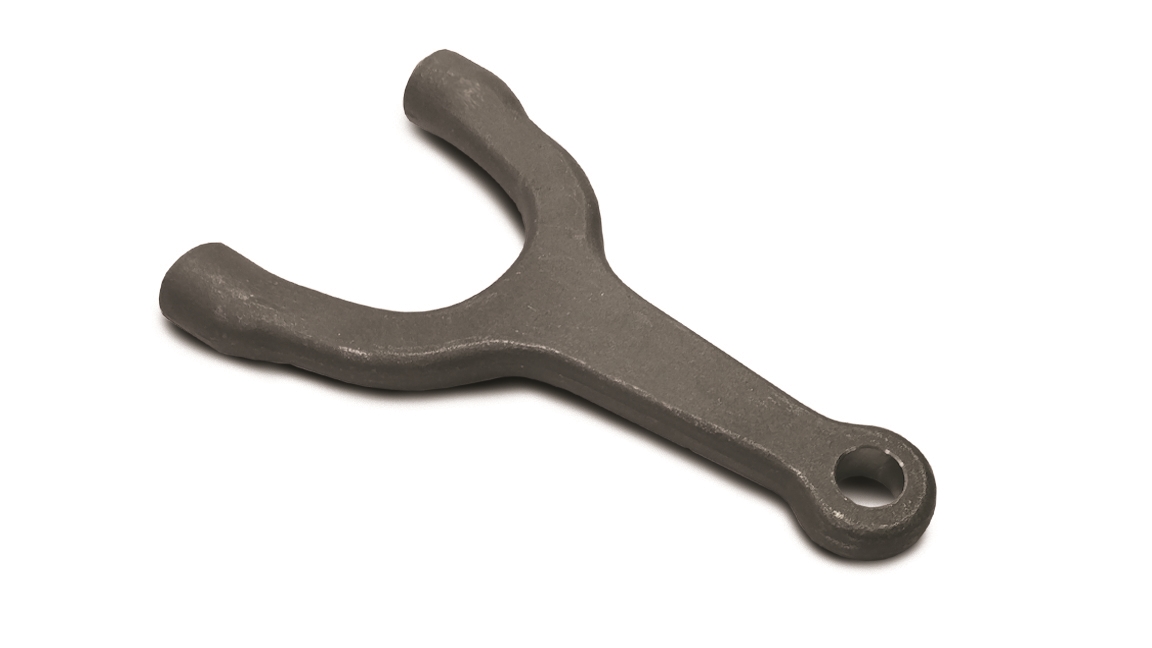

  14. I have a 4” dropped I beam on my 27, used a “ dogbone” arm from Speedway, it looks like it was waterjet cut , shaped it with a body grinder, been there since 95

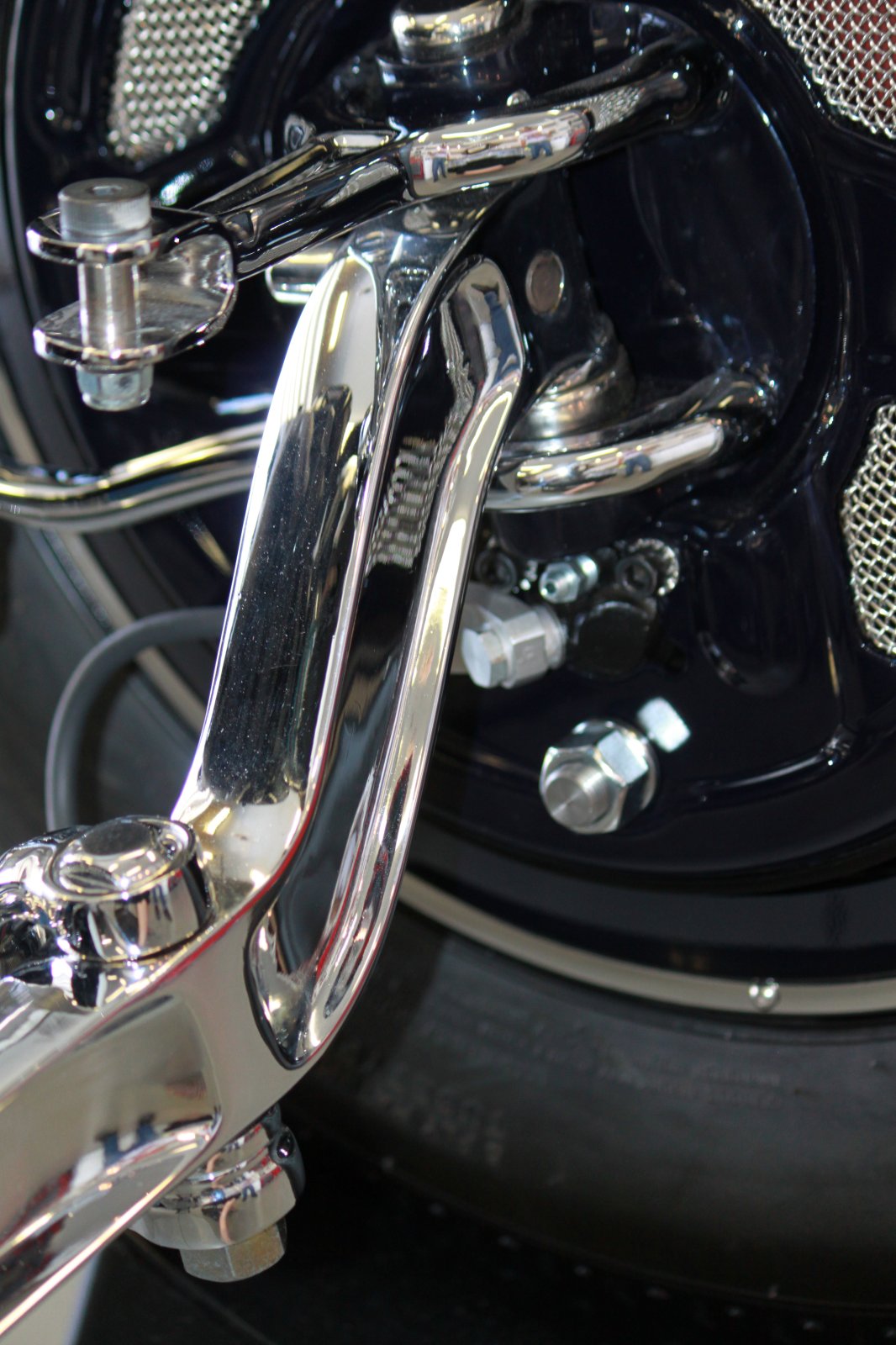

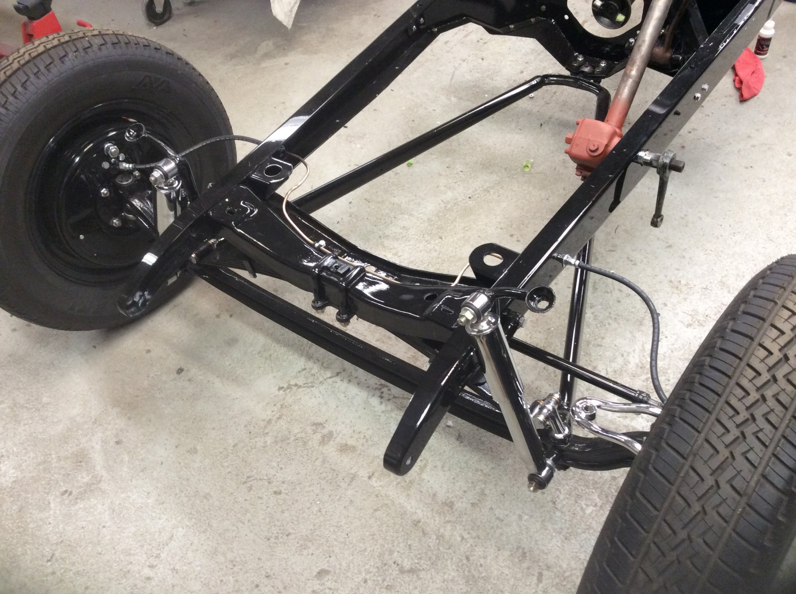

    I modified a Super Bell arm to accept a rod end. IMG_2281_1.JPG Shock out.JPG
