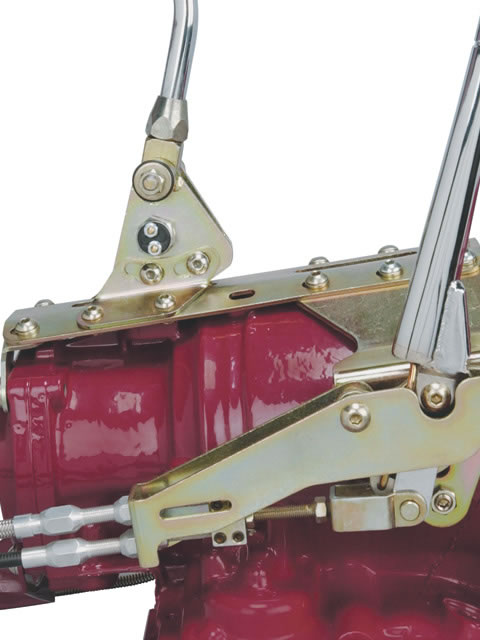

    I have a Lokar EHB Transmount emergency brake. I attached the Lokar instruction sheet.
    It was mounted to the transmission and now no room between the AOD housing and the floor tunnel.
    All cable is still there and it seems like there should be a way to make some sort of bracket to secure it to the floor. Any ideas.?

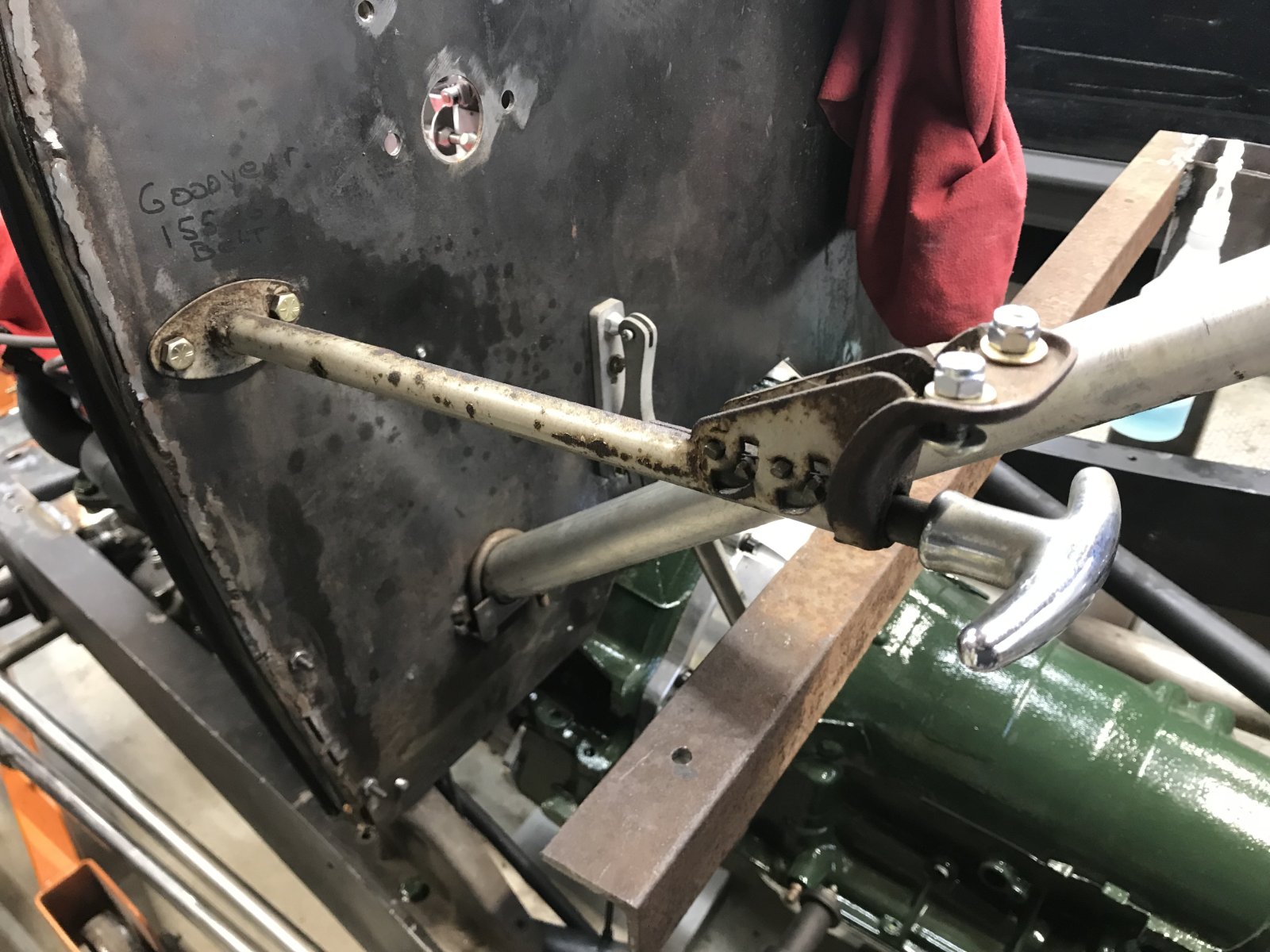

    I used the ratchet tee pull handle mounted under the dash left. IMG_4750.jpeg 69905365219__2AF96384-A962-4217-A9EC-A1FB3DF9355C.jpeg

    A lot of head scratches went it that “imagineering” but the pull handle is what my dad installed so I had to make it work.

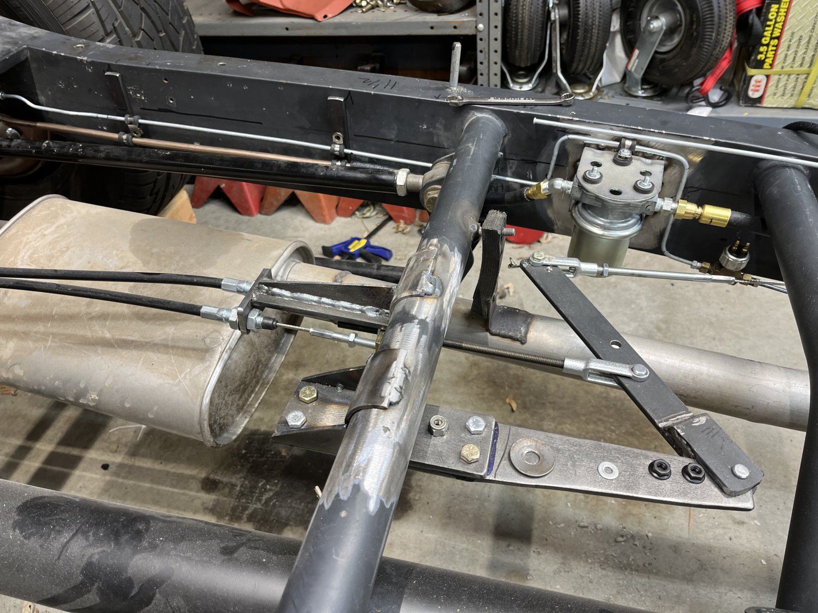

    Not at the moment, the body is at the body shop getting worked on for paint. Basically it’s just the cable from ratchet handle to fulcrum. I used Control Cables to make all cables from pull to rear brakes.

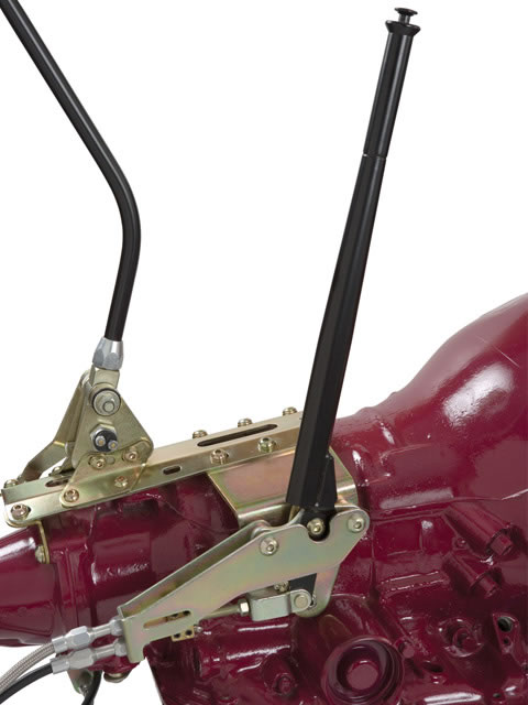

    Well you have to know that at least Gimpy can actually read and comprehend the OP's actual question and as usual give a solid answer. They mount the Lokar cable shifters on top of the floor now rater than on the transmission and it shouldn't be that hard to fab brackets to hold the verticle handle next to it and run the cable though the floor, The hard part will probably be figuring out a boot to cover it that looks right.
    It may take a slot in the floor so that the works of the park brake are just far enough below the floor that the cables run under the floor if that is possible. handbrake-on-trans-black.jpg transmountapplication.jpg
