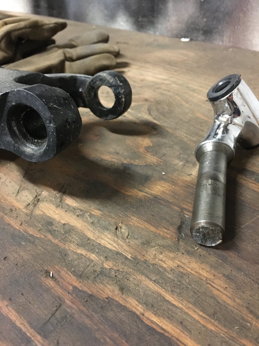

    My plan is to not have this happen again.
    5000 miles, spring over axle tradition setup. Nothing crazy.
    Was setting my brakes as per my last thread, did a low speed panic stop to try and lock the brakes up.
    Next morning I had a squeak. After work I checked it over and found this.
    Went out and found my little black marks and right after the rest of the perch with nut and cotter pin was laying on the road.
    The torque from braking snapped this ****ty casting.
    So with the next one, want something that won't try to kill me...

    Could it have been the chroming process used on the perch that caused the failure?

    Were you using a tapered castle nut on the perch pin?

    Tapered, now sure how you would use a flat one?
    Its stainless not chromed.
    That is where I think I'm headed, I have asked where they are made, but no answer. Haven't read of failures from them though which is positive.

    Hydrogen embrittlement which is the loss of ductility can occur as a result of electroplating (chrome plating) of high strength steels. Hydrogen embrittlement can cause cracking of highly stressed parts. Typically high stressed parts are baked at approximately 300 F for a few hours depending on weight to eliminate hydrogen embrittlement within a few hours of completion of plating. For non stressed chrome plated parts this is not an issue.
    If I were buying chrome plated suspension/steering parts it would only be from a reputable source or someone who could answer how the parts were processed.

    The location of the failure in the pic suggests improper threading, probably a deep thread land with a sharp edge. That causes stress concentration. It can be exacerbated by over-tightening the perch nut.
    Is that he common point of failure?
