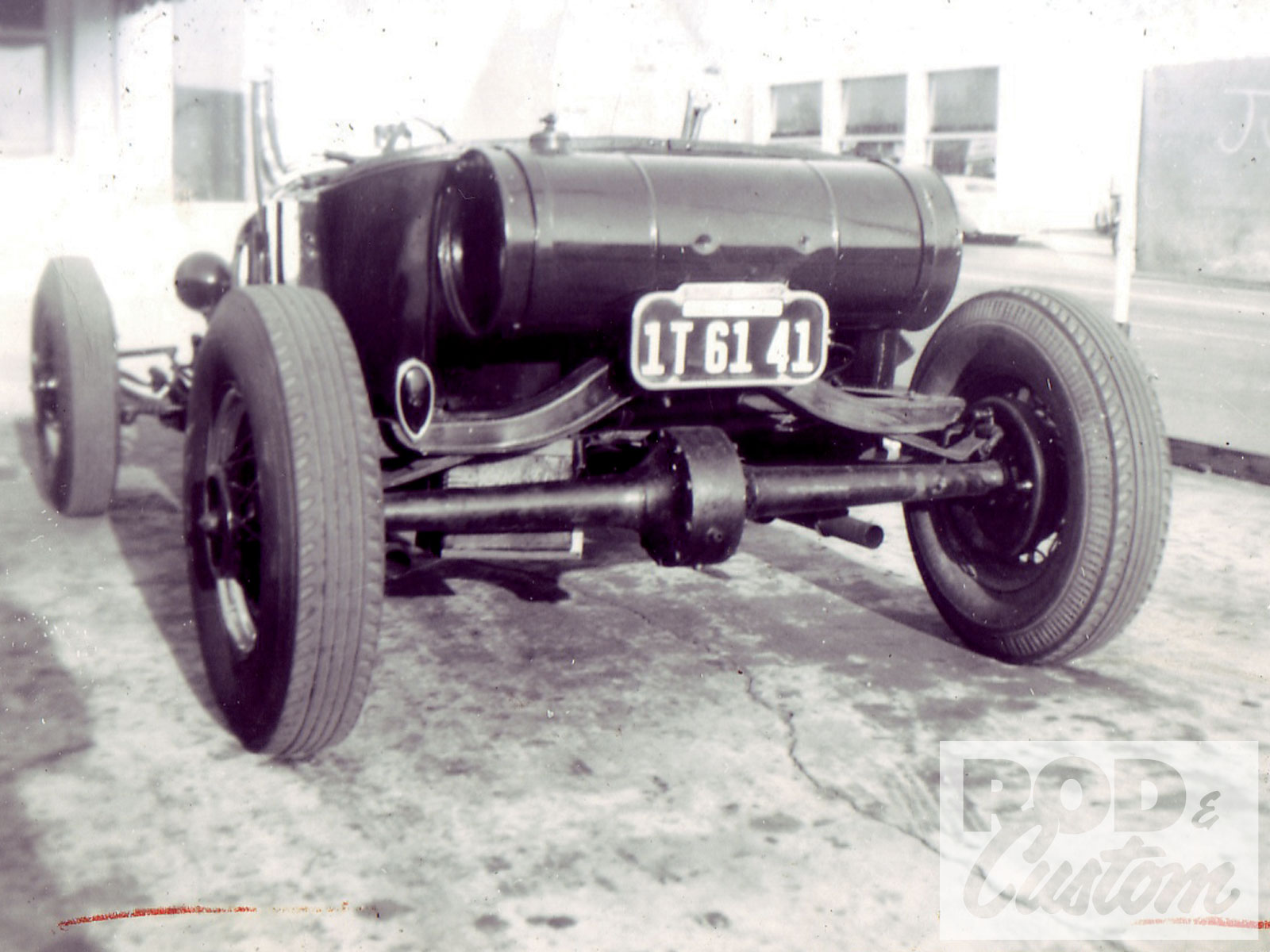

  15. From another thread.
  16. big duece
    Joined: Jul 28, 2008
    Posts: 6,976
    big duece
    from kansas
    That's one nice rear, (if I can say that here) where are the shocks?
