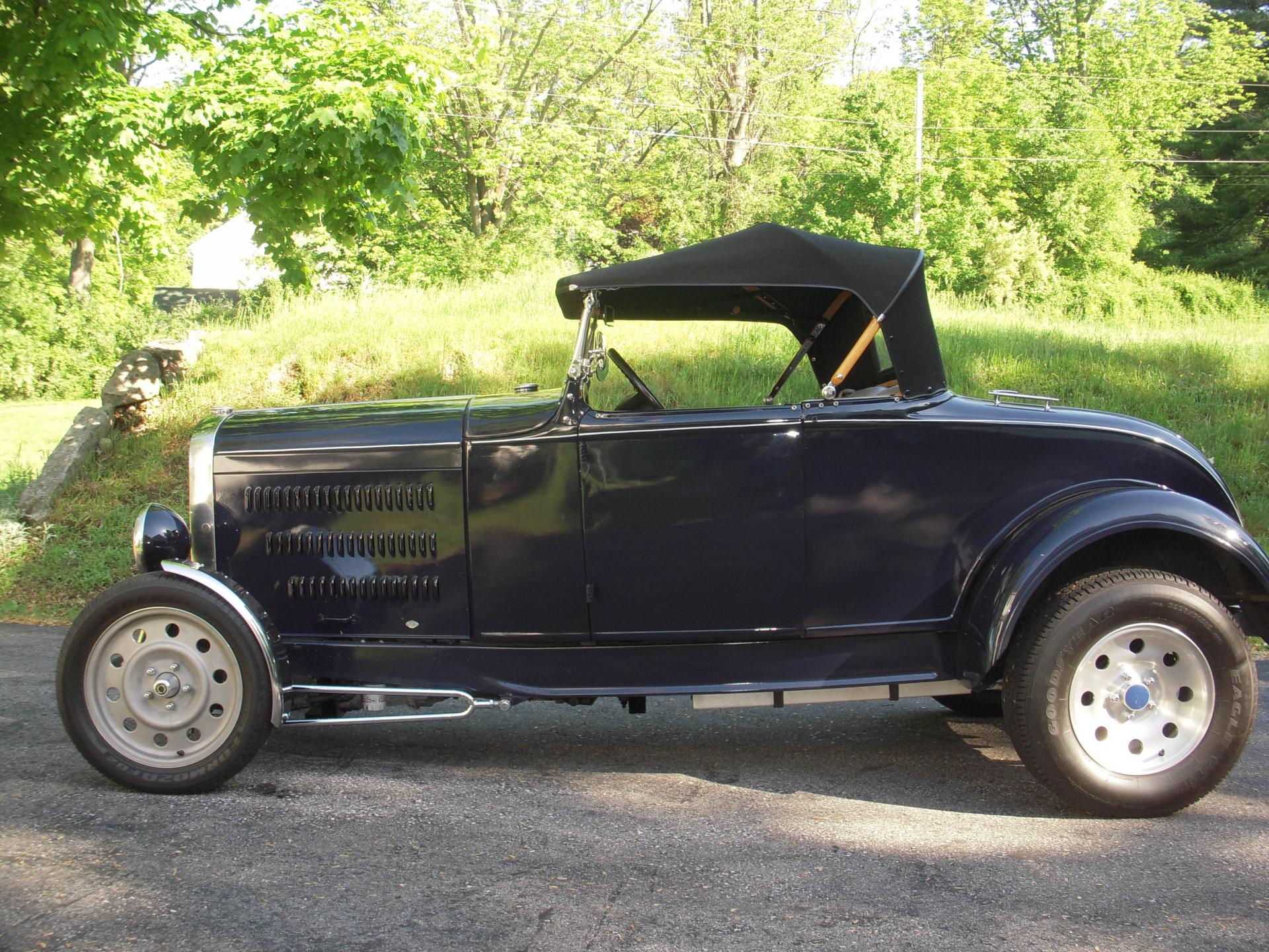

    I bought them all up, hoarding a set of 5! :eek:
    The rear pair are Ranger PU O.E.M. wheels.
    Fronts are Town car spares, 4" x 16".
    Ford's subtle, "Don't even think this is a wheel " stickers all over the spare rims.
    The '31 is built light as possible, w/an alloy block Ford Duratec 4-cyl.
    You'll want to inspect them faithfully, Esp. if considering a heavier drivetrain, or hard use.

  9. pitman
    Joined: May 14, 2006
    Posts: 5,148
    pitman
