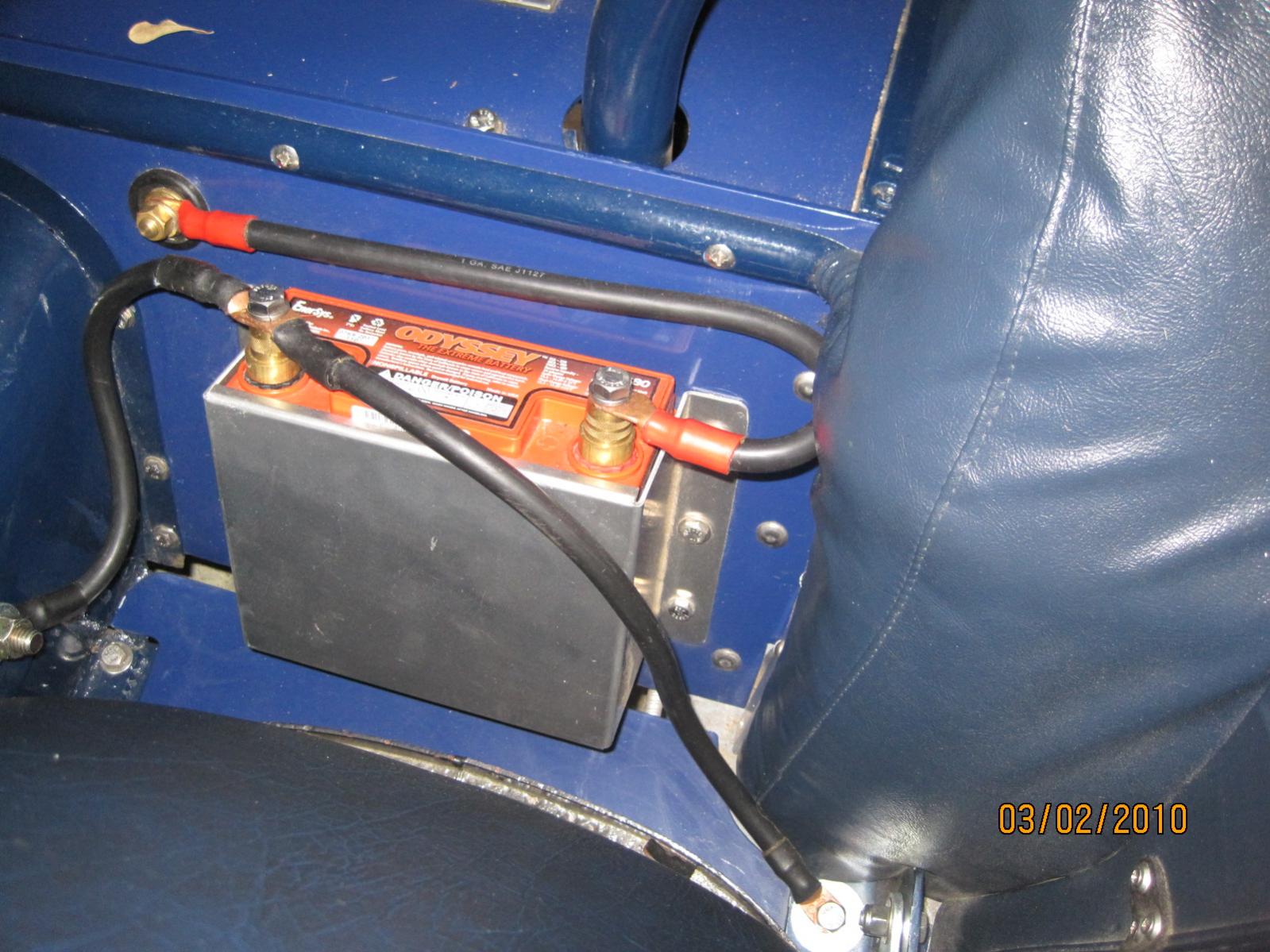

    Here's my optima mounted under the
    p***enger side of the seat in my truck.
    maybe you have room for something similar.
