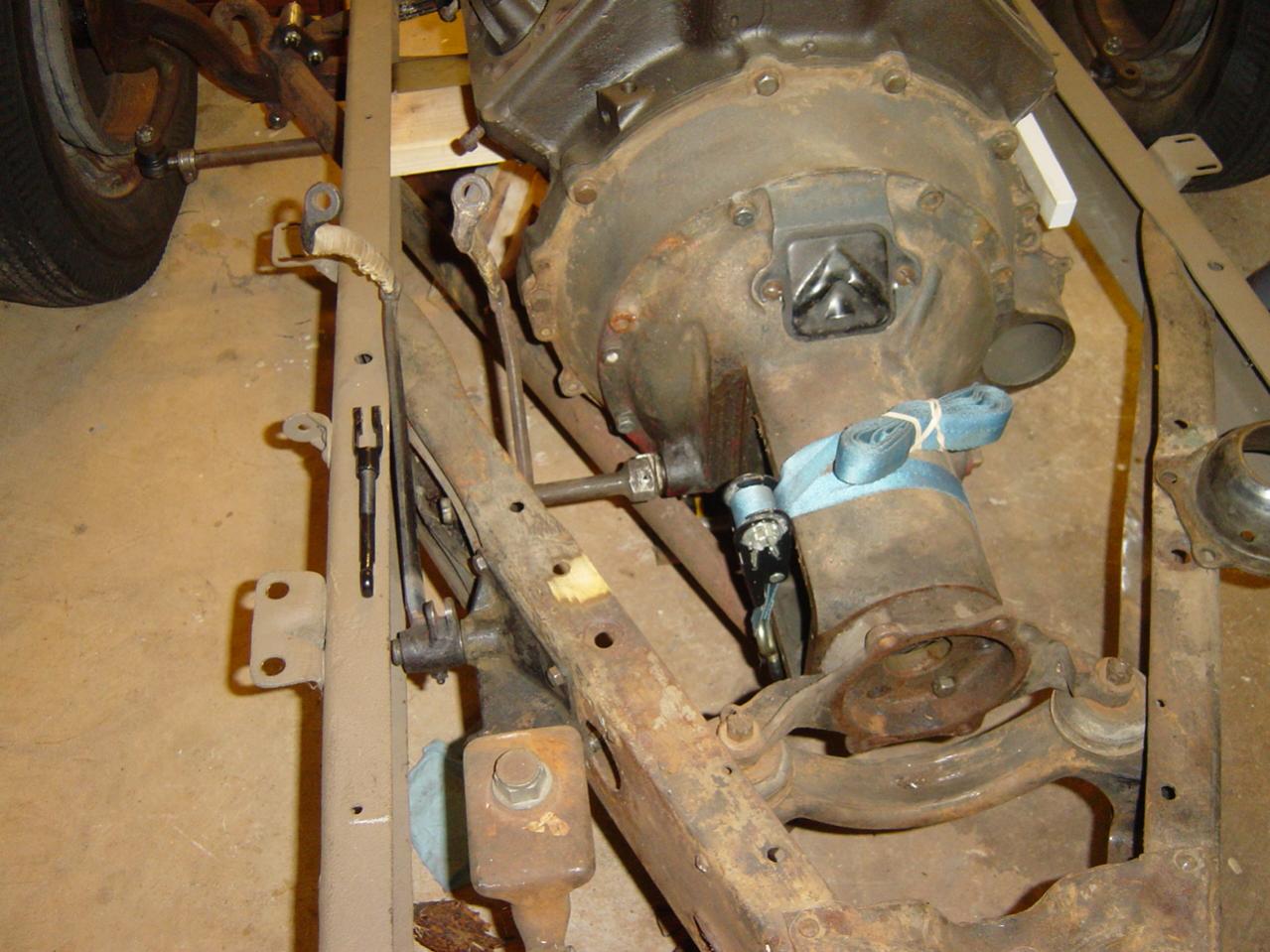

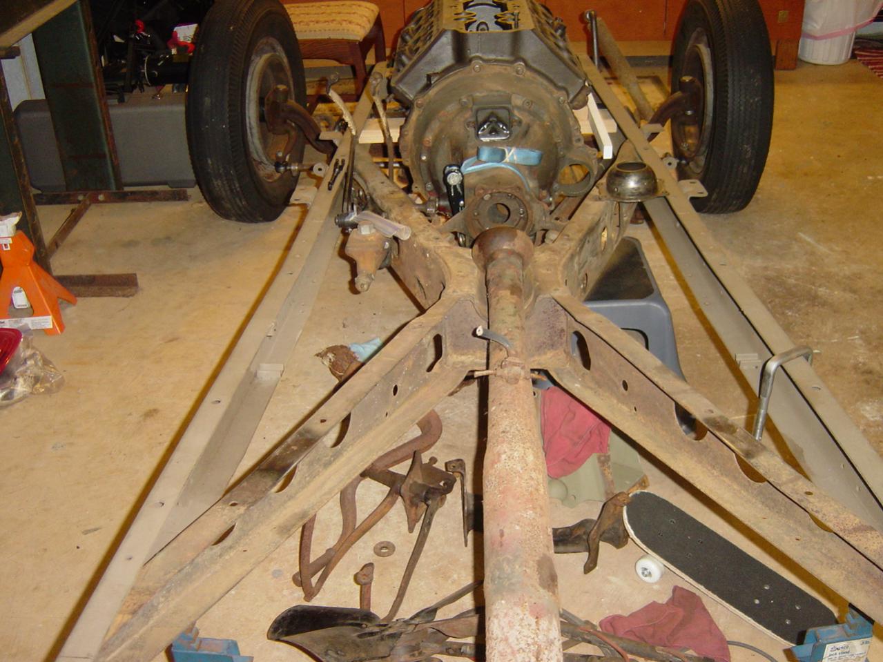

    That's what I did to my A Frame. Think I did it wrong though because the back end of the X sits too high and the rear of the engine is not level with the front. I need to go back rethink it. I took a pie cut out of the top side of the rear section of the X when I think I should have pie cut the bottom. I was looking to keep the X from hanging down low. It has kind of a "sag" in he middle. The front of the X I pie cut the top side, it's not real pretty right now but it should work when it's all sorted out.

    Thanks for the pictures. It gives me some ideas. I have a F1 crossmember but was thinking about going to the 40 Ford crossmember.
