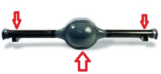

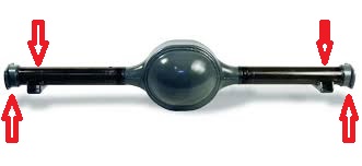

    Driving down the road, the loads and supports are close together. Wheel bearings to spring mount distance. The center of the housing doesn't see much load.
    On a centered jack there is more distance between the load and support, with a greater bending moment. Like breaking a stick across your knee.
    If that's enough leverage to create a permanent deformation depends on the particular housing and the weight of the vehicle.
    Denns1989 and XXL__ like this.

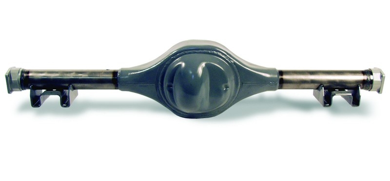

  29. Some Ford 9" housings will bend; I've personally experienced it...
    In the early '70s I had Art Morrison slightly narrow (about 4" IIRC) a 9" housing for me on a OT '70 Montego (this was when he was still working out of his barn in Milton). I was also doing some suspension upgrades at the same time, bigger sway bars and lowering it. He narrowed/straightened the housing, I reinstalled it. I also added a Addco rear sway bar. This bar attached to the housing, with the end links going up to the frame rails. This was a 'small end' housing, so the axle tubes necked down in size at the leaf spring end. Because of the taper, I couldn't get the bar mounts out towards the ends of the tubes as far as I wanted. I was assured by Addco this would be fine....
    At about 5K miles, I had a axle bearing failure. Ok, I replace the bearing. Another few K miles, I lose the other side. Now I'm wondering a bit, but go ahead and replace the bearing. I go through another couple of sets of bearings at about 5k miles or less each, there's definitely something wrong. Pull the housing, take it back to Morrison. He pronounces it definitely bent, can't understand how he screwed it up and straightens it for free. Reinstall it...
    5K miles, another bearing failure, with the other following shortly. Pull the housing yet again (and anybody who thinks this is easy...) and take it back to Morrison. Yep, it's bent again. Morrison says it's not his fault, it left there straight, and I have to agree. So after much discussion, we figure it has to be the rear sway bar. Pulling the bar off should cure it. He straightens the housing again (not free this time, LOL), reinstall minus the rear bar, no more bearing failures.
    So I do some research, looking for a different type rear bar. I discover that Ford factory bars on the leaf-spring cars are always chassis-mount, with the end links going down near the axle ends near the spring pads. And not all 9" housings are the same.
    This is the 'light' version. This type is what I had, and these will bend...
    This is the heavy version; considerably stronger, although under extreme use even these need to be braced. This is the housing Ford used on the later rear coil cars with axle-mounted sway bars. This type was also found under late full-size and all late big-block cars.
    One thing I learned is if you need a puller to get the axle out and have to work at it, the housing is probably bent. If you need to beat the axle in, it's definitely bent..... Very light beating, it's probably ok. Heavy beating, probably not... If the housing is dead-nuts straight, you should be able to pull/install the axles by hand.
