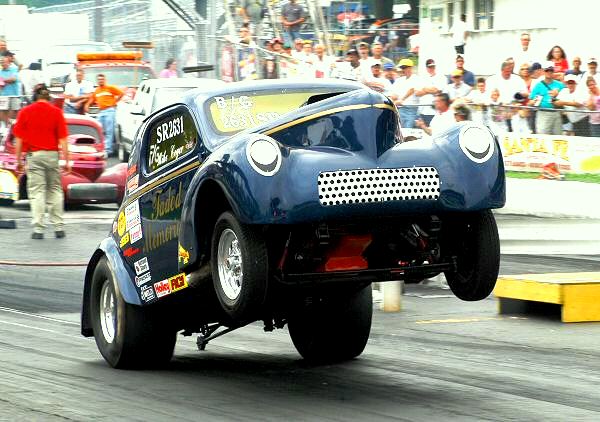

    I do know that 9 inch Fords will flex laterally . I pulled the chunk on my avatar and it had marks on the inside of the housing and saw were the ring gear had rubbed the inside back of the housing. Built a back brace and never had that issue again. That was after about 400 wheels up passes leaving off a 5800 rpm stall convertor and a transbrake with a 5.86 gear.
    I tried to download a video of the car , but it won't allow it . Would have been good watching for this morning. faded memories.jpg
