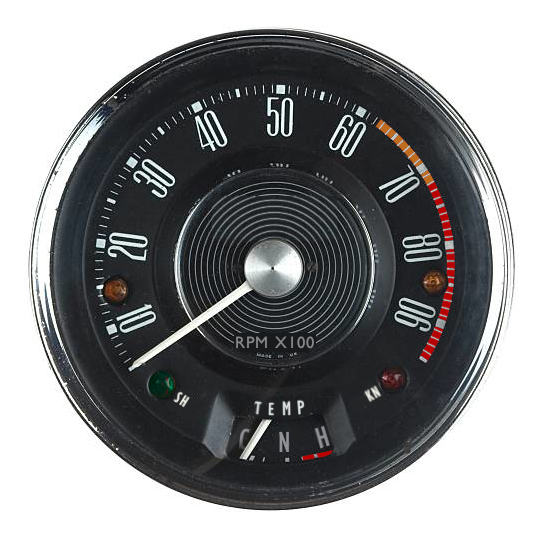

    I don't know if it takes a particular kind of weird brain, but I've discovered a fascination for instrumentation. I've spent pretty much all of 2023 thus far down a gauges rabbit-hole, and one thing which came out of a side tunnel down there was the similarity between magnetic/eddy-current speedometers and tachometers. And that got me to thinking that a mechanical speedometer can be used as a mechanical tach. It's just a matter of drive ratios.
    Why? Aftermarket electronic tachs are freely available, easy to hook up, and relatively cheap. The problem is the choice between an affordable 3¼" gauge which isn't too ugly and an affordable 5" instrument right out of the Fast and the Furious, with zippy graphics and disco lights all over it. Big + pretty costs money. At the same time there is a robust supply of old mechanical speedometers which are either not working because we've been told that they are something which can't be fixed without lots of money or a doctorate in clockmaking, or unsuited to the purpose at hand because they only read up to 90mph or less.
    Tach-drive distributors generally turn a tachometer cable at half the engine speed. At an input of 3000rpm, the tach will read 6000rpm, i.e. "60 RPM x 100" — or it should, if it's calibrated properly, and that can apparently be done at home if you know how. With some exceptions, mechanical speedometers are calibrated to an input of 1000 turns per mile, or 1000 turns per kilometre. At an input of 1000rpm, the speedometer will read 1 mile (or kilometre) per minute, or 60mph. Adding a reduction gear of 3:1 would allow a speedometer to read "60" at an input of 3000rpm, and so function as a tachometer. All you need to do is change "MPH" on the dial to "RPM x 100".
    So, we'd want a speedometer from a slower old car, because unless we're running a motorbike engine we wouldn't need a 15000rpm tach. Trucks and small-capacity motorbikes are other possible sources, but motorbike speedometers of that kind might not be any bigger than the nice 80mm chrome-bezel tach you can perfectly well afford. We'd want to delete the odometer, which may or may not be simple. We might gain all kinds of handy inset gauges and warning lights, which we may or may not want to put to other purposes.
    I had a go in Gimp:
    I used a pic of a 5" Smiths speedometer of the kind found in early Minis and mid-'60s Morris Minors. Like a lot of Smiths speedometers it takes an odd TPM input, in this case 1408TPM rather than 1000TPM. That means that we'd need a 2.13:1 reduction gear rather than a 3:1. The indicator repeater lights in the face have been retained, as they'd be handy in a prominent tach, but the ignition and high-beam lights have been repurposed as a shift light and a knock-sensor light, respectively, driven by little homebuilt stand-alone circuits.
    Fun fact: Smiths fuel and temperature gauges are internally identical, so the one can be used as the other just by changing the faces. Both are effectively voltmeters. Here, the original fuel gauge becomes a temperature gauge. I wonder if this is true of fuel and temperature gauges from other manufacturers.
    Now: how about an easy way to do the reduction gear?

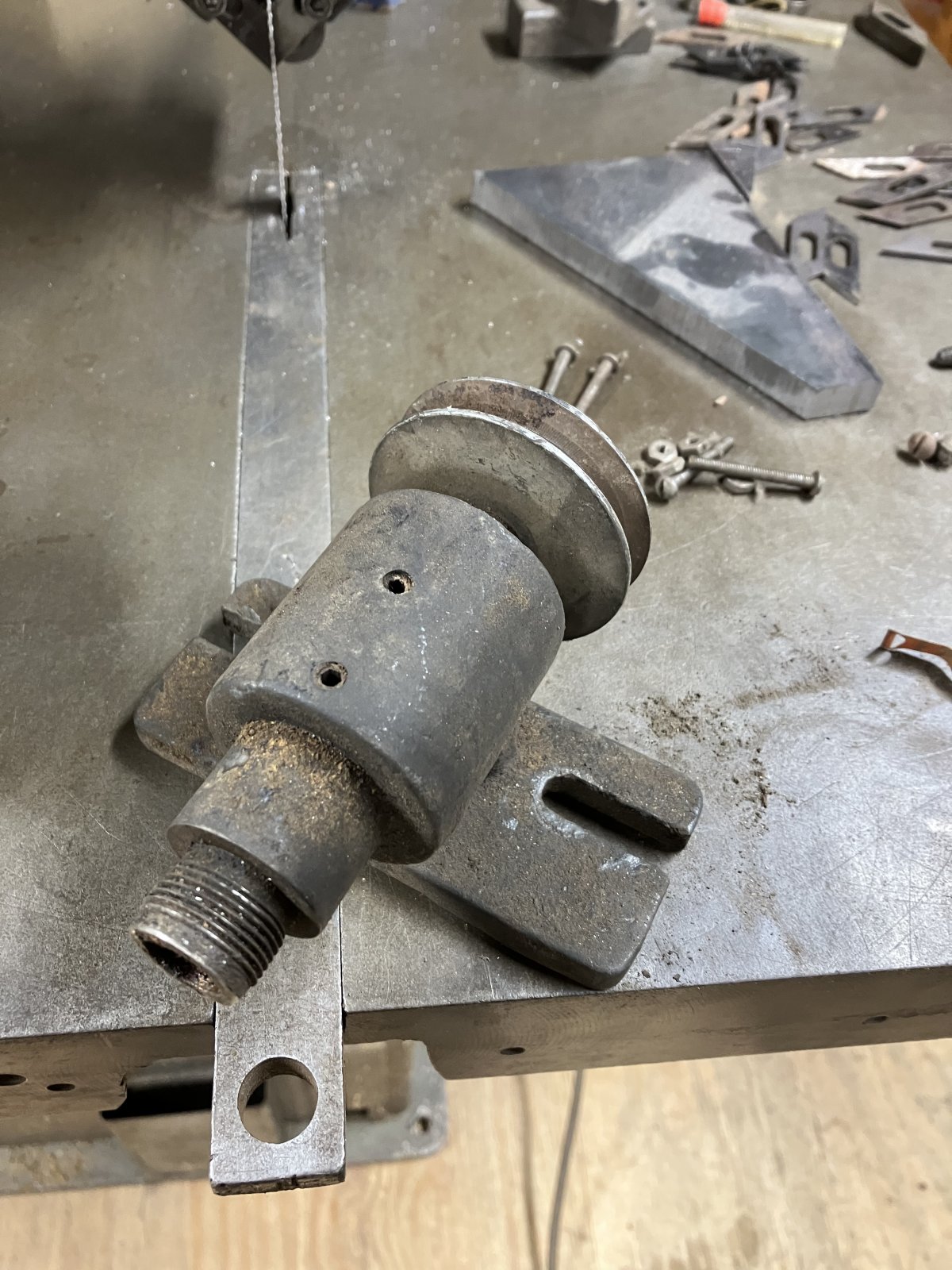

    C67619CB-9BD9-4083-98A2-7846D6D17A26.jpeg 5941E6DA-B5A1-49BB-8F93-10DFE1F24CC6.jpeg This is from a bandsaw, I hope to use it on my flathead someday
    At least the cable drive

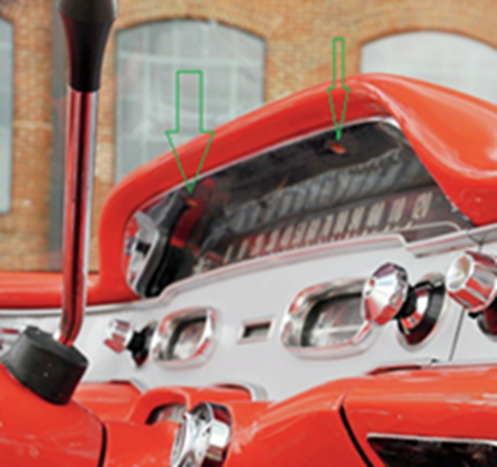

    upload_2023-1-25_3-8-20.png Almost half the size of a chrome Sun Tachometer...
    When the 58 Impala was now my car, at the insistence of my friends with their shiny tachometers on their dashboards, the small black tach that fit nicely under the lip of the dash, over to the right side of the speedometer. It covered the 120 mph mark, but at the drags, the 120 needle was pegged at the start and was useless. On the street, no one goes that fast...
    The Green arrow placement, was an out of normal driving, front road vision, location. Nicely tucked under the dashboard lip. No harmful additional holes were added for the installation.
