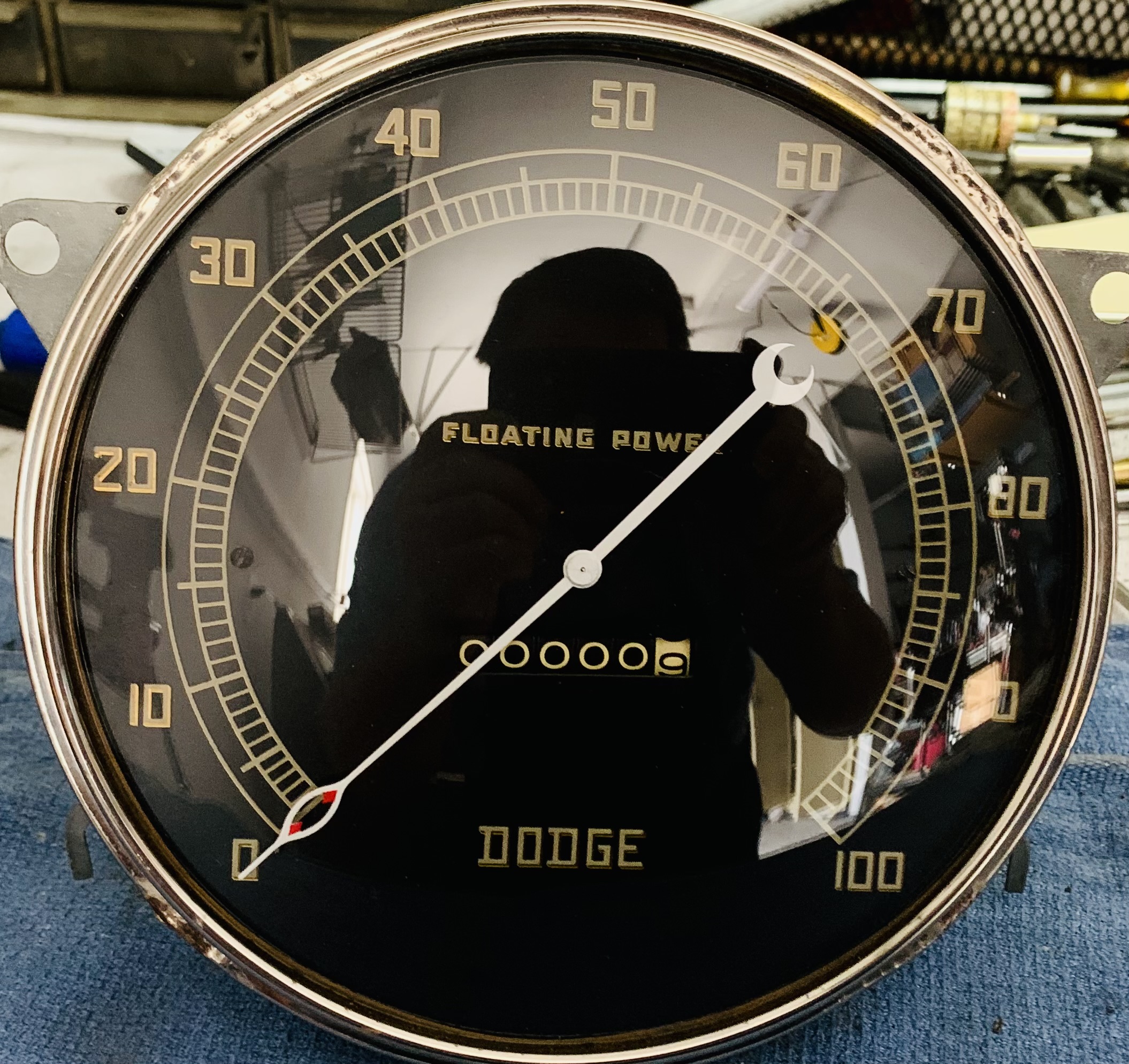

    sorry I can't help you with the technical side but here is a picture of a mechanical tach Pat Swanson made for me out of a speedometer like the one on the right.
    he did his magic with all but the face
    that he had someone else silk screen.
  10. nrgwizard
