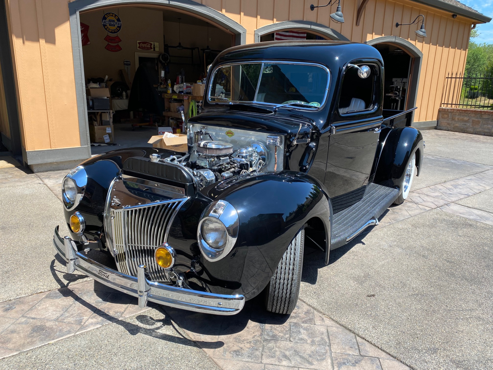

    On my '40 pickup, we used Raptor, goes on like paint, looks great. Did the underside of the floor as well. IMG_9931.JPG IMG_9937.JPG IMG_9945.JPG

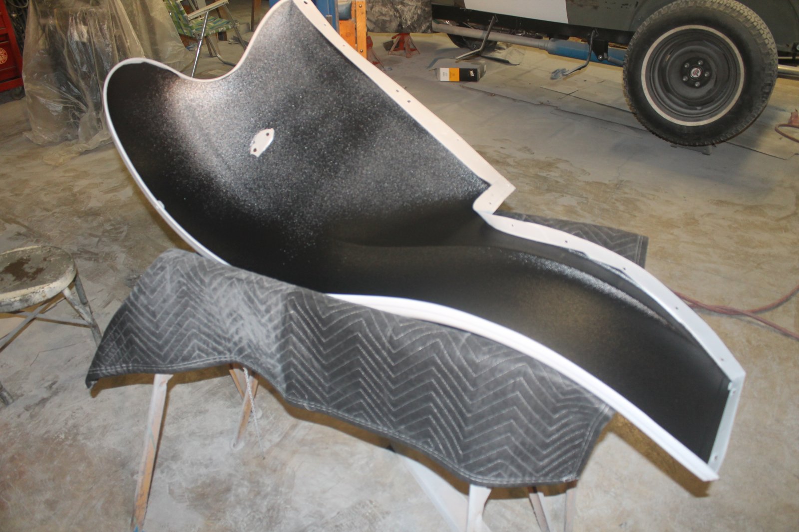

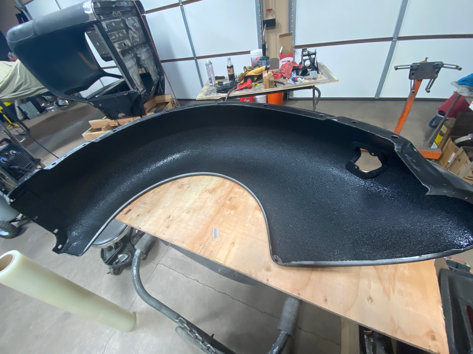

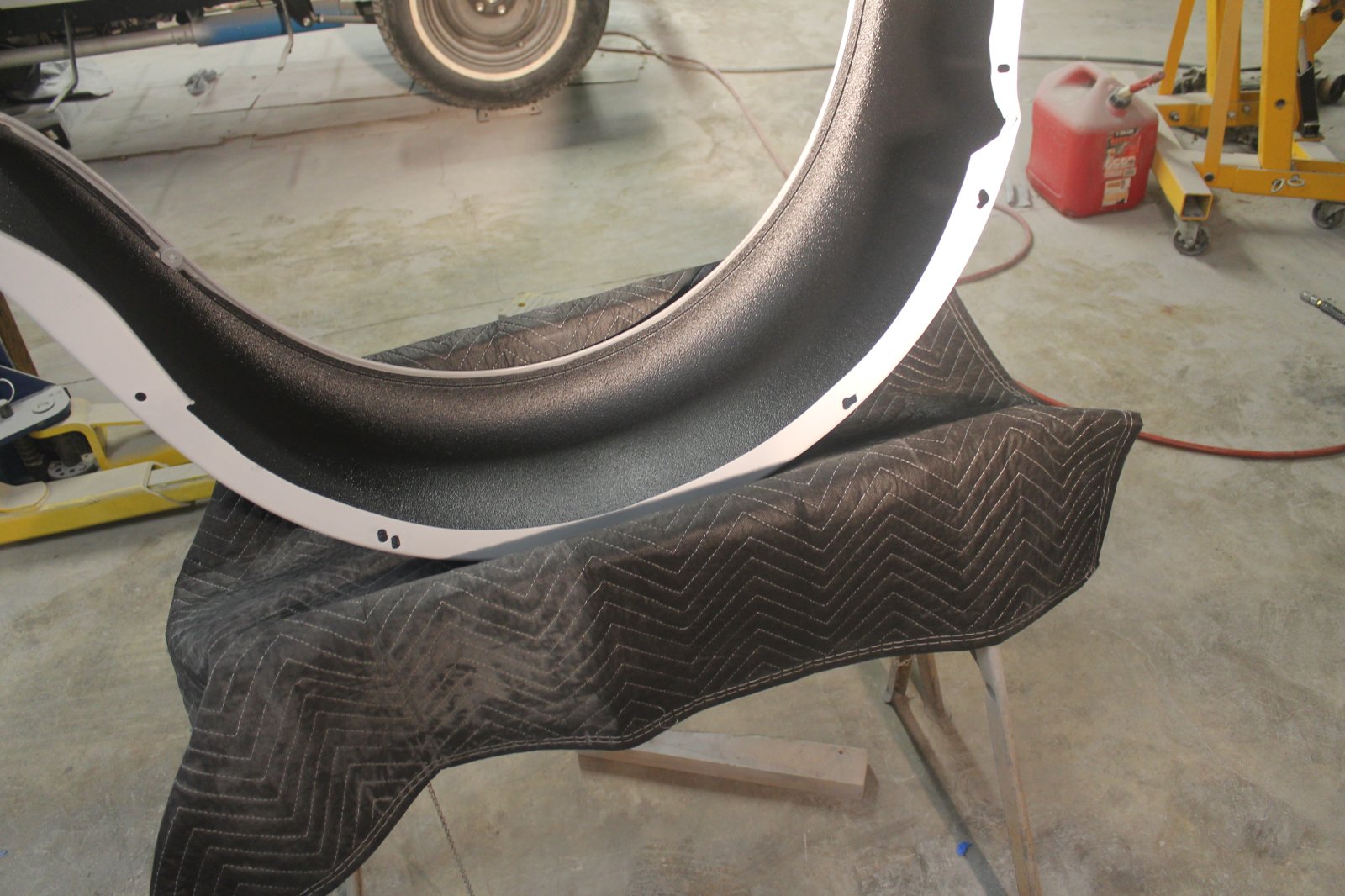

    I finally got around to spraying the bed liner on the fenders. I used the Raptor brand that uses a hardener. Like most things, preparation was the biggest part of the work. It is a lot easier to spray than paint. One more fender and I get to start body work on the 1/4 panels and the cowl. I just hate body work. IMG_1573.JPG IMG_1574.JPG IMG_1576.JPG
