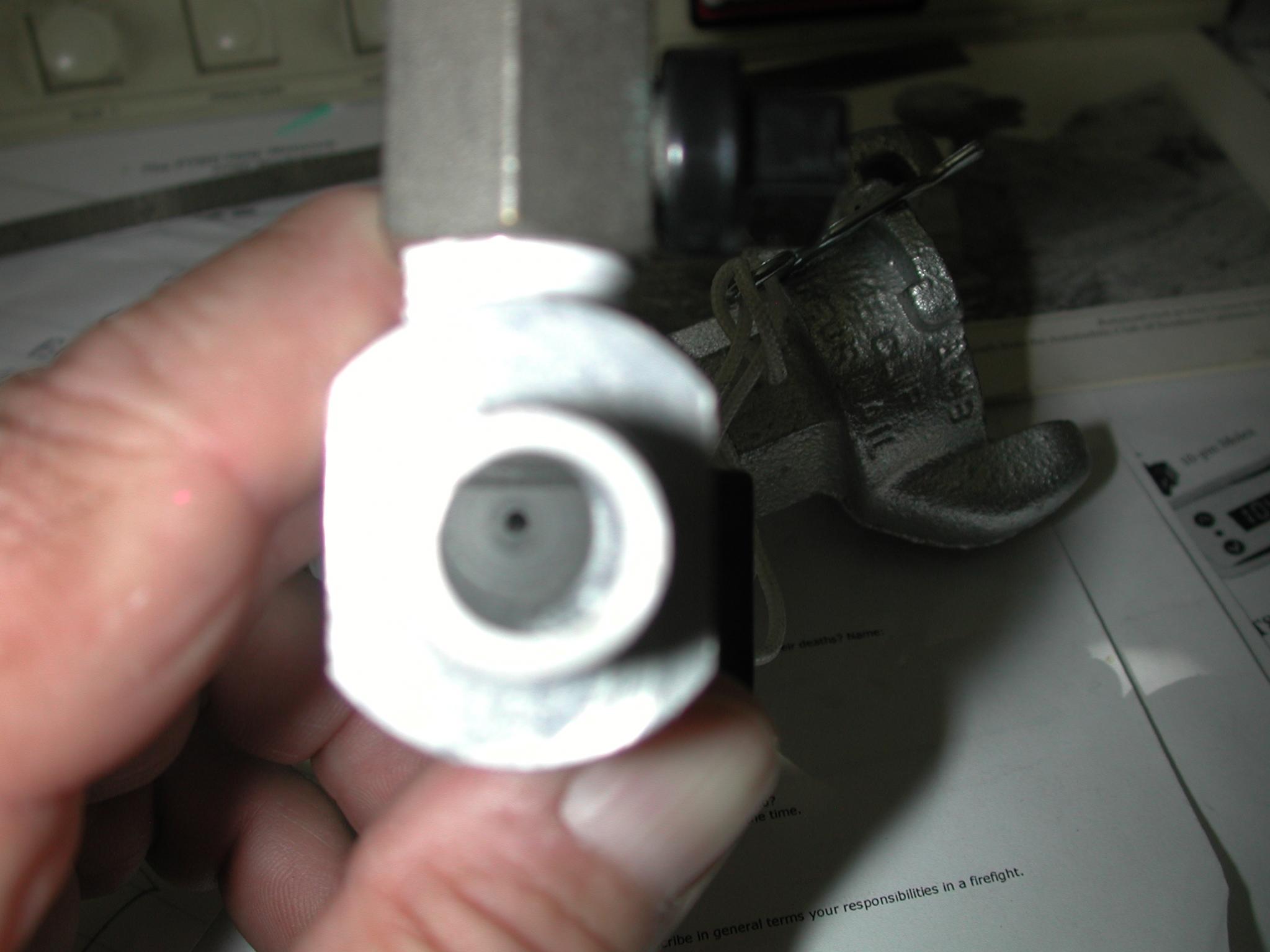

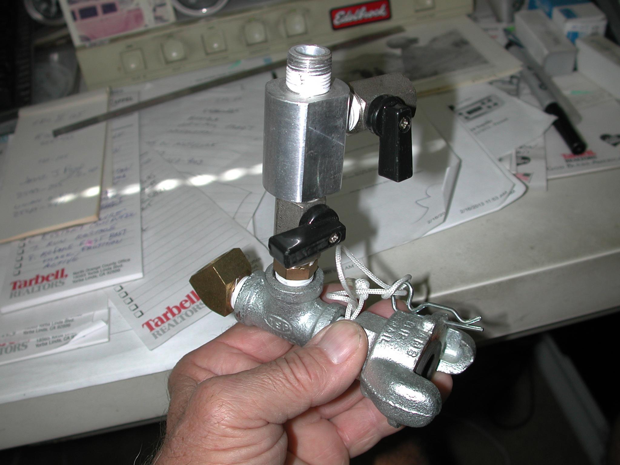

    tox, I did just the opposite of what you are trying to do (sand to soda) As 1955 says you could probably get the sand setup from Eastwood, but you can make it yourself probably cheaper with just a nipple, tee, and ball valve in place of the Eastwood soda tee/oriface arraingement. You don't need the special oriface tee with the sand setup just a ball valve to regulate it.
    Hotrod, the ceramic oriface sizes in the gun don't matter as long as you have enough cfm to run them. My compressor puts out about 10cfm and about an 1/8" nozzle in the gun is about the max I can use without starving the compressor.
    here's a couple pics of my soda setup, I rigged up the quick disconnect chicago coupler and fittings so I can disconnect my blast hose easily to switch between soda and sand set up. Hope this helps.
