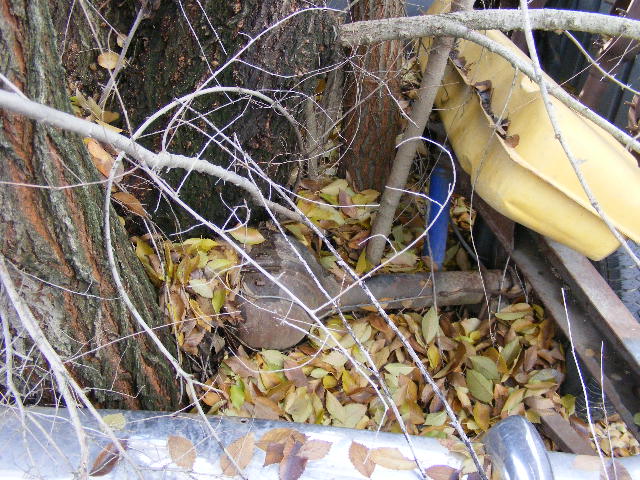

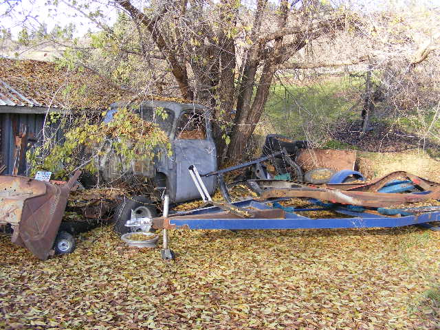

    from Wa.St.
    This old Chevy P/U was parked here in '91 after a Chevelle front end swap and a '57 '59 9" Ford Wagon rear. Trying to decide if I like the tree more than the 9" or save the 9" and plant a new tree! Maybe Ford rears do grow on tree's!
