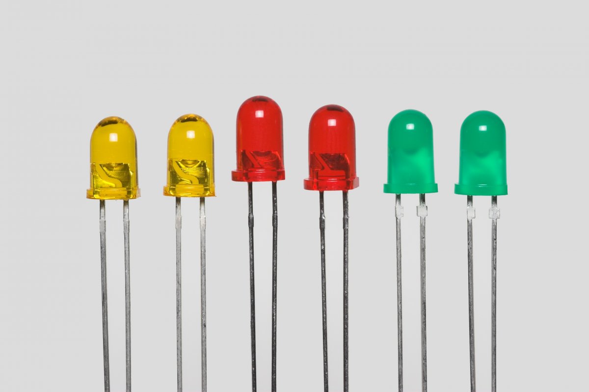

    Basic wiring diagram-
    The LED has 2 legs- Anode (+) and Cathode (- ). The Cathode is the shorter lead ( you can't see from the picture, but one is slightly shorter), and has a flat area on the housing (have a look at the fourth red LED in the pic, on the RHS, you can just make it out.
    Wire them up just like in the lousy sketch- if they are supplied backwards they wont light up. If you run 12 volts, use a 470 ohm resistor (1/4Watt), for 6 volts you can use 330 ohms. (R)
    This will give you a forward current of about 20mA. If you happen to put 12v straight across the LED, make sure you have your safety gl***es on, as it will instantly overheat, and may physically explode. As mentioned above, some already have a limiting resistor inside.
    These things are cheap, grab a handful, and some resistors, and have a fiddle around with them. There are many colours available and they can be used in lots of places in a car.
