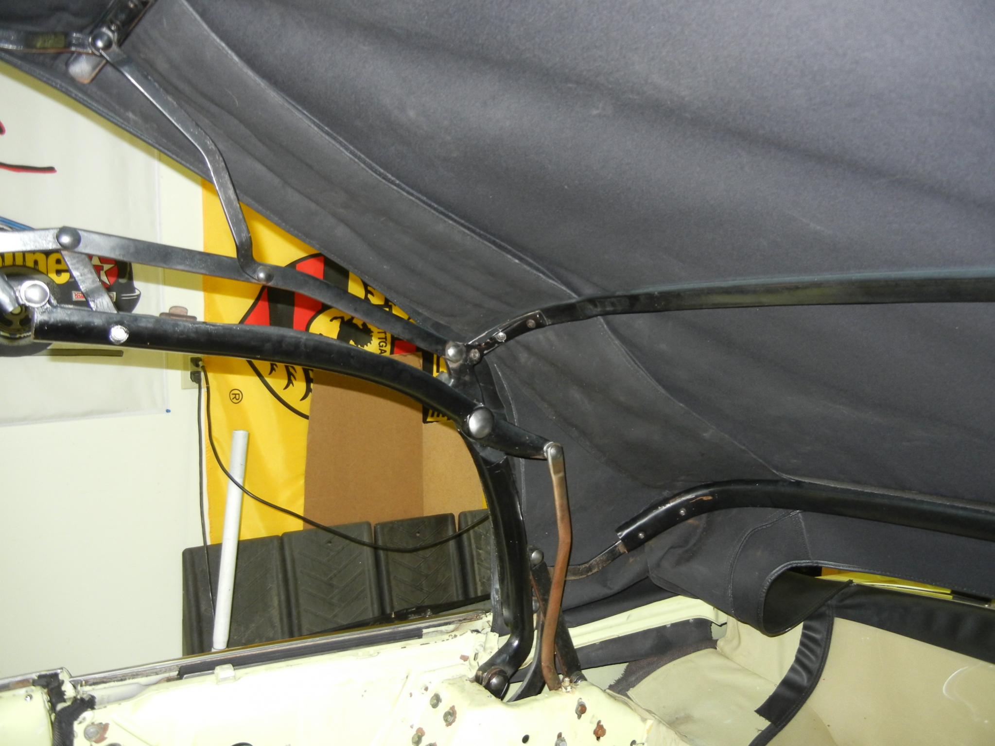

    Any thoughts here...convertible top part for a 53 Merc

    from pgh. pa.
    I would fabricate that out of steel.
    Ago

  22. Merc cruzer
    Joined: Feb 26, 2009
    Posts: 286
    Merc cruzer
    from Colorado
    Are you talking about a billet of steel and files?
  23. ago
    Joined: Oct 12, 2005
    Posts: 2,198
    ago
    from pgh. pa.
    Yes, steel. cut,saw,weld, grind,
    Ago
  24. Merc cruzer
    Posts: 286
    Merc cruzer
    from Colorado
    Made a crude one out of barstock until I can get my hands on a real one.....I don't have the talent or the tools (weld) to make one from scratch. The one painted tan is the good one on the driver’s side the temp is the one on the p***enger’s side.
