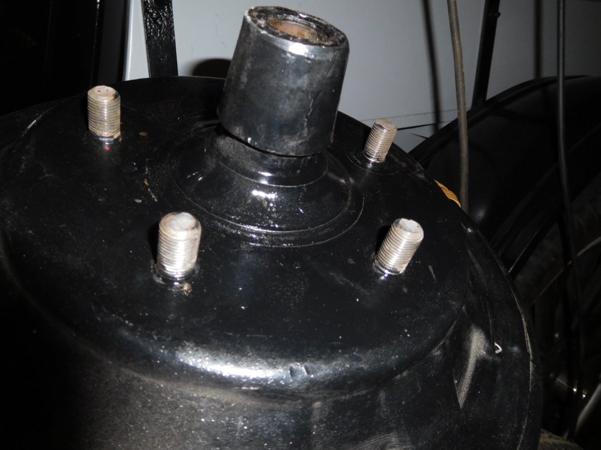

  1. I don't understand all I know about this. I'm trying to put '35 wire wheels on 40's hubs. I bought the spacers which everyone says you need for this application, but I can't see what good they do. The hubs have a flat surface, like this:

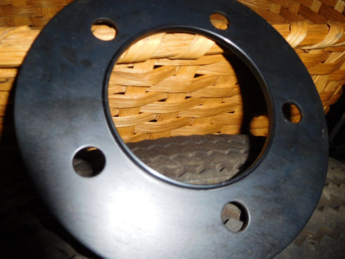

    And so do the spacers:
    The wheels have a "bump" outboard of each lug bolt hole.
    So if I don't use the spacers, those bumps bear on the flat face of the hubs. If I do use the spacers, the bumps bear on the flat face of the spacers, only 1/8" farther out. I can't see what the spacers accomplish, other than effectively making the lug bolts shorter. Can someone please explain what I'm missing here? Thanks for any insight.
  2. Charlie -- Thanks for that link. The first picture in your post from back then cleared it up for me. The ridge on the Model A hub (with the arrow pointing to it) showed me what these spacers accomplish.
    And thank you for not saying, "This has been covered before. Do a search, Dumbass!" as some folks do. That never helps anyone.
    I guess I need to go shopping for some longer lug bolts. :) A post after yours in that thread mentions Dorman part no. 610-234. I reckon that's what I'll be looking for. Right?
    Thanks again,
    Mike.
