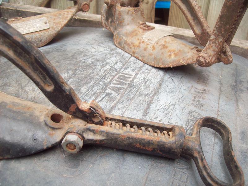

  2. Good idea, reminded me i had a few up in the attic. Just found them and made a few photos. These are 1950s . Built to last.

    With that long handle for leverage when closing it it almost doesn't matter how worn it is, you won't need a hammer like a modern stamped coupler. Shame it only attaches with two bolts though, that really limits it.
