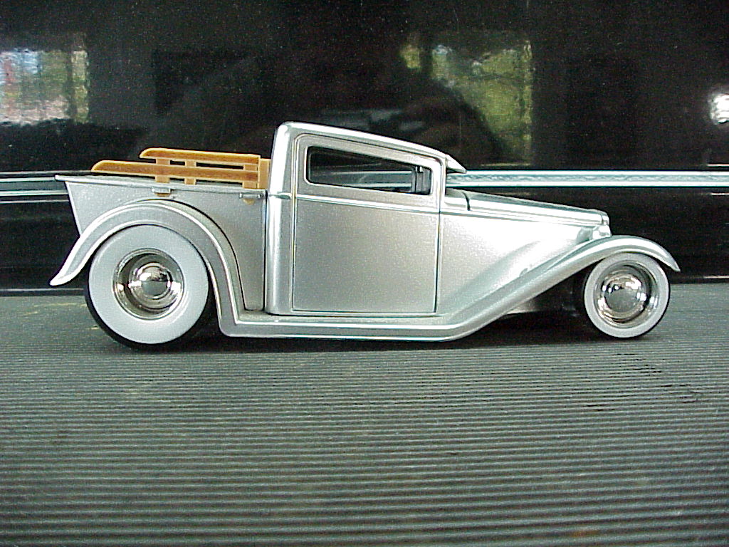

    The motor and trans is going into a '32 Ford truck. A friend of mine gave me this model of the truck. after looking at it and measuring it to see what would have to be done I decided to build it. It is stretched 6 inches in front of the cowl. I thought it would look funny with a V8 flathead and since the V12 is about 6" longer than a V8 it would fill the engine compartment nicely.

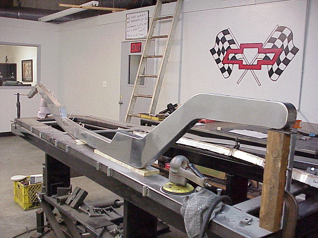

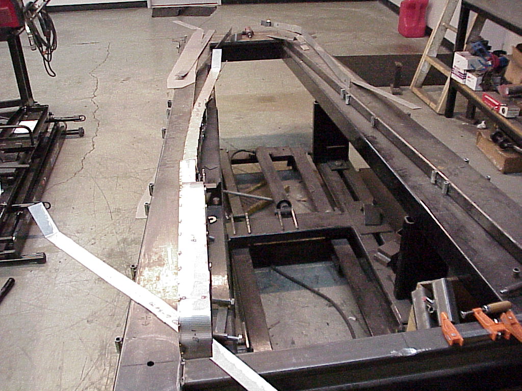

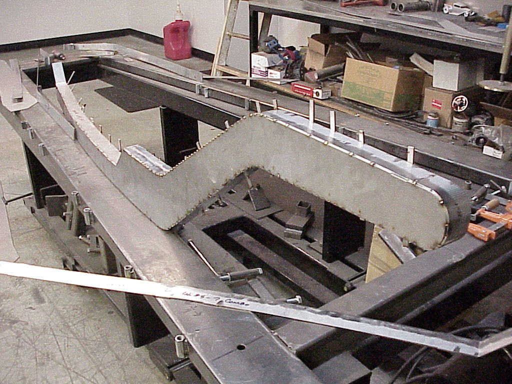

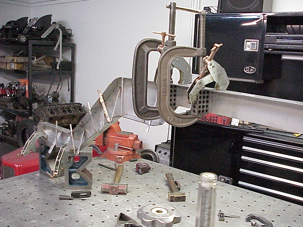

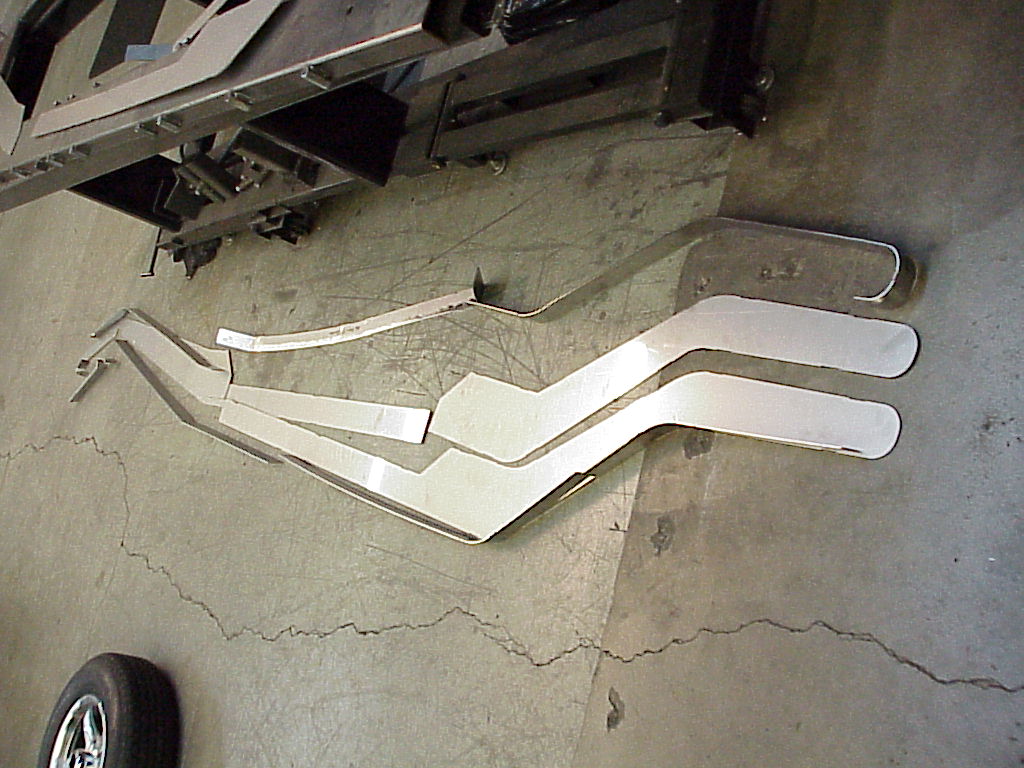

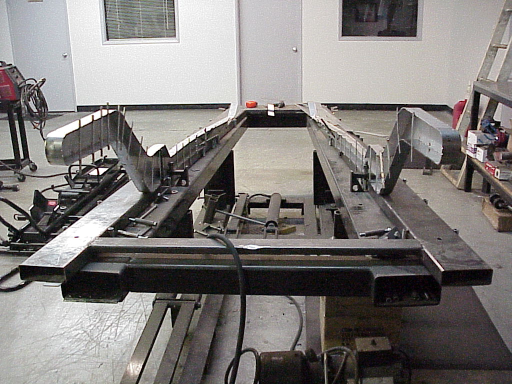

    Sure I take lots of photo's. This is the beginning of the frame. I had it lazar cut, each frame rail is made out of 12 pieces then welded together and hand filed to look like it is one piece. It took 3 months to complete the rails.

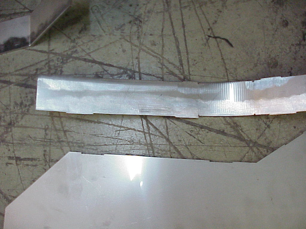

    I thought I would show more of how the frame was made and how I got the front and rear spring done.This is how it looked when I got it back from the lazar cutter. The second one is what it looked like as I started grinding and filing.

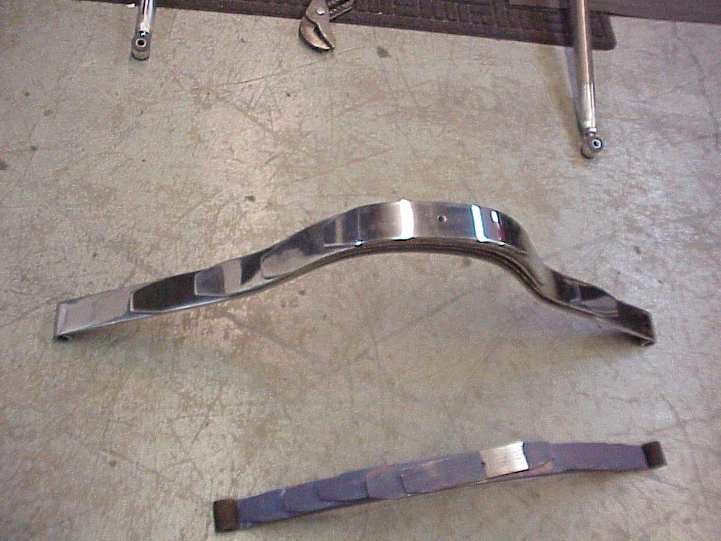

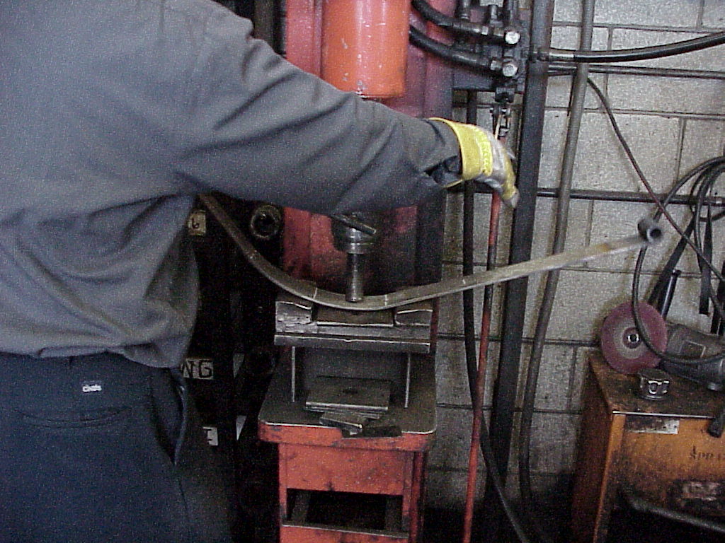

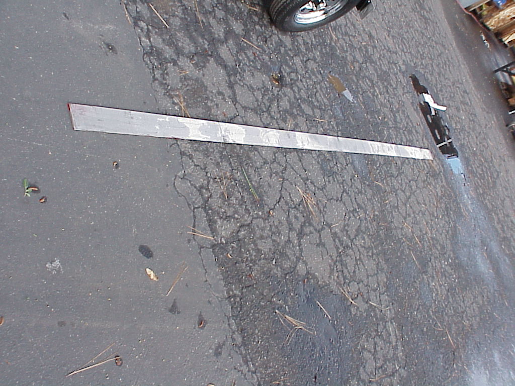

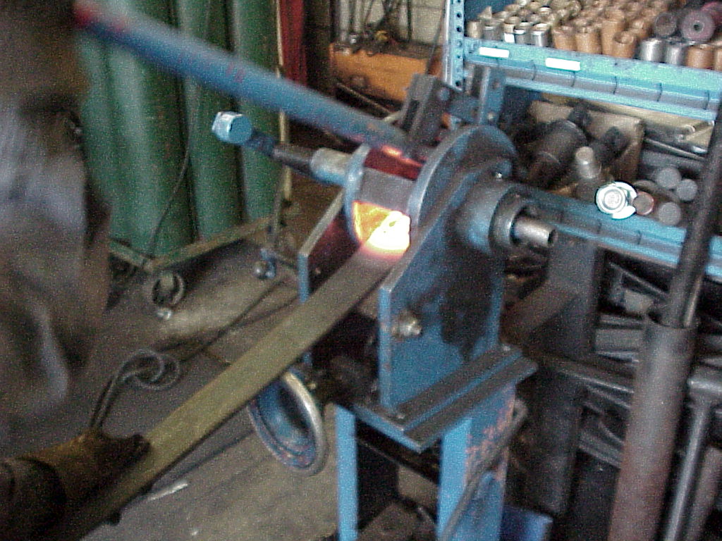

    The next is how the springs were made. After finding a spring company that would even talk to me I know now you can make any configuration you need. You can have any spring rate you want and any dimension you need, it really is a way to tailor your quality of ride. First I got a piece of flat bar stainless 1/4"X 4" and had it sheared it at 1 3/4 wide for the front spring so it left 2 1/4 width for the rear spring. Then took it to the spring shop and he cut and bent it to the configuration I needed. He did it while I waited. From there I went to the heat treated. When I picked them up the next day the were purple from the heat treatment. I took them back and polished them the best I could before I sent the to a real polisher. Now I had no idea on how or if this would work, I was referred to a spring company in Fresno Ca. His company makes SS coil springs. I told him what I wanted to do and he told me what type of material to use and what the heat treating should be, all I really did was go shop to shop and to get it done.
