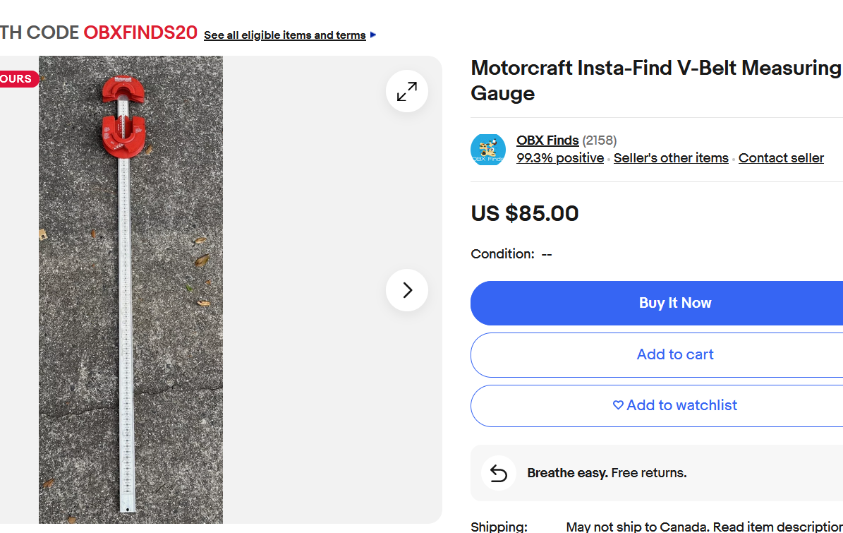

    I've had 3 different times and different people not no how to use a belt length gauge at the parts store.
    Like Squirrel I know how to read the numbers. If I 'm looking for something longer than 7530 I know to get a 7550 or 7560. Just had to yesterday.
    Those length's are 53 ,55,56 long.
