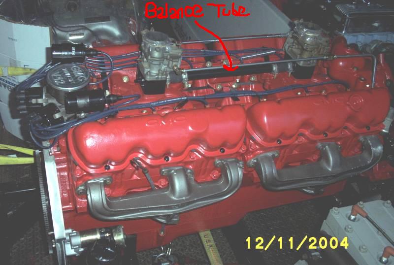

    Can you elaborate on the balance tube? Your reasoning and how you did it.

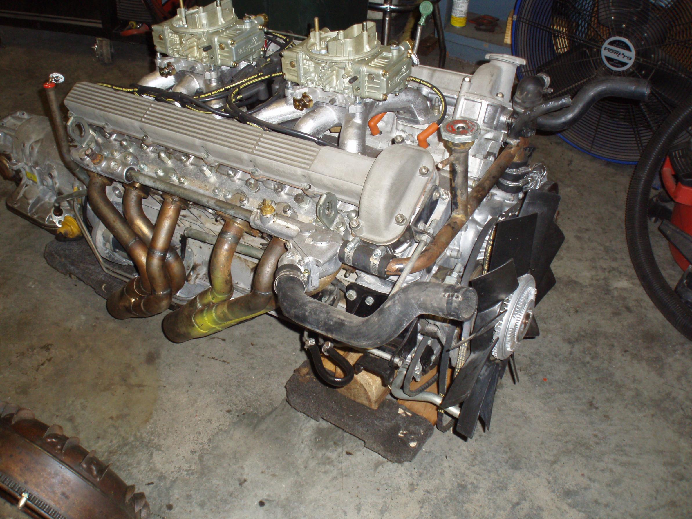

    Has anyone found a header set for this engine?

    The balance tube is just a 1" tube that connects the two plenums to help even out the intake pulses. I drilled and tapped the bottoms of the dual quad intakes and ran the tube in the valley around the bottom of the distributor.

    I bought my headers from a guy named Chadbourn Bolles on this forum.

    Thank you MUCH for the pictures! BTW... I'm also getting ready to fire up a GMC V12 on the stand. Is that one yours?

    Do you have a picture of your Jag motor with the intake/carbs installed?
    Untame
  12. Locomotive Breath
    Joined: Feb 1, 2007
    Posts: 710
    Locomotive Breath
    from Texas
    Here ya go.
