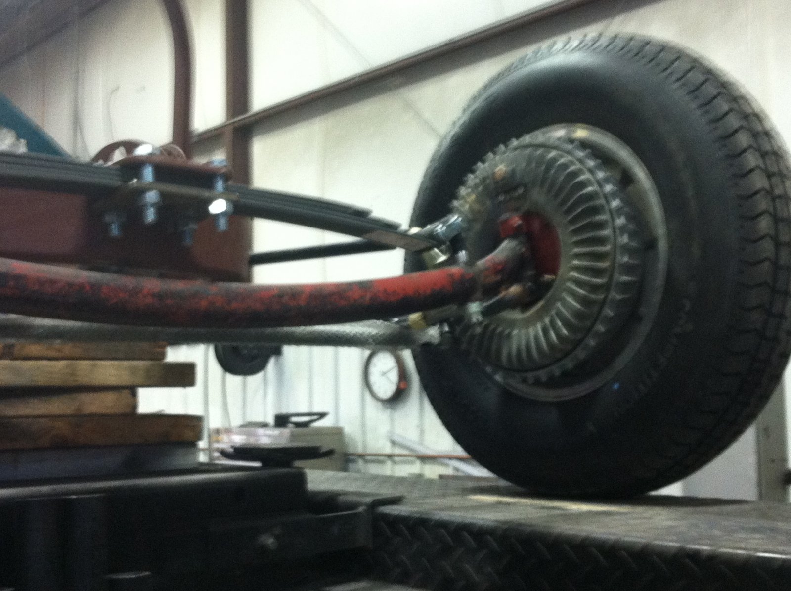

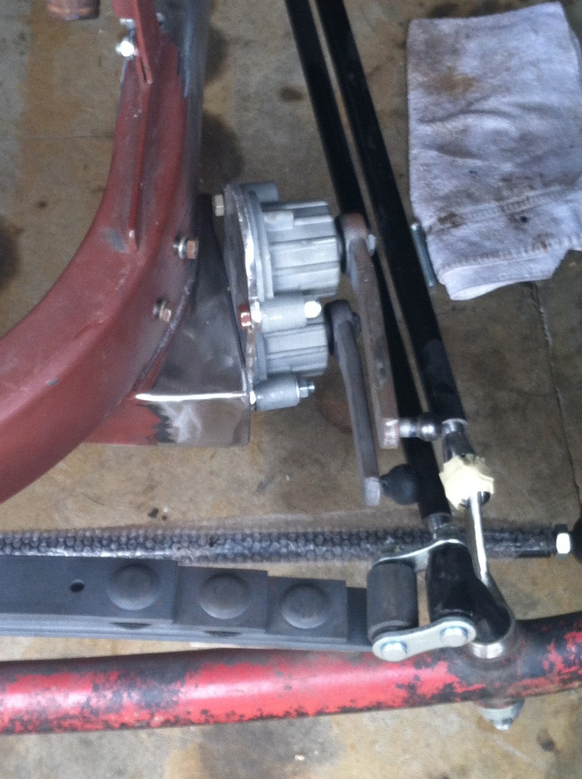

    Very nice work! Offten one side of spring{rightside was mounted with out a shackel/called a deadprech{ this was so a panhard type bar was not needed] ,also at the center of spring there were wedages put in for adjustmint=****ed spring more lbs to right. The photo exsample showen of a rear end post#30/has locator bars mounted to frame wrong{ should not be flat on frame end of bar,but up n down like axle end of bar if that type of set up is used.

  8. Sprinters like dragsters or Indy cars or you name it got/get tuned per track conditions. Different suspension setup, tires, even gears and engine tune.
    Doesn't mean that you car can't or won't stay static in its tune, that is entirely up to the usage of the car.

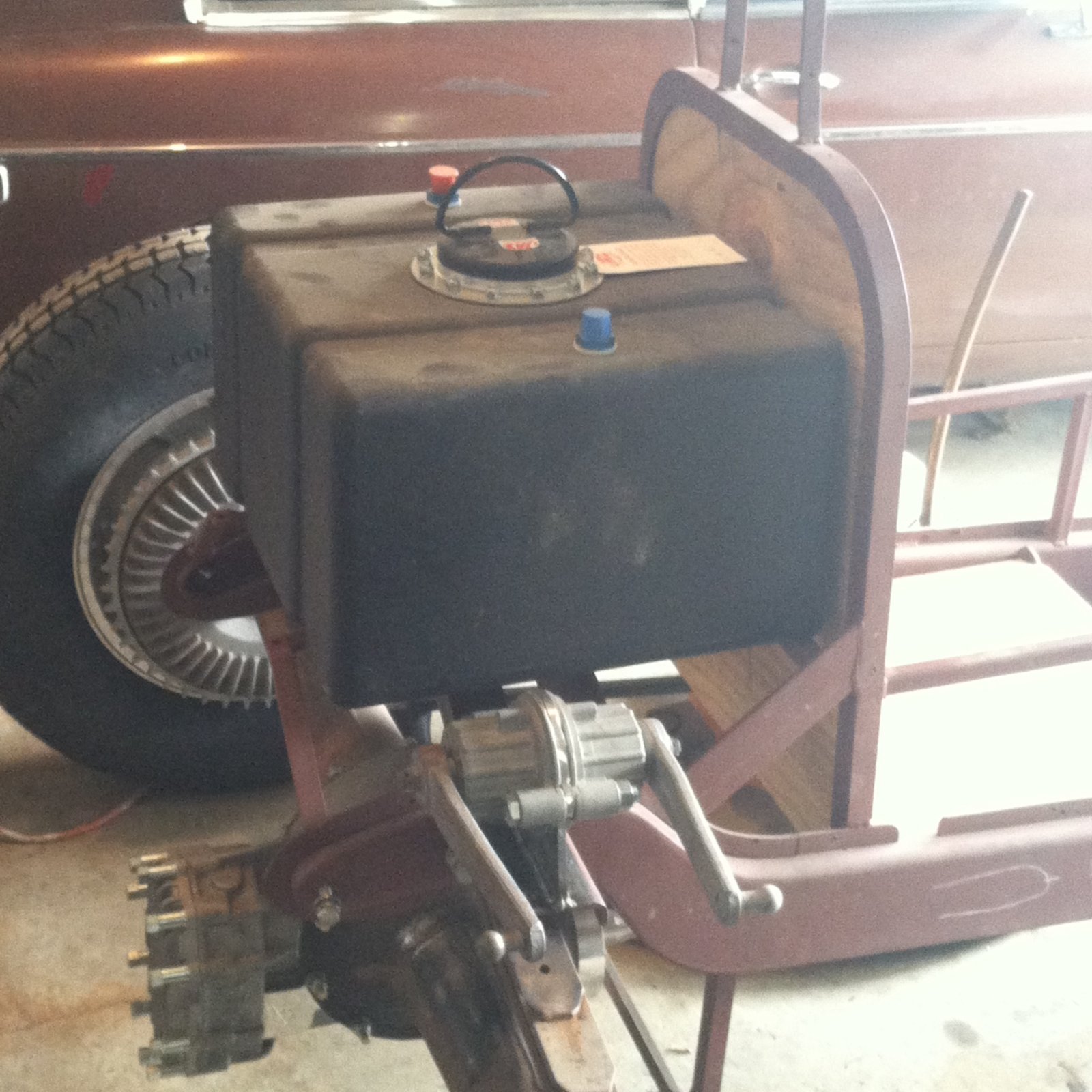

  9. RAREBIKE
    Joined: Oct 17, 2006
    Posts: 665
    RAREBIKE

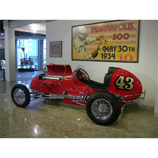

    Picture is of the rear end of Speedway Motors Tribute T, this will be a street driven car not a race car. Just wanted something different to show up in at the local car show.
    dana barlow likes this.

  11. I kind of guessed by the brakes that you were going to drive it. I think the multiple shocks are cool by the way. It should make people guess and that is almost always a good thing. ;)

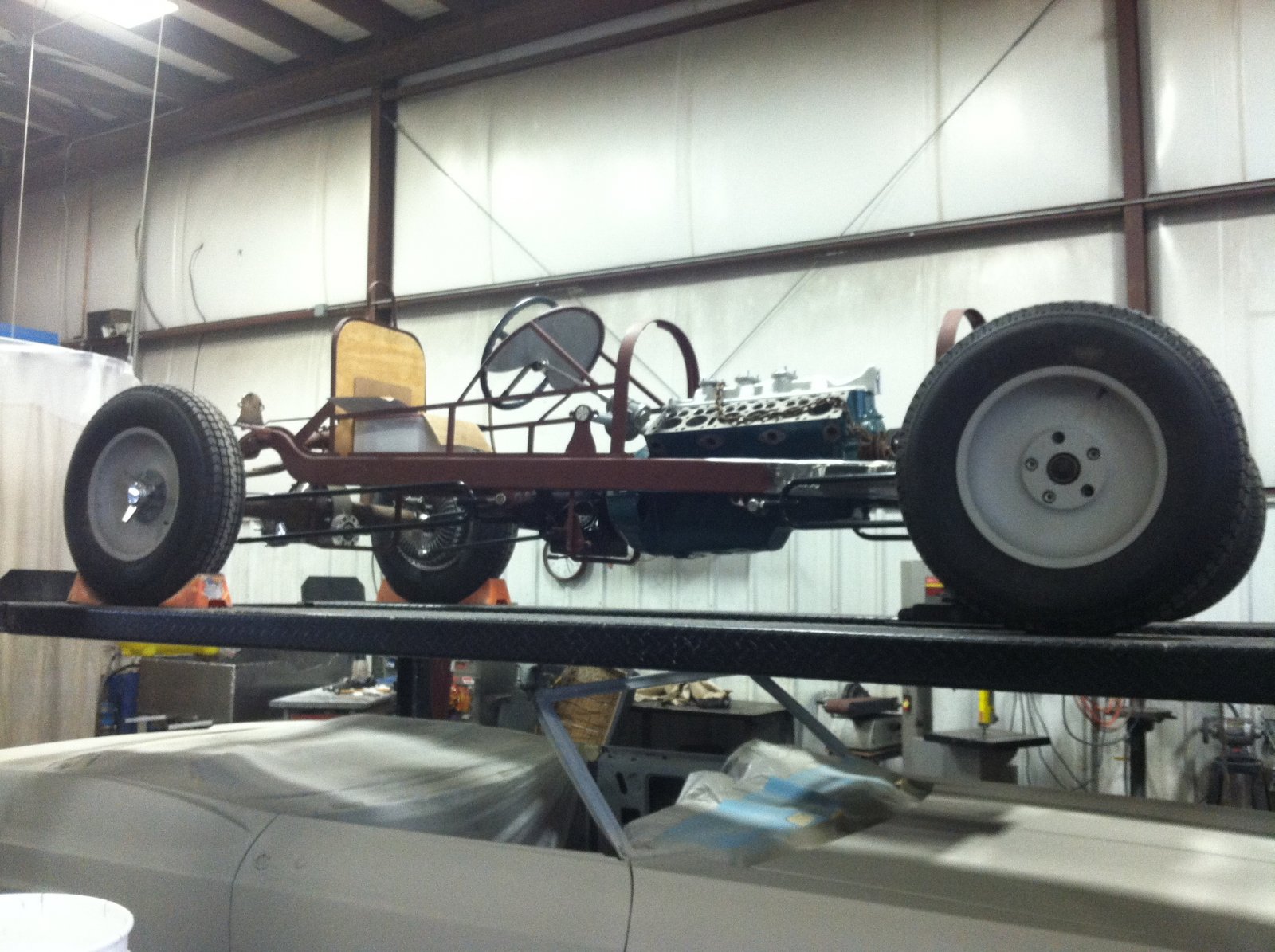

  16. RAREBIKE
    Posts: 665
    RAREBIKE

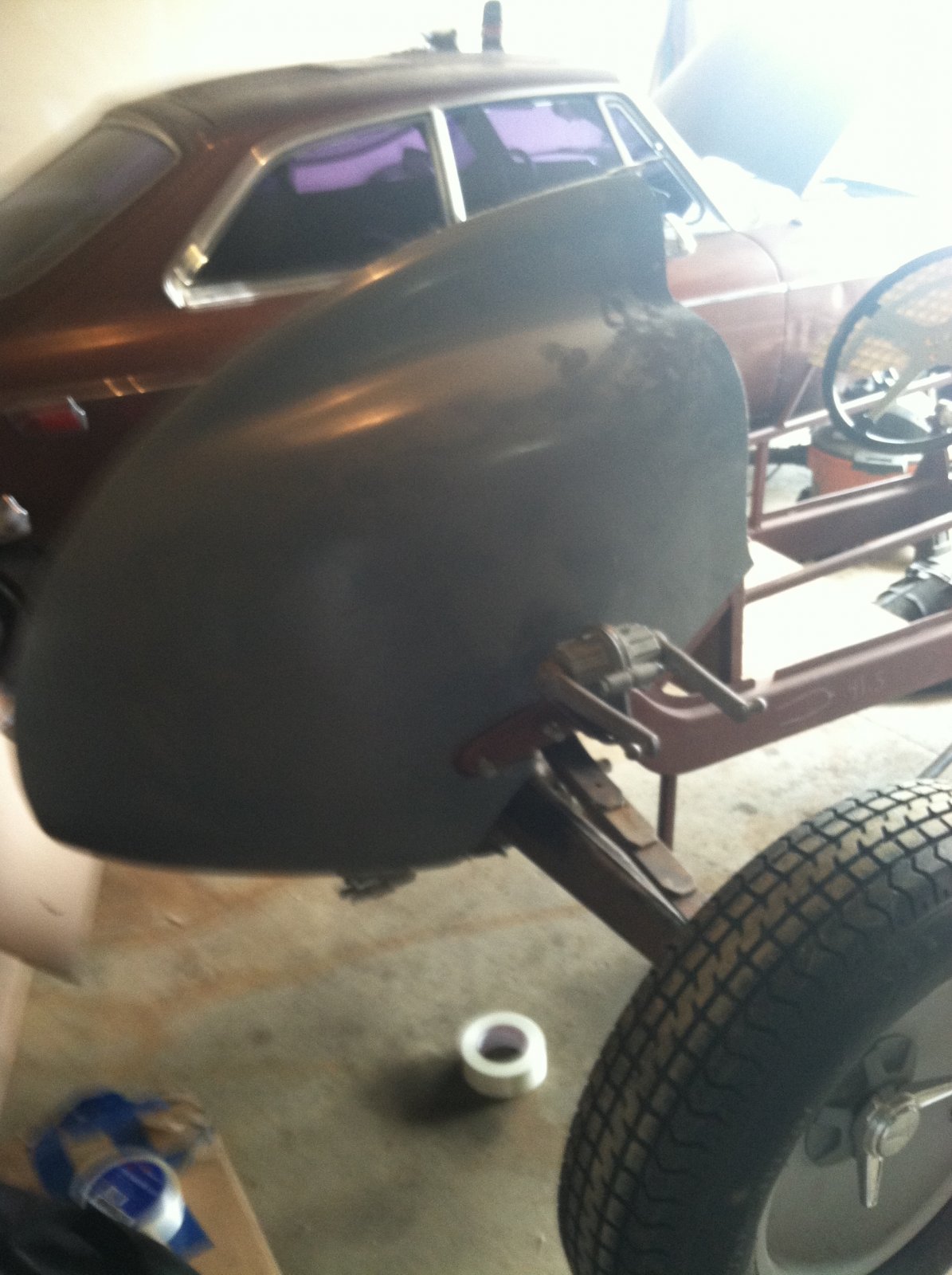

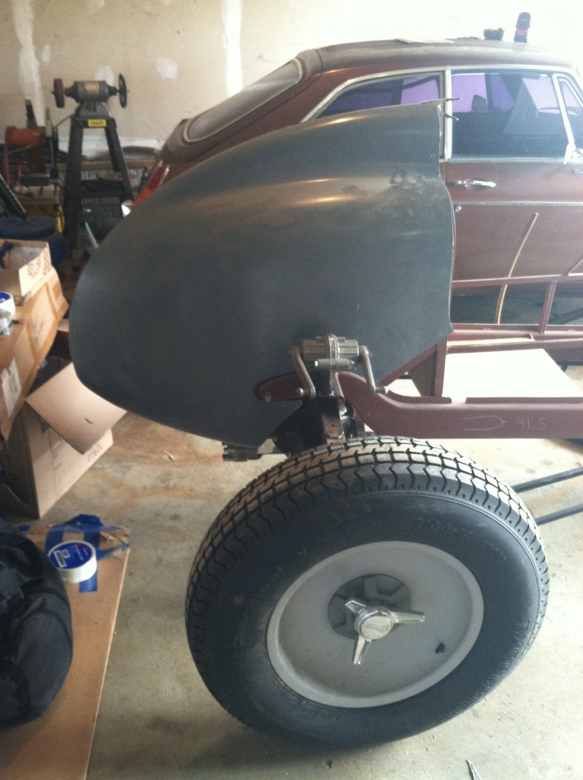

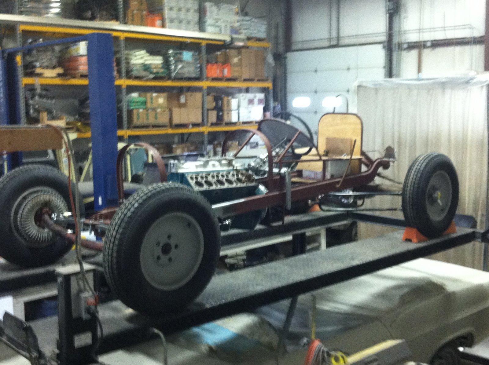

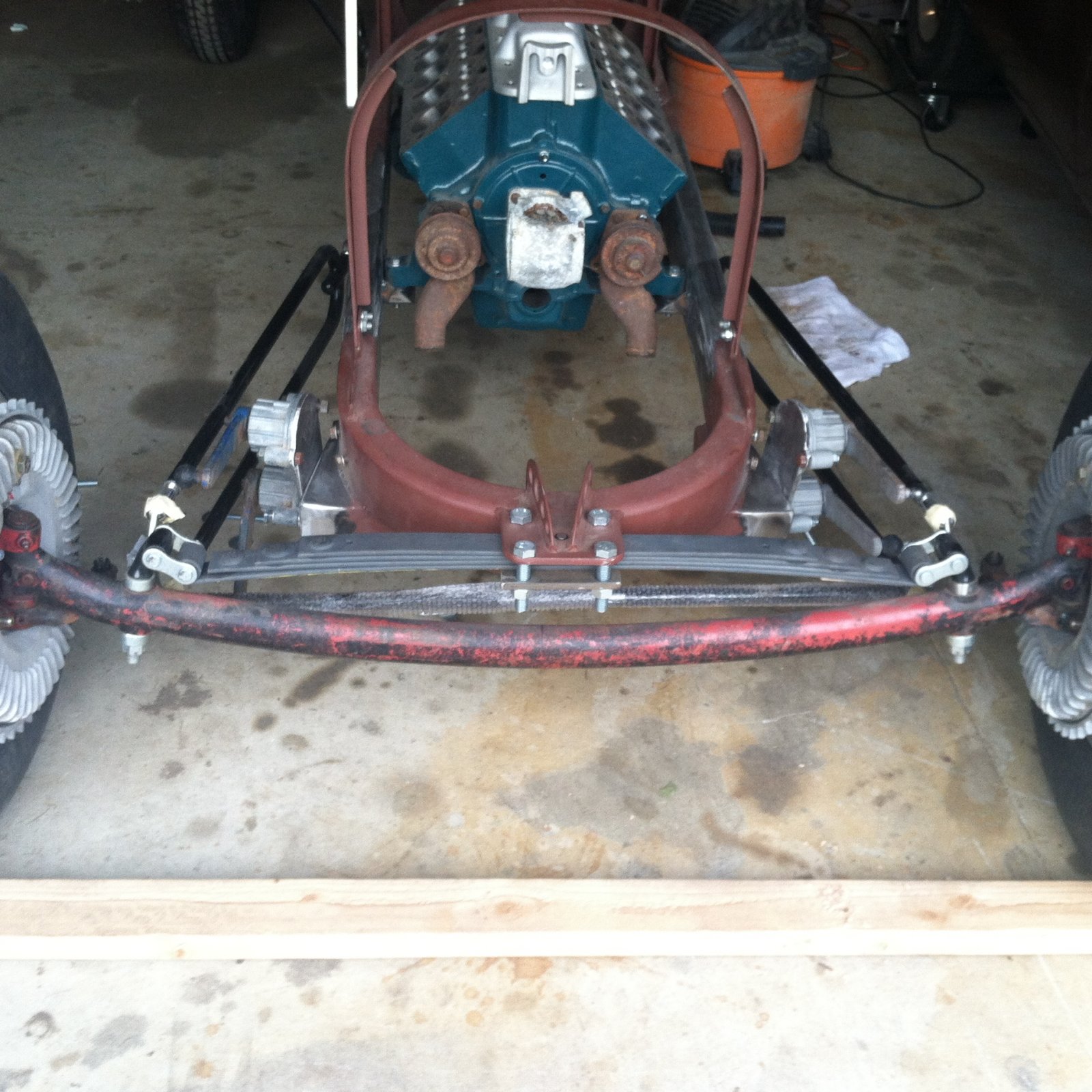

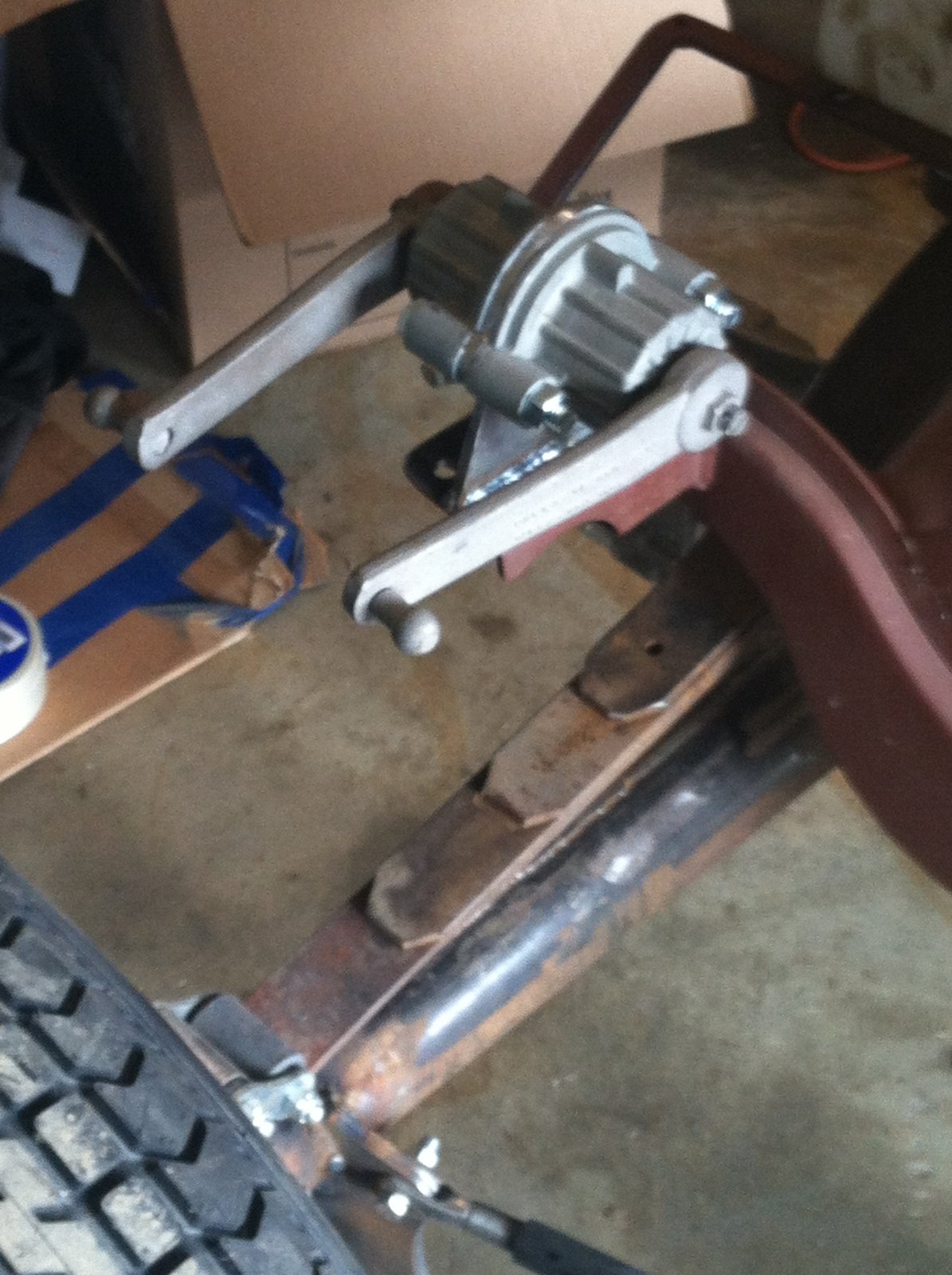

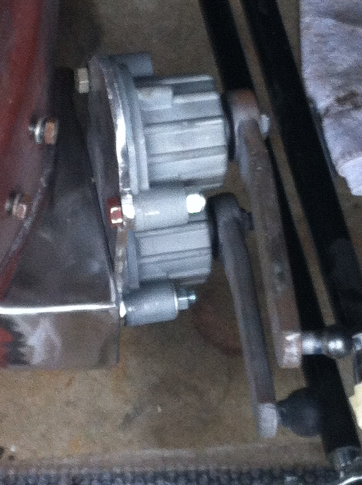

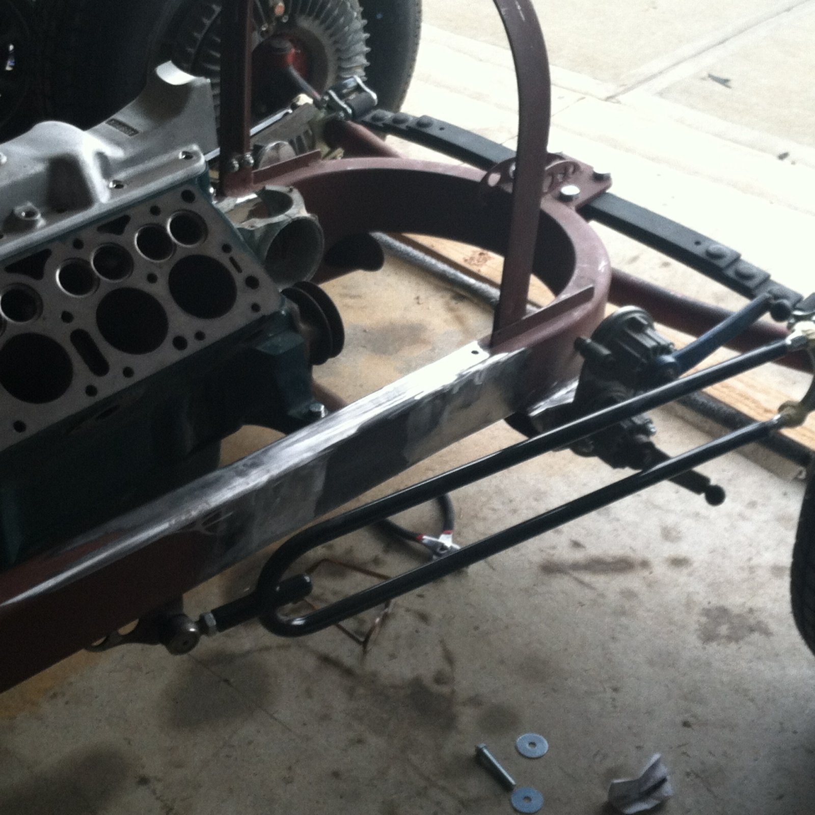

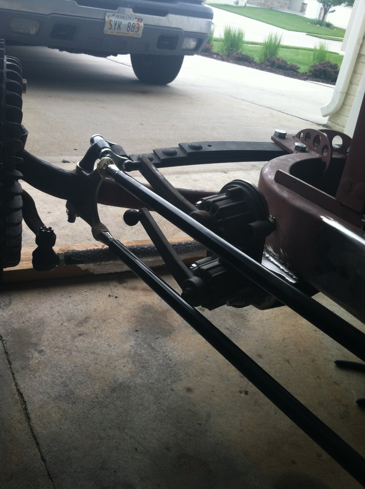

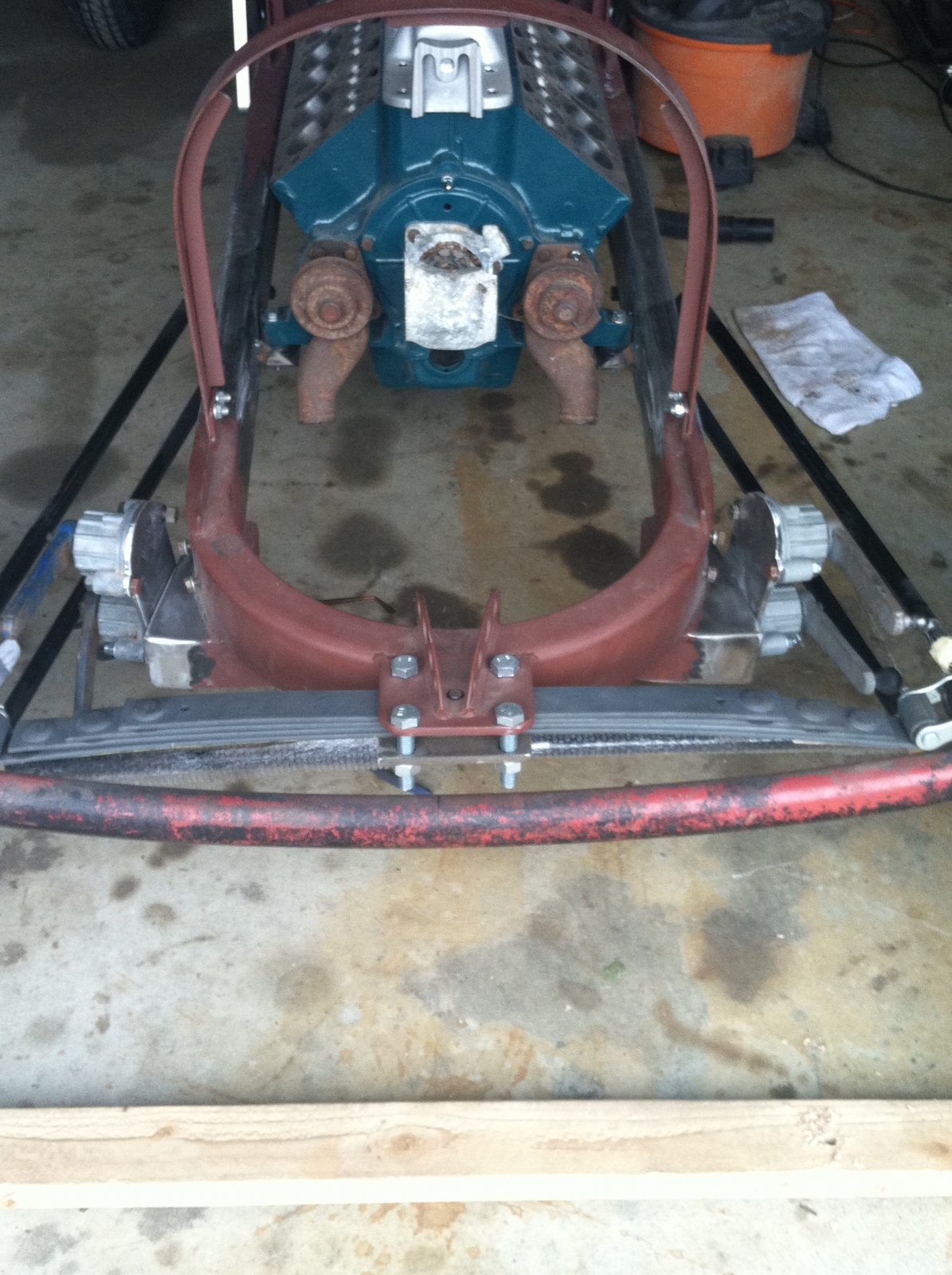

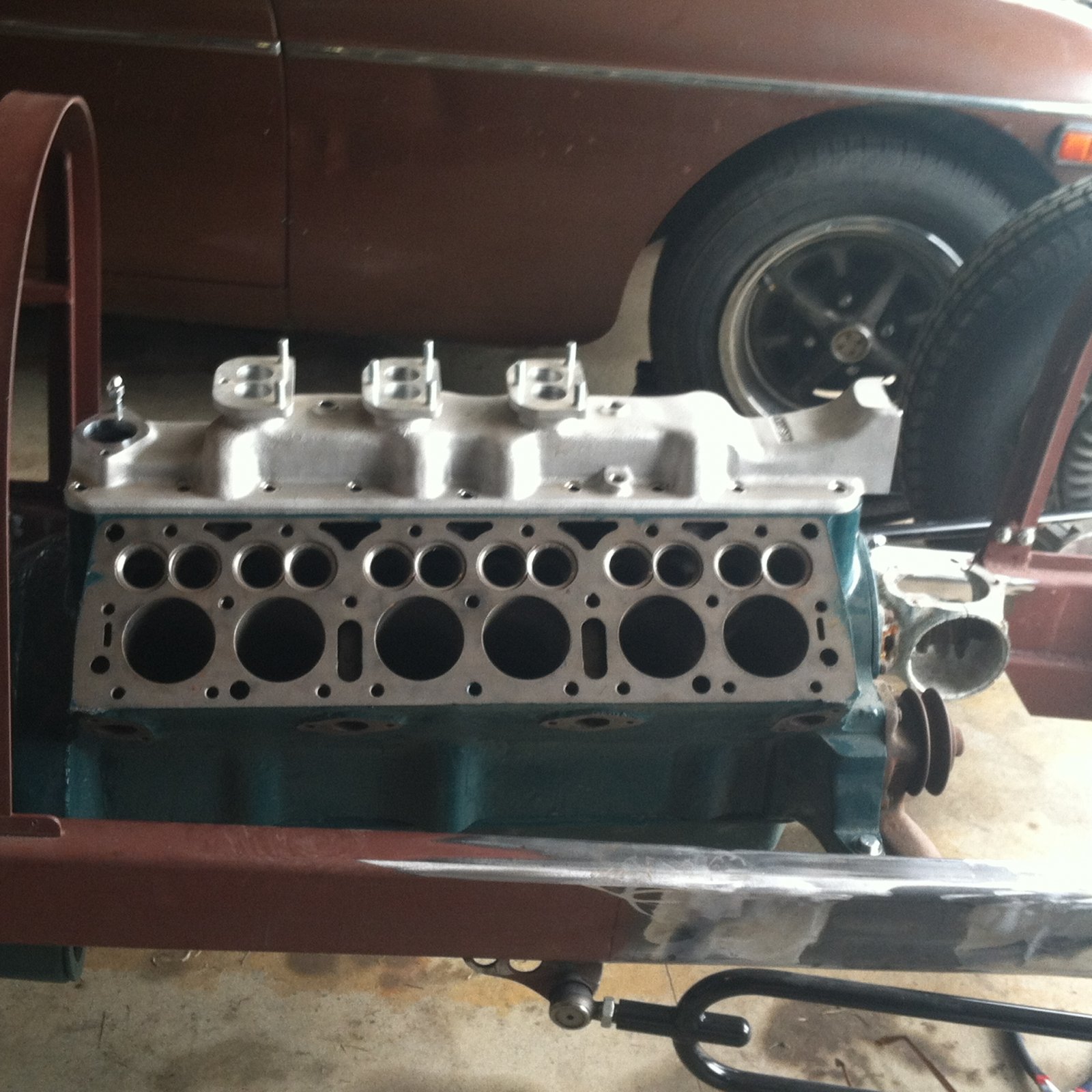

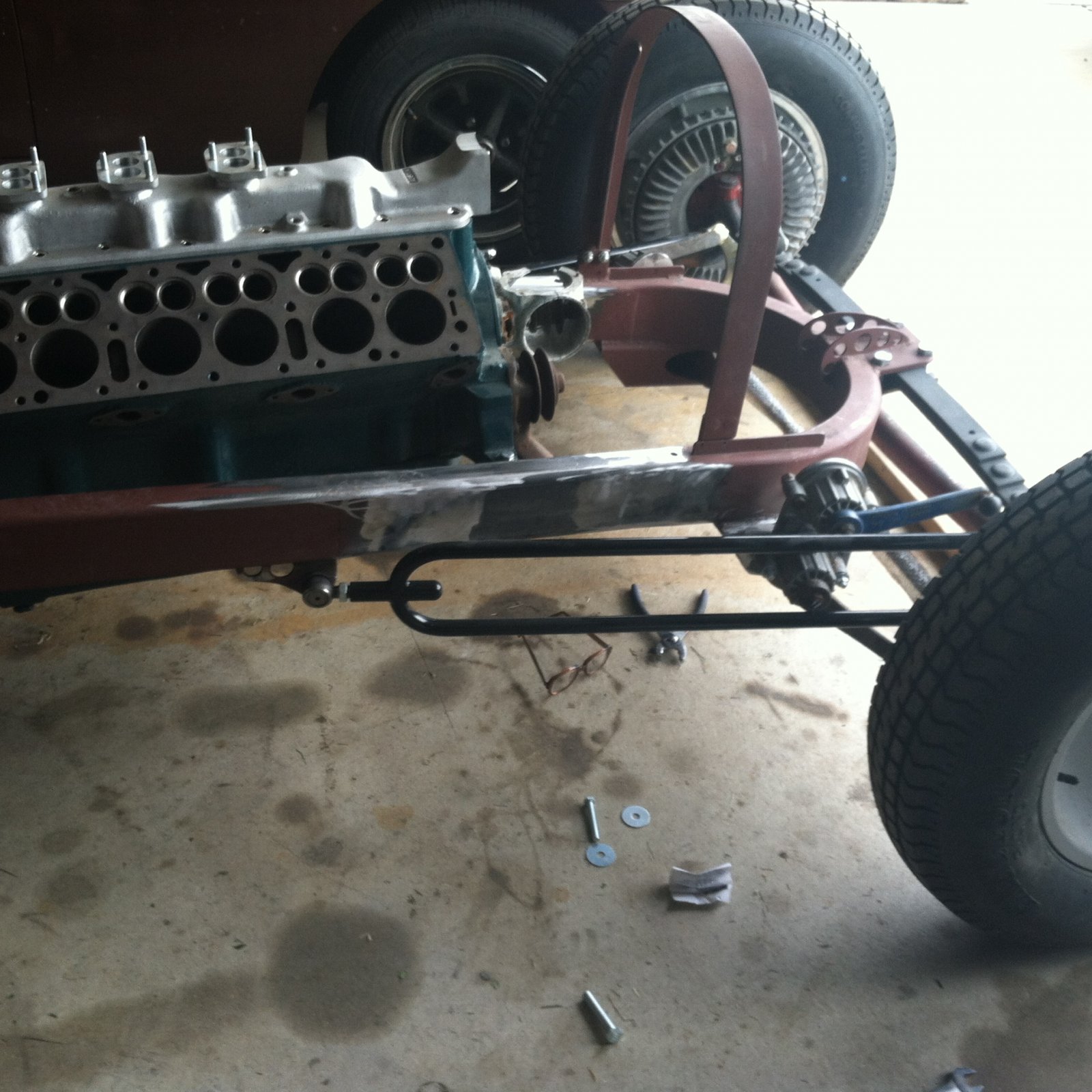

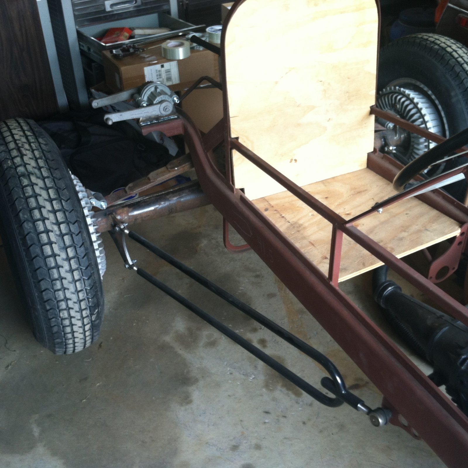

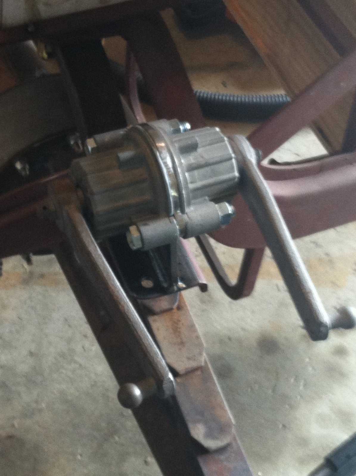

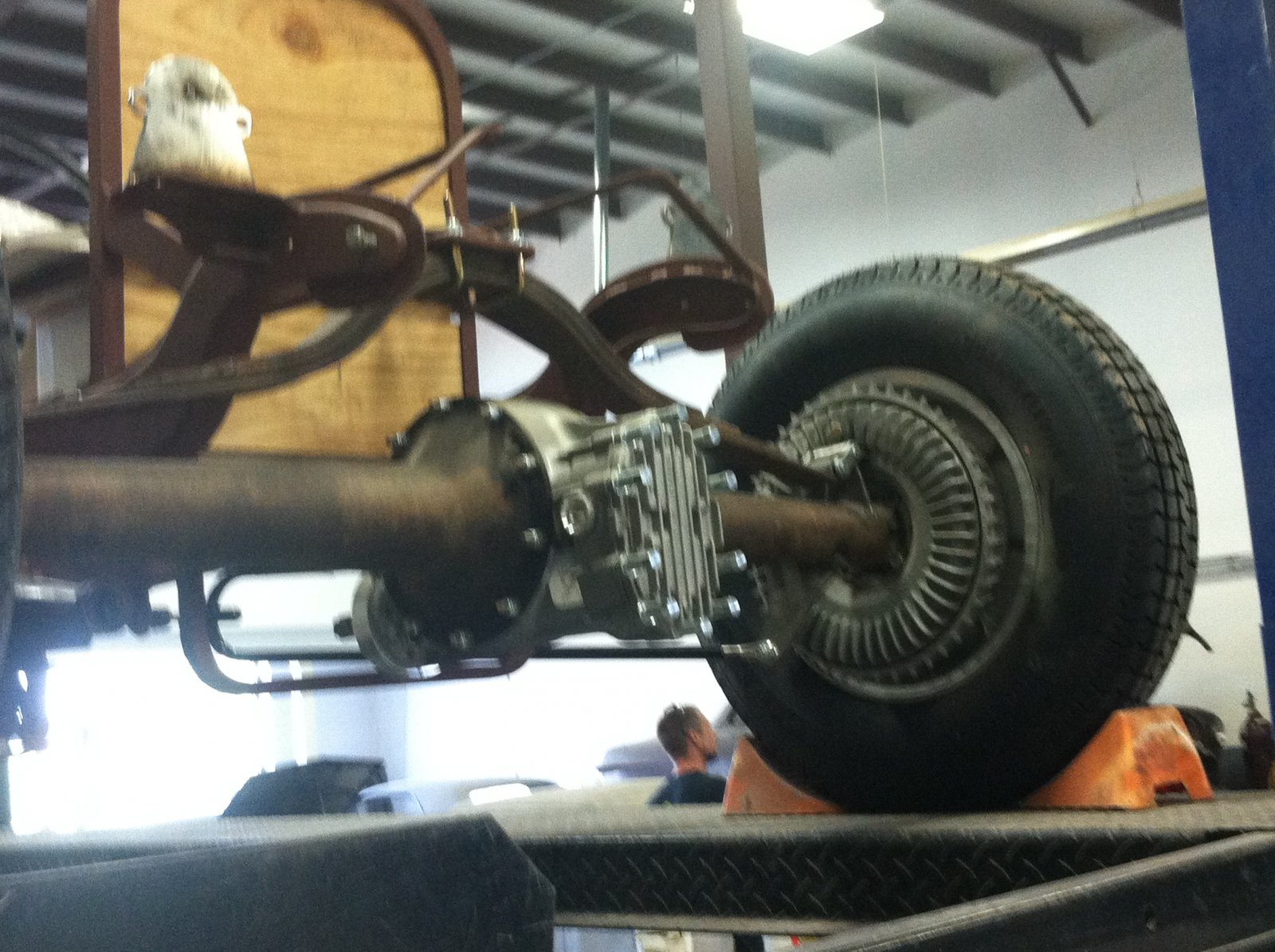

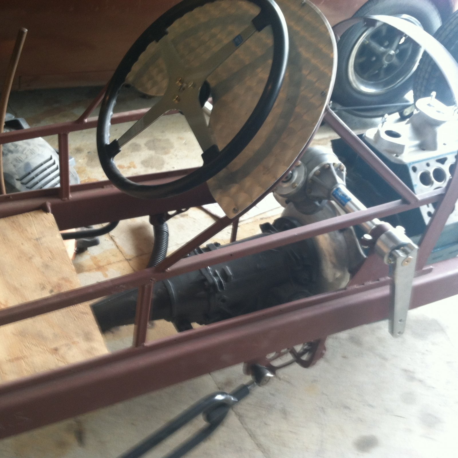

    A little bit of progress.
    IMG_0217.JPG IMG_0219.JPG IMG_0220.JPG IMG_0213.JPG IMG_0214.JPG IMG_0215.JPG IMG_0216.JPG IMG_0241.JPG IMG_0242.JPG IMG_0243.JPG IMG_0244.JPG IMG_0245.JPG IMG_0246.JPG
    catdad49, loudbang, cactus1 and 7 others like this.

    That's going to be a great car. I've been into sprinters, new and old for decades. Man! I can just hear that V-12 screaming off the 4th corner at the dirt mile at the Indy Fairgrounds! Would the rules of that era have allowed that 14" wheelbase extension? Doesn't matter. Great car. That V-12 is cool squared. Carry on and good luck.

    I just stumbled on to this thread, and I'm hooked! Mainly because I have all the makings for a banger version of this: Original aluminum body (tail, cowl and nose with grille), Es*** frame, modified Franklin steering, V8-60 axle, hubs with 16" knockoffs, and an Alexander OHV banger with full oil, front drive pump, mag drive, cut down AR flywheel and ******.
    I needed some info on the body mount skeleton, and your pics are a great help.
    I really like the round frame nose! Did you fab that from rectangular tubing, or flat plate?

    V8 60 tube caught my eye, Bell steering wheel...your choice of wheels/tires is admirable, as the V12 and stretched wheelbase.

    Desmodromic
    Looks to me like there are Heim joints on the ch***is end of the links, with bolts properly supported on top and bottom, in double shear. Heim joints have substantial angular movement capability, well beyond that to which these will be subjected.
  30. dana barlow
    Joined: May 30, 2006
    Posts: 5,436
    dana barlow
    from Miami Fla.
    Your right that a Heim can work some in its angular capability,but it's very poor engineering to use that as main movement. The photo had them wrong,an was only used as a idea of what was going to be done to a cool race car build. Best time to help with ideas,is before hard work is done. Heim's are a bit new for this fun new/old style race car build,but sure looks like it will be fun.
