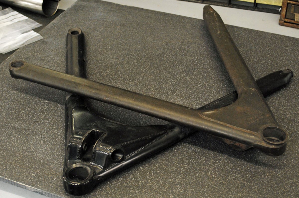

    I would absolutely not characterize the Heim joint orientation to be "very poor engineering". For example, they are almost universally applied this way on the outboard ends of suspension A-arms on sports and formula race cars. A typical 3/8" Heim joint is rated at about 12,000 pounds load, at a misalignment of 22 degrees. I would agree that the offset loading must be considered in the design of the attachment brackets, when applied as shown on the pictured ch***is. It surely makes it easier to get the bolt in.

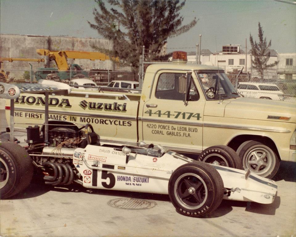

    For others enjoyment an RAREBIKE who was building the vary cool old style sprintcar of this Thread,I'll add a photo of a LOTUS FA that Red an I built from a Lotus F1 tub{ it started life as a F1} for SCCA FA,for David Oxton too drive. f5000smallpic.jpg

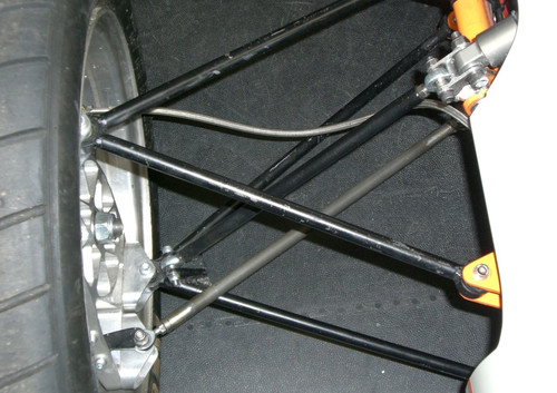

    I admire, and am somewhat envious of, your resume. With me, cars are just an avocation, as I work as a mechanical engineer in the non-automotive field of stress ****ysis of ultra-high pressure/temperature piping systems. I have an interest in hot rods, but primarily sports/formula cars. As my training is technical, I observe and pay attention to the nuances of design in cars of interest. I presently own Formula Fords (Merlyn 11, Autodynamics D9, Lola 202, Van Diemen), Formula C (***an M3), FSV (Lola air-cooled), F2 (Rondel/Motul built by Ron Dennis), FVs (Autodynamics, Bobsy), sports racers (Zink Z4/Alfa, Elva Mk 7 twin cam, Bobsy/Porsche 911 SR3, two Jabro/Saabs, Lotus S2, Can-Am), and a few others. Most are in the "future restoration" category.
    Attached are a few internet downloads which you may find of interest, showing various suspension designs, with Heim joint attachment bolts in the same plane as the principal movement of the links.
