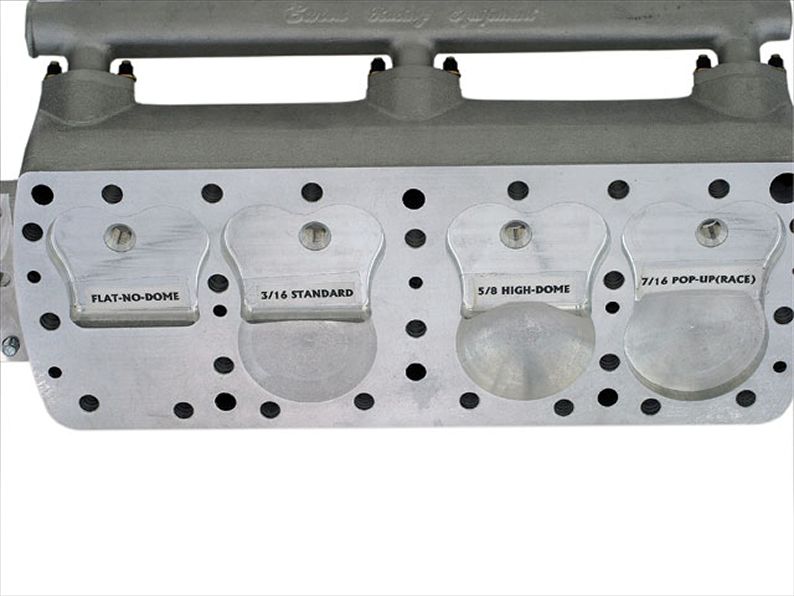

    the fords (and lincoln) run a slight dome on the pistons which i guess is good and current thinking is more is better. The navarro heads use a 5/8" tall dome....but honestly I'm not really sure why use a "dome" meaning radius over say pop-up piston with radiused edges? The indians used a flat piston on standard bikes then a flat 1/8" pop-up on the bonneville versions and the hillclimbers took that to 1/4" or 5/16.....I see 7/16 shown as current technology on the fords.

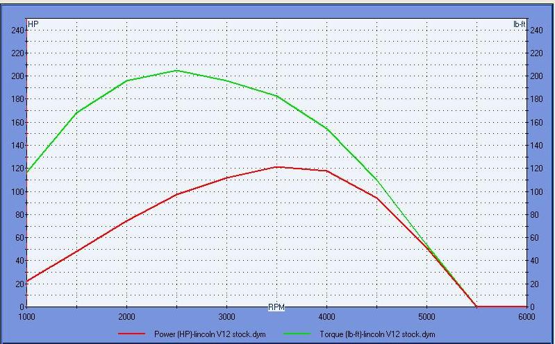

    I got my first book yesterday "flatheadford V8 performance handbook" and it's got some good stuff in it, not as much as I hoped but some good stuff. It does have a lot of flow numbers and the lincoln should be very similar I think.

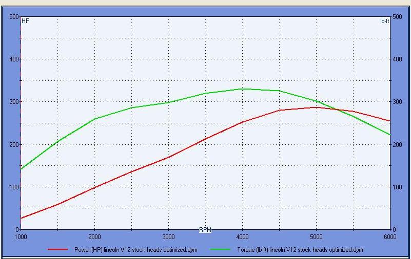

    I took the stock ford flathead flow numbers, my best guess at the stock cam specs and **** and plugged it all into dynomation......122hp.
    So the model looks like it's working pretty good. Now to see what happens when I change stuff :)

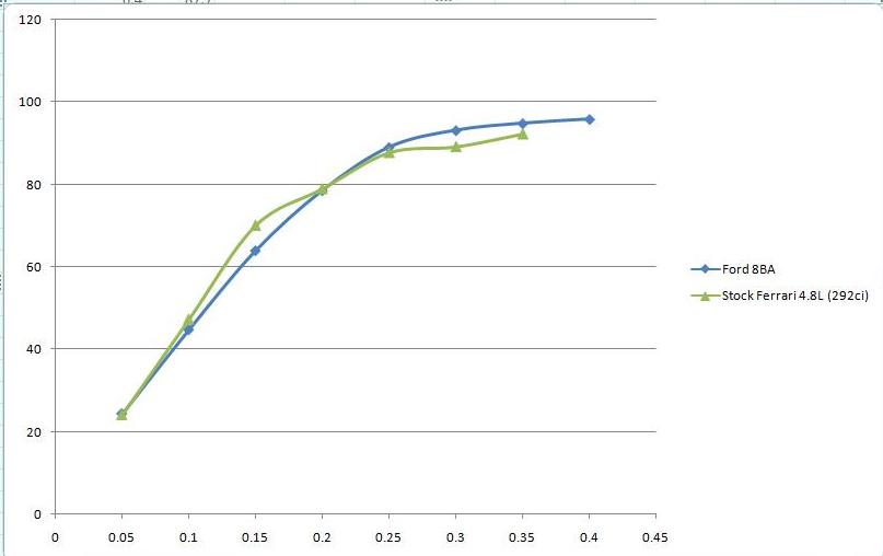

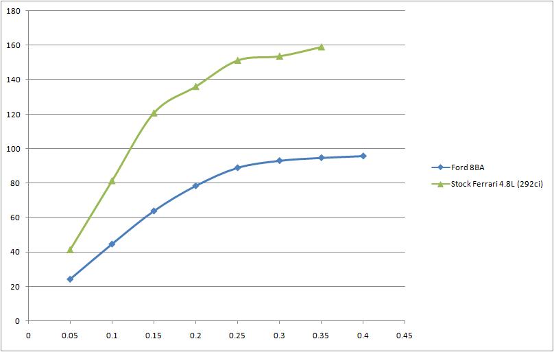

    Here's something kind of interesting, at least to me. I plotted the flow data for the stock ford 8BA against the stock ferrari flow data of a 400i which is a 2 valve per cylinder 292ci V12. Nearly identical!....that ford data actually looks a bit better!
    The stock ferrari makes 340hp with its horrible EPA cams and intake system so it appears the fundamental problem is not the flow in the block/head combination.......hmmmmm

    It looks like it's the bolt-on stuff honestly
    The intake with a single 94 carb is WAY WAY to small. The intake with 3 x 94 carbs is only way too small. Once the cams and exhaust manifolds are replace the hp keeps climbing until the intake flow hits about 4000cfm @ 1.5"Hg
    Way WAY not enough lift in the cams.....
    Way not enough flow in stock exhaust manifold
    with these changes the number is 288hp @ 5000 rpm and 331 ft-lbs 4000 rpm.
    Those are big numbers.
    No boring or stroking or compression increase.
    It's a modern cam grind with about 243 degrees at .050 lift and .440" lift, an intake manifold that will flow 4000cfm and small tube headers with a muffler (big tube headers and no muffler at about 10hp)
    .....hmmmmmm

    wooooops.......my ferrari data was at 10" and the ford at 28" so they are actually nothing alike. I was numbers I recognized and and forgot to look at the most important number :eek:
    I did enter it in the simulation software correctly though so that stuff remains correct I think :)

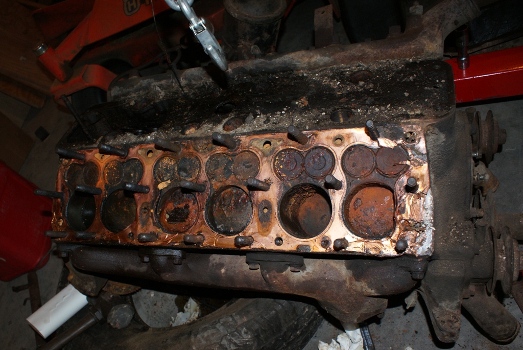

    Head 1 is off! :) ....and I think the only things I broke were my br*** s****ers followed by a lot of damage to my now sad looking steel s****ers that I was able to drive in between the layers of the head gasket then then drive a big screw driver between them and little by little the head came loose. It took about an hour and a half of banging.
    Lana came home just about the time the head was coming off and wondered why exactly the kids and I were in the shop when my job was supposed to be putting them to bed so I had to choose between taking pics and doing what Lana wanted me to do .....Lana is a Sweetheart but she's also Ukrainian, and you just don't mess with Ukrainians! :eek: pics tomorrow I promise :)
    I'm going to have to rummage through the shop and see what I have for ebayable items kicking around.....becasue I didn't tell Lana about the cool new heads I ordered yet either :cool:

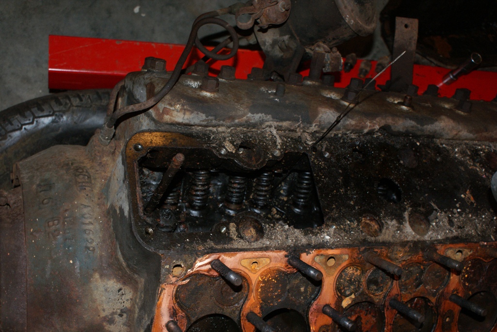

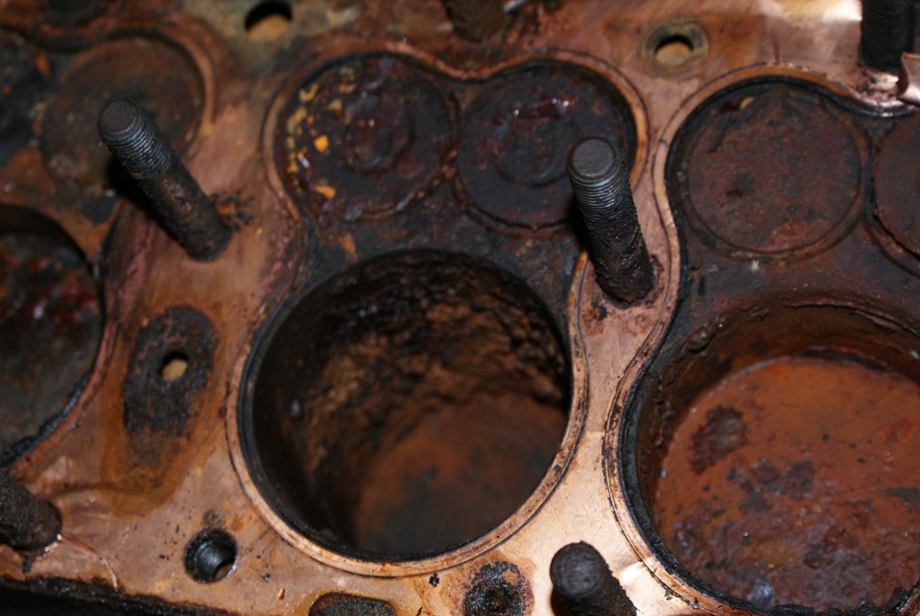

    Here's some pics. Pretty sad inside.......
    I guess the bright side is the bores measure standard so once I cut out the pistons there should be plenty of material to clean them up.

    Head #2 came off much easier and look a a little better inside. I think all the oily goo in the valley and on the crank probably help rptect those parts....hardly any rust on that stuff. The rust in the cylinders seems to mostly s****e right off so I'm hoping things are not as bad as they look.
