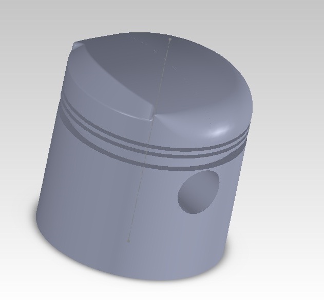

    Here's where my brain is headed on the piston......I guess I really need to draw up the cylinder and head so it's a little more clear what this shape does exactly.

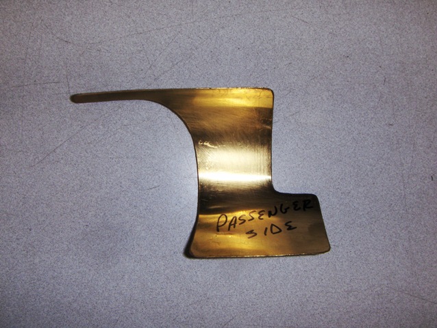

    I have installed a pair of these water pump deflectors made of br*** in the block cavity directly behind the water pump to help the water flow toward the back of the two cylinders the furthest from the pumps # 11 and 12. Prior to installing these deflectors the water pump impellers would rush water directly behing the water pump block cavity and not having enough volume to help the water flow to the two rear cylinders. So by adding these two deflectors it is helping the cooling.
    Thanks

    Frenchy, are those something you made up or did you find them somewhere?

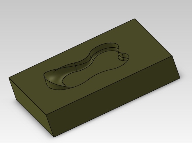

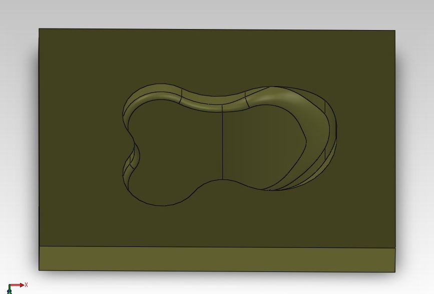

    I've been playing a little with what maybe could be done piston/chamber wise and very honestly it's hurting my brain a bit. Here's a couple screen shots that show what I was talking about when I said the head could be built up to make it drop into the cylinder a bit to help the air make the turn down into the cylinder.
    I still show a sharp edge that would obviously need to go away and it doesn't quite match the piston I showed earlier (which needs to change to match the head)....but this is what I'm thinking concept wise.....very open and smooth through the center flow area.
    I may do a little more filling to start the turn down a little more toward the valve side of the piston. I only play solid modeling about 1 week a year these days so I'm slow and it takes me a bit to figure out how to make it draw what's in my head......I'll keep playing.
  14. Frenchy Dehoux
    Joined: Mar 30, 2006
    Posts: 968
    Frenchy Dehoux
    They use to sell them back a few years ago. But if you need a pair I'll send you a pair at no charge let me know. E mail me your address.

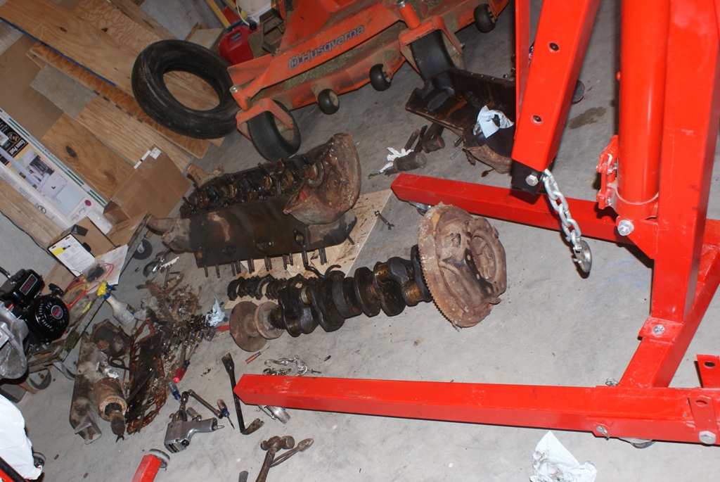

    The oil pump is out thanks to my 3ft crescent wrench. I guess the issue was it is seized so it had to be rotated out.
    With the oil pump out of the way I could finally pull the crank.....that thing is frikin HEAVY! I after a couple "how am I going to grap this thing and not hurt myself" attempts it finally occurred to me that I wasn't and really needed the crane. Now I have to figure out how to get it into the press to get the flywheel and balancer off.
    Normally I like the tear-down part......but this is not a fun tear-down so far. Everything is either stuck, covered with waxy/oil gick, too heavy to lift or in the case of the crank all of the above.
    I guess figuring out how to get the pistons out will be next.....I'm not looking forward to that.
